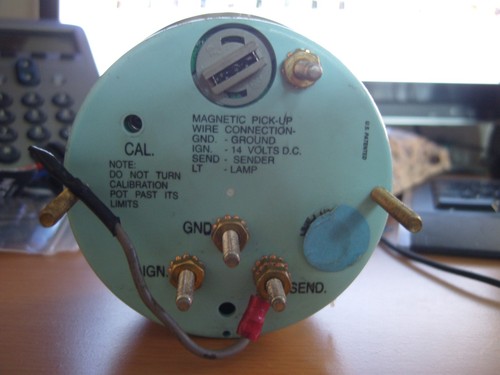

Re: Diesel tachometer
I have this lying about if you can drive it somehow. I used to drive it from the fins on the flywheel. (28 teeth compared to the 30 that its looking for)
A proximity sensor will acomplish that easily.
Forgot the bloody link!
http://www.ebay.co.uk/itm/171114230020? ... 1560.l2649
For when that ebay add is gone forever......... here is the infoalexanderfoti wrote:I have this lying about if you can drive it somehow. I used to drive it from the fins on the flywheel. (28 teeth compared to the 30 that its looking for)
... link!
Teleflex Marine Diesel Tachometer
0-4000RPM
Designed to use a 30tooth magnetic pickup.
Backlit and integrated hour meter (currently reading 54)
