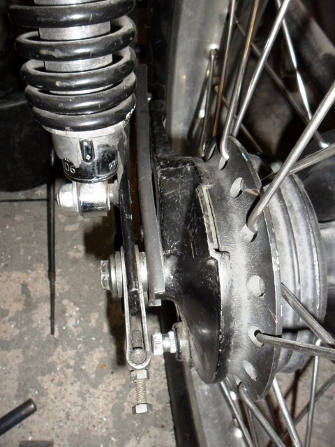

the rear brake fixation rod turned out be sitting too loose around the rear fork.
therefore decided to go in the more original way, like a Jawa normally has its rear brake ankered.
rear brake anker
rear brake anker
rear brake
rear brake
the chain tensioners are kept original.
and the koni spring adjuster. damper adjuster is on top of the spring.

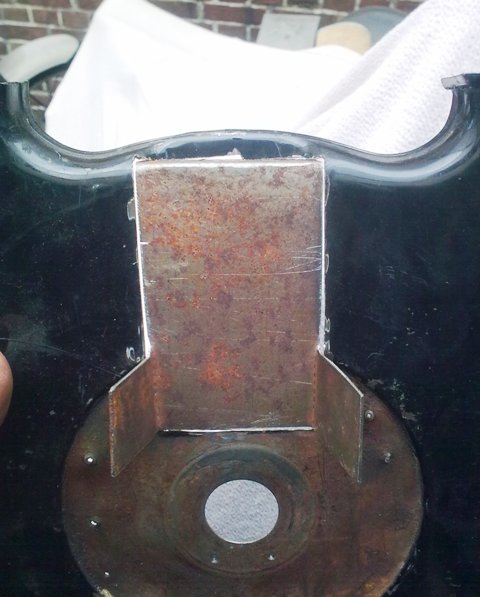

with the help of a paper template, cutted out a new piece of sheetmetal.
kettingkast nieuw
kettingkast nieuw
mark the gap is evenly all around, ready to fill with tag welds.

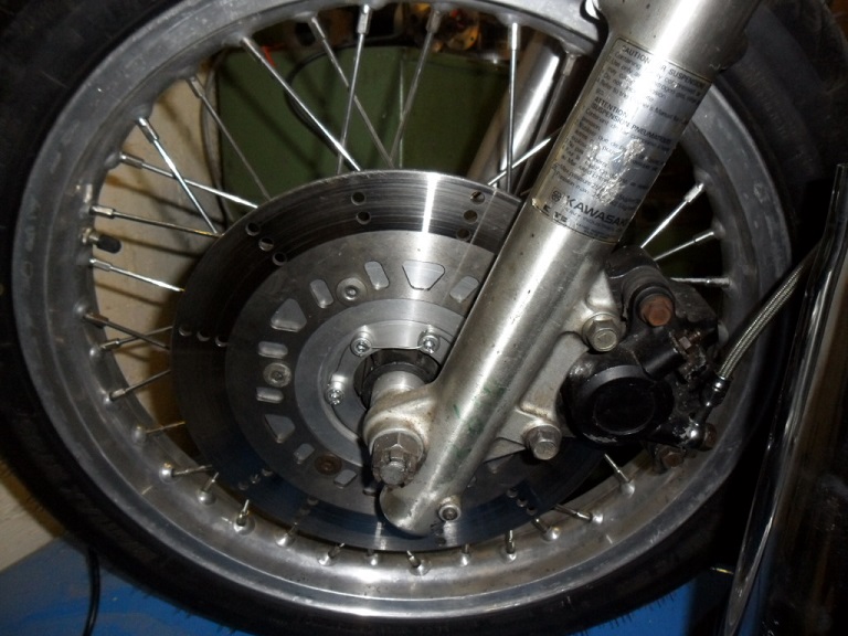

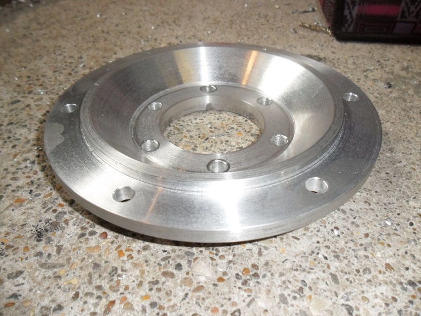

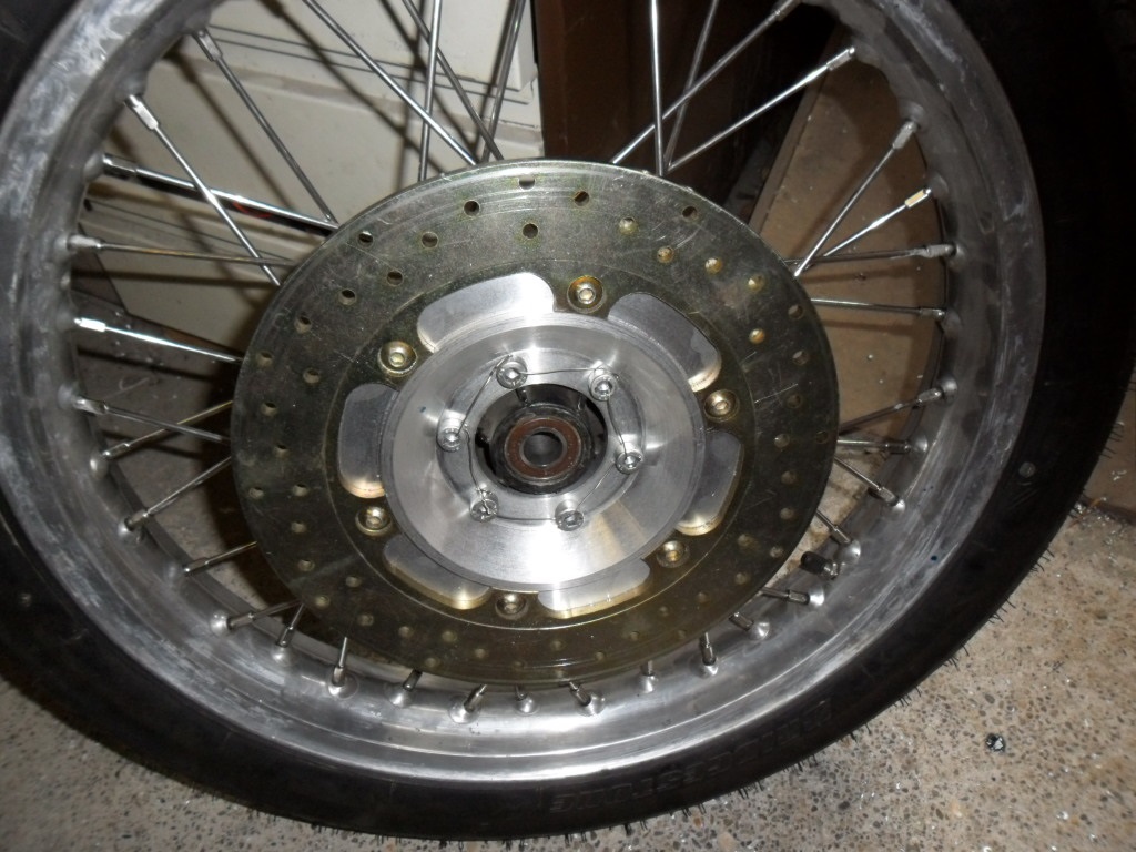

Here is another new sophisticated piece of VVM work, the (6*** aluminium) front brake disc spacer;
from scratch on the laith
set, shiny and done
This bike woulndt be worth the 'racing' in VVM if it would never see a circuit, better be well prepared;
and finally, the overal front-end;

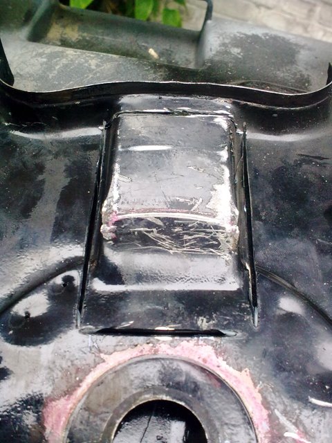

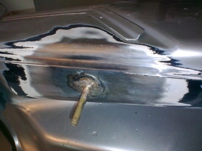

It appears that a diesel engine dictates the need for a separate dieselpump overflow fuel line, in order to keep the pump from surging (leading to inconsistant idling/running of the engine).
Jeroen (from VVM) soddered a brass 6mm (about 1/4'' O.D.) line, that practically runs to the top of the tank.

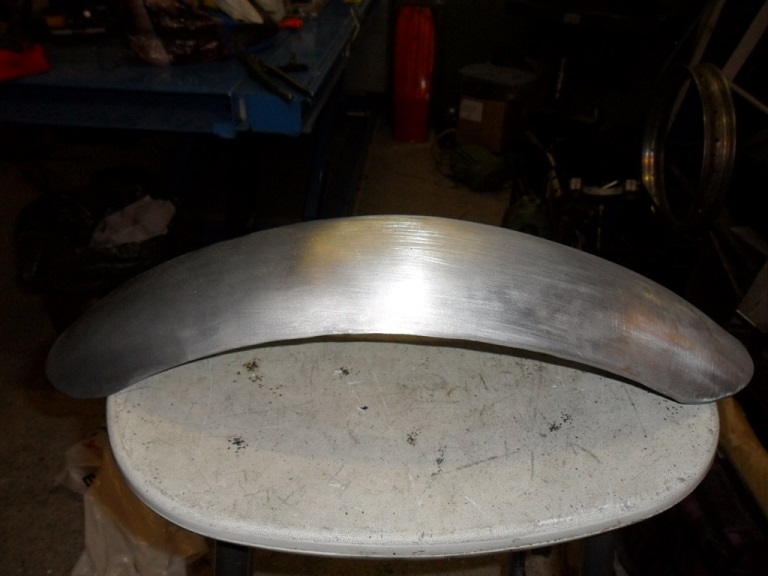

in the meanwhile i've painted it again, and we are now working on the front fender.
Jeroen has hand beaten/rolled one out of aluminium (or 'aluminum' as they say in the united states of 'bankrupcy').
to be continued.

alexanderfoti wrote:Looks good. I had the same problem with mine, I ended up running the injector leak off back to the fuel supply line with a T
we wanted to do this as well, since the tank was already painted.
however with a T, you could run the risk of getting the mentioned surge, air bubbles that circulate through this by-pass all the time.
so we did it properly just to be ahead of this possible issue.

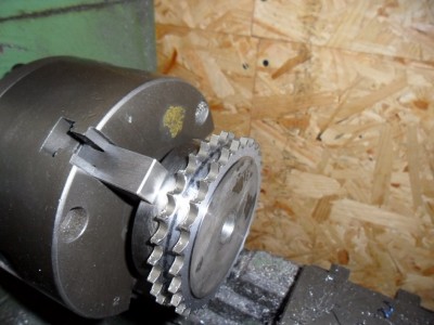

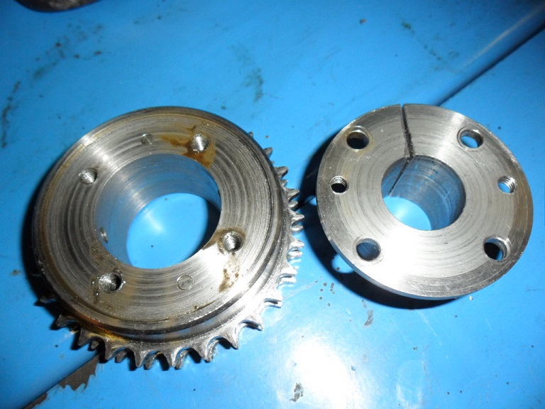

Here we see the primary chainwheel being reworked to fit on the diesel crank;
and the primary duplex chain fitted on the bike;
as the chain is now longer, Jeroen made it by joining two original jawa chains.

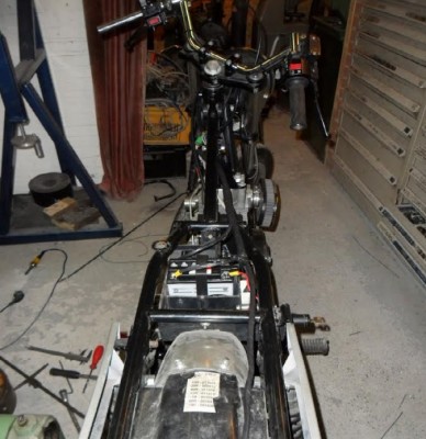

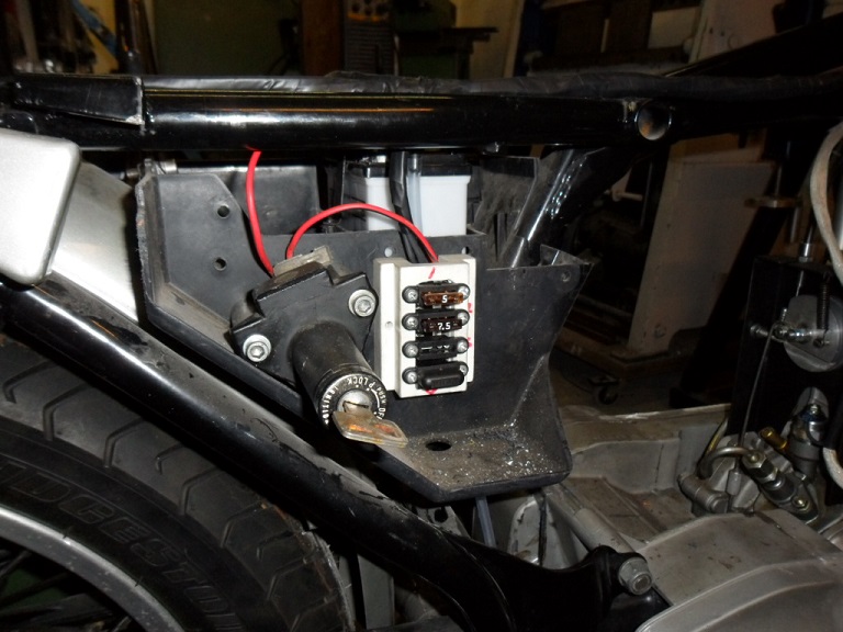

Here we see a glimp of the revised electrical system, whereas Jeroen made a whole new ''cable tree''
The battery still sits in its original housing.
And the side view upon the delrin fusebox that Jeroen made.
He has divided the electrical system into four as displayed.

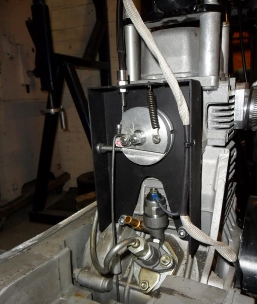

And here we have the revised throttle system, because we added the shut-off solenoid later on.

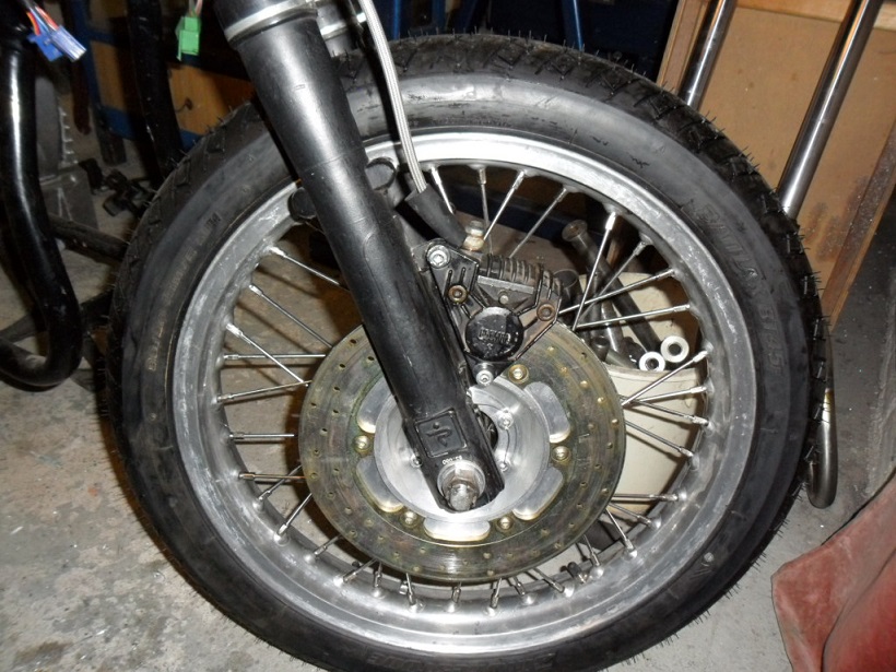

A kawasaki kz750 fork was fitted for it has an offset front axle. Yokes are still paoili, however Jeroen reworked the holes from 35 to 36 mm in diameter.
Caliper of this fork replaced the brembo, and the guzzi disk was changed for a gsx1100 disk which is now on the other side. Brakes well and linear. Pump's still brembo.

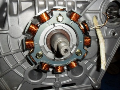

Than there's the dynamo/stator of the dieselengine, for we've let the flywheel be as is on the new engine (need the starter teeth). We know u guys have little issues with the stationairy character of it, in combination with a vario, but the Jawa VVM doesn't have a vario.
So Jeroen rewound the copper spools (increasing the amount) and it now always charges the 14 ah battery. Obviously the battery is now more important for us then it used to be. And alot bigger too.

last but not least, the hand beaten and hand rolled aluminium front fender made by Jeroen (VVM) as well, check it out;

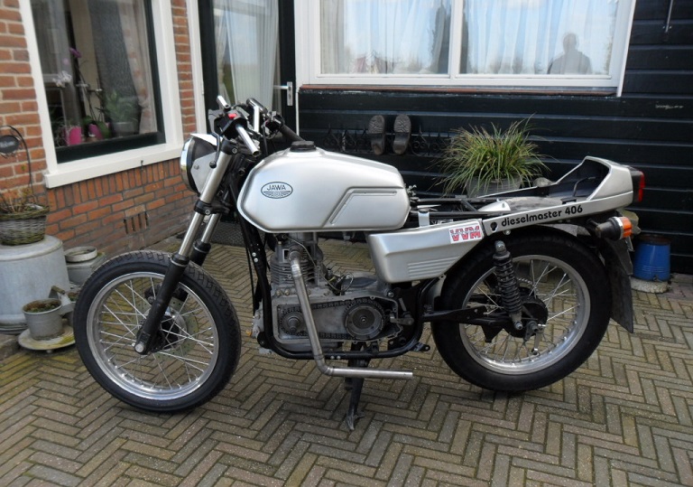

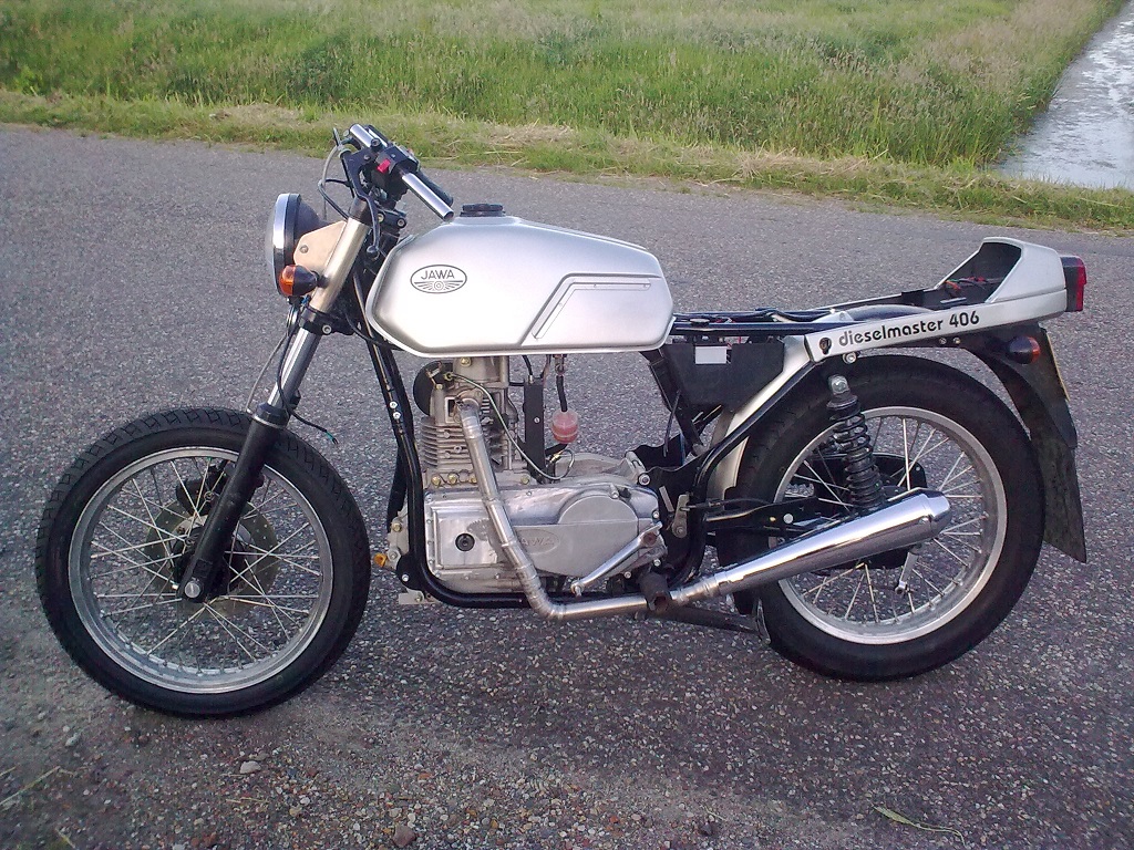

Today we finished the bike, ready for the state roadtraffic test.
proud owner;
while driving i realized what 'the big knock' means.
this really is 'big knocking'. 'turns more heads then a harley'
greetings fellow bigknockers.
