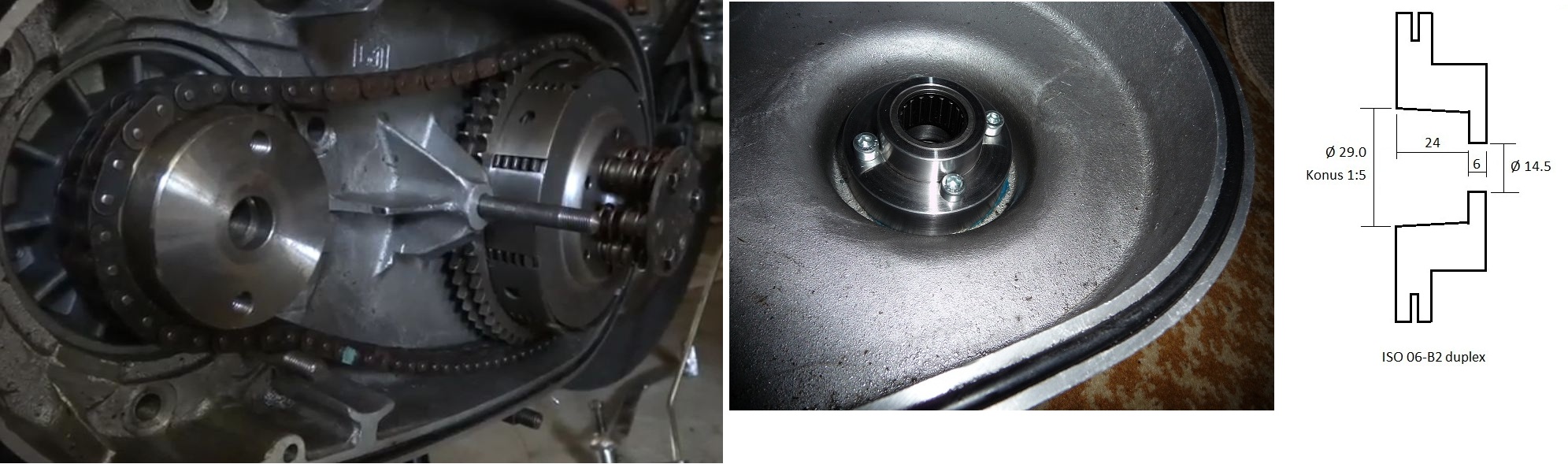

Hi,
My first Enfield diesel build was with an Yanmar L100 engine, https://www.dieselbikeforum.com/view ... =31&t=1957 , and it was finished by 90% when I found an 2 cylinder 654 cc 16 HP Ruggerini MD151 engine at a quite well known auction site. You all properly know the "must-have" feeling, so I won the auction
It was in good condition, "just" the piston rings needed to be renewed
Nowadays it is the same engine as Kohler/Lombardini 25LD330-2 and it is a 650 cc version of the 850 cc version Ruggerini MD191/Lombardini 25LD425-2.
These engines have the same mountplate shape at the output shaft as the the original Enfield Taurus 6LD325 engine, so it fits nicely to the Taurus inner primary chain case.
That is, no need for an adapter plate between engine and inner primary chain case WHEN using the long Enfield gearbox diesel mainshaft version !
The big challenge is always to align the engine to clutch and to achieve adequate "round-the-engine" clearence.
The following pictures show my mounting fixtures between engine and gearbox, engine and downtube, enginehead and frame..

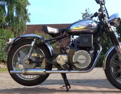

Good news,
My Enfield build with Ruggerini MD151 runs nicely - now breaking in the engine, so I do not pull above 90 kmh
Compared to my earlier Yanmar L100 build, the MD151 pulls quite better off.
The well known 3-4 gap in the standard Enfield gearbox isnt an issue anymore, revs easily up to 80 kmh in 3rd.
The engine runs pulls ok from 50 kmh in 4th @ 21 teeth gearbox sprocket.

Hi Erik
I looked at your shots of the bike on youtube..looks and sounds good..wondered about the shot of the speedo...am I going to get more performance than I am expecting? or is it a slightly optimistic speedo? Mildly concerned as I have an identical bit of kit in a box waiting to fit!

Hi,
The speedo is approx. 12 % optimistic. I am using a 21 teeth gearbox sprocket, which should give approx 108 kmh topspeed, see table below.
The engine doesnt fire optimal at one of the cylinders, so when it is fixed, I presume it will pull to full rev with a 22 teeth gearbox sprocket.

I wanted a better clutch support bearing than the HP bush bearing due to the engines 32 Nm torque.
I tried the bush bearing in my Yanmar build, it went hot and the bronze bush crashed the alu bearing housing !
Here is the bearing housing sketch with an oil seal 20x32x7. For now I have added a HP oil seal on the outside of the chain case !.
The 4 holes need to be drilled for the Allen screws to fit the Taurus inner chain case bush bearing mounting threads.
Link to roller bearing data: http://www.consbrgs.com/details/224/224_1_18.html
