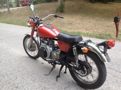

My name is Bob Harvey from KC. This is the Red Devil. It started out as a 1970 Honda CB350 and a Yanmar L100. Primary is an 18 pitch 2" industrial belt and pulley. The clutch is wet/dry, kinda. Installed a 17 amp Sportster alternator under the flywheel, plenty of electricity for anything. More details about the build will be forth coming. Suffice it to say; So far on surface streets it does a solid 50 mph. It is loud, smelly, slow and totally cool. Surprisingly it vibrates very little. It needs a reliable fuel shutoff/idle mechanism. Rear shocks suck.

Welcome & thanks for sharing you build details Bob :-)
Re: The Red Devil from Kansas City
What gearbox/drivetrain are you using with this?

Updates? I see the turbo thread, but as for the build thread.....What transmission did you use?
All nicely detailed on his webpage.
