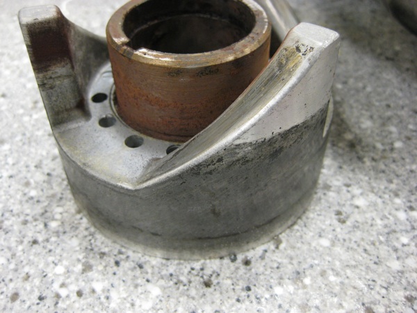

You can't turn the secondary around it won't work unless they make a reverse helix. Most units have the spring and helix on the inside but not all. Flipping the primary should be doable. The problem I see with moving the primary is supporting the shaft as it cannot pass through the clutch. So the trick will be getting the bearings far enought apart on your primary shaft to stop twisting of the bearing mounts.

Yeppers, aware of this, but thanks for bringing it up.DieselFly wrote: Flipping the primary should be doable. The problem I see ...is.. shaft cannot pass through the clutch. So the trick will be getting the bearings far enought apart on your primary shaft to stop twisting of the mounting
DAMN., was afraid of that. Luckly Polaris; which Im learning toward, has the helix in the form of a cup that is inserted into the secondary. Thus it is possible to get that coppied by a machine shop but with the ramps in opposit direction. BUT... cost...... grrrrrrr.DieselFly wrote:You can't turn the secondary around it won't work unless they make a reverse helix. Most units have the spring and helix on the inside but not all.

Problems with helix solved by this?
Have started a thread on Tigertriple.com on topic of flipping wheel The experts on Tigers hang out there. They'll pipe in there and comment on how possible or impossible this would be.
Re: More compact mounting of CVT
Ding? Course another option that might work is put engine in to where flywheel is on bikes right side and keep OEM chain drive on the left. Jackshaft's put the CVT clutches out of harms way, and more compactly width wise by flipping them inside outward putting them under seat as described earlier, yet keep output on leftside like normal. Seems that would have the CVT arrangement facing in typical fashion thus solving helix issue.... but maybe Im missing something like:
. would that make full time reverse motion bike?? My calculations say it would, but Im hoping one of you correct my calculations proving me wrong
. would it solve helix issue or am I pictureing it wrong?
Might be less fabrication overall if it would work. Then still only doing engine and CVT mount fabrication and not adding to it flipping wheel fabbing and all that involves (moving rear brake master cylinder for one; and remounting rear brake caliper for two, according to TigerTriple (follow link posted earlier)
