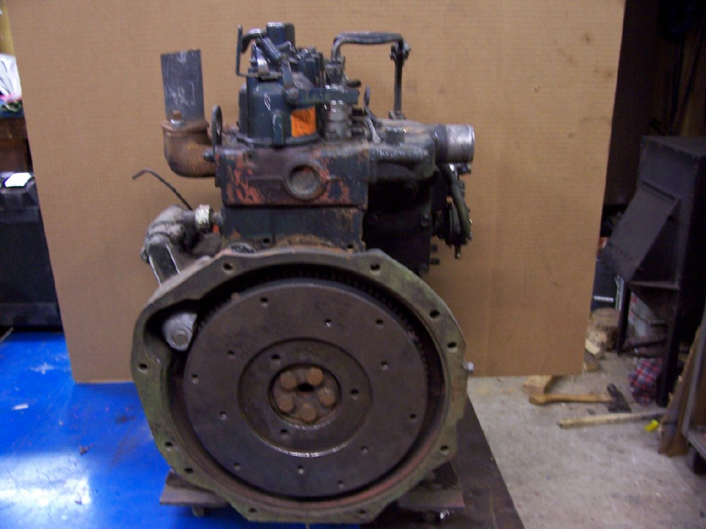

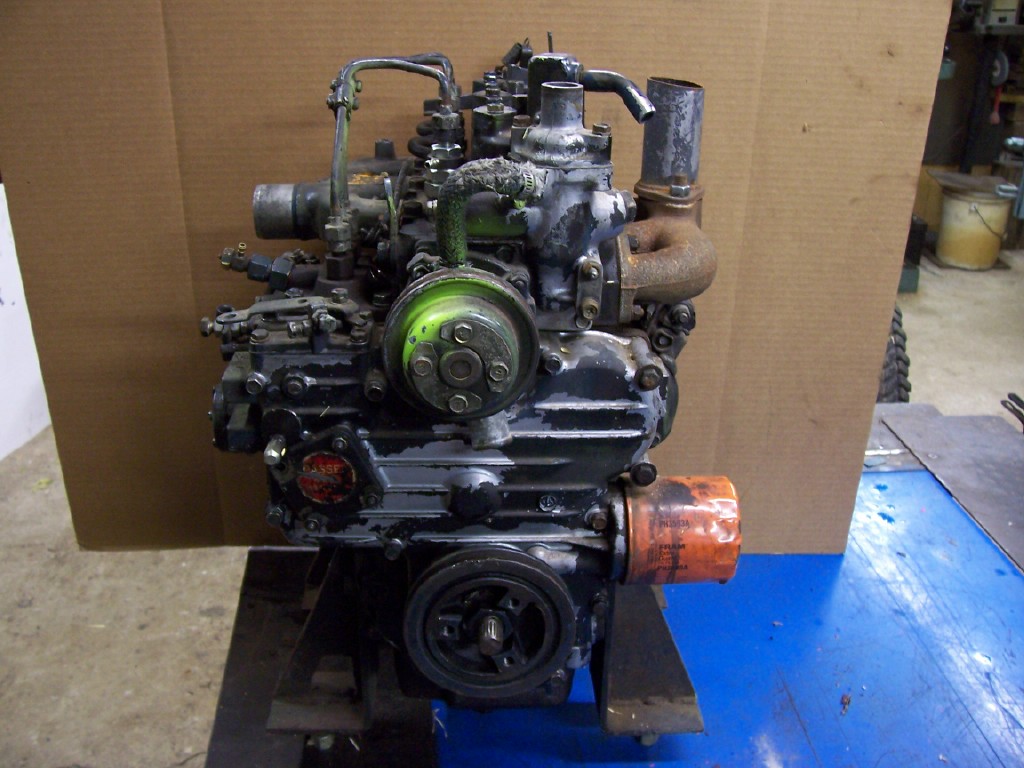

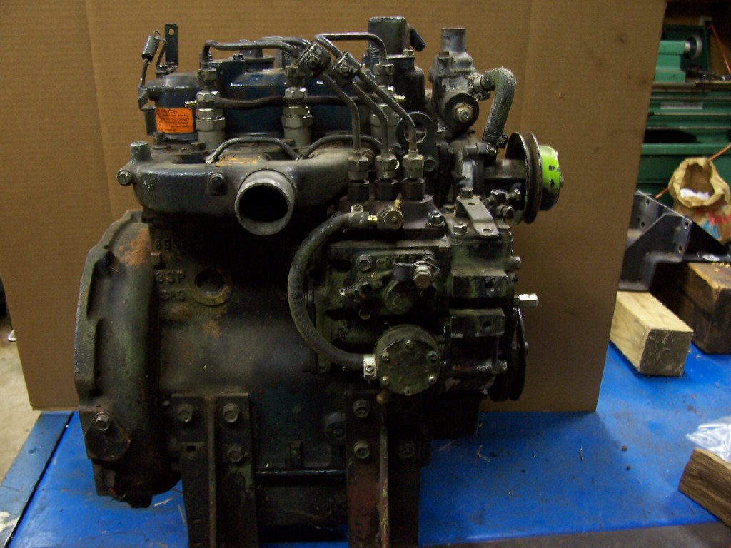

I have run into a fellow that is into garden tractor pulling. He's knowledgeable on building up Kubota engines. He's got a few rebuilt for sale.
Model 850 3cyl 23hp peak, 21 constant in stock form. 700 bucks
Model 850 (same engine) + High performance IP tunable to 30hp and up to in the 60's. but it is thousand dollars more

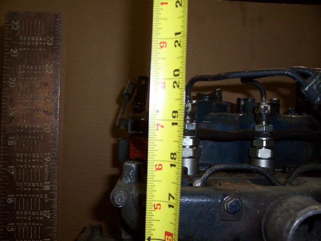

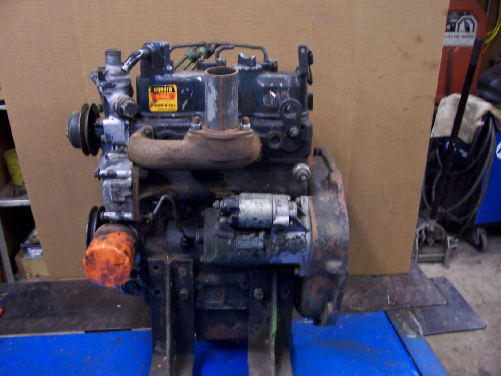

Well I'm going to go with this Kubota with the larger IP. Just seems it is checking the right boxes to work for this project; including that it is IDI which fits my veg oil fuel goals better than the DI Briggs.
It's a HUGE gamble in my life situation to take this on. Damn diesel bug is going to get me in trouble.
Re: kubota... to be or not to be
rest of pics
ok so I lied... this one is the last of the pics
