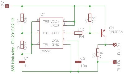

It is a small piece of electronics blinker relay that resides in each end of the handlebar.: ( click the image to see details

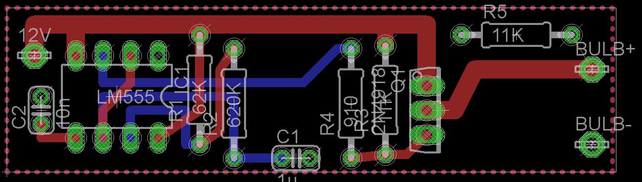

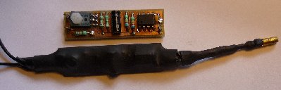

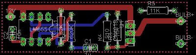

PCB lay-out is here, created with Eagle from cadsoft.de. Ground plane isnt shown: The PCB assembly looks like this, along with a version packaged in shrink flex:
