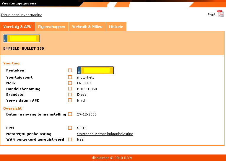

Ah well, all in good time It seems that the guys at the Dutch Road Authority changed my registration already

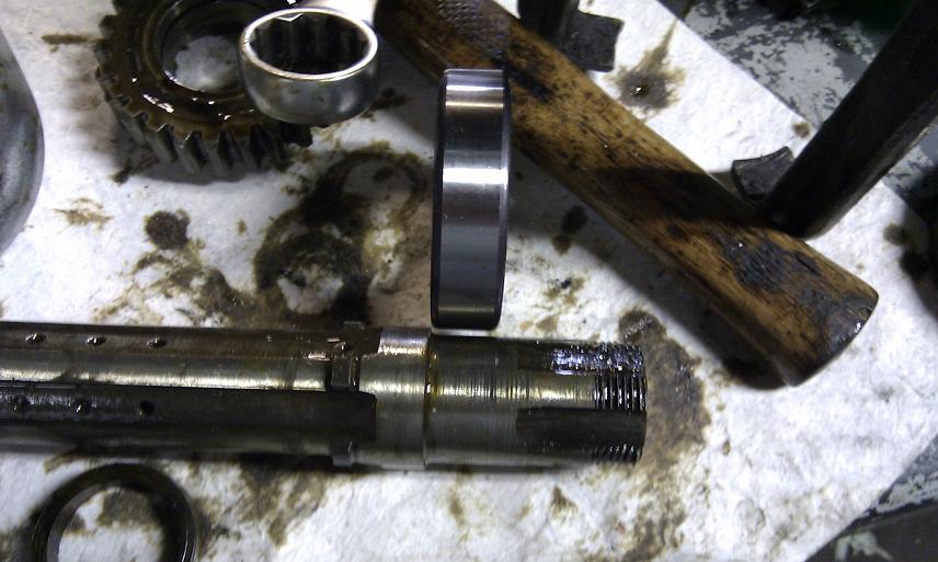

Alrighty then. It's been too long. Today I had some time to work on the bike again. There's some issues with the throttle, but nothing that can't be fixed. The engine mod has been undone (RIP) and it is now stock, except for the part where it will happily rev at 4400 rpm. So the solution needs to include a max rpm stop.
It was time to upgrade the bearings in the gearbox. The stock bearings made faint grinding noises, probably due to metal grit. The replacements are closed bearings. Anyway, pics!
Patient on the table. Gutted... Gear operator and an oil seal hiding inside, attempting to look innocent. The smell emanating from your monitor is indeed elephant sh*t. One bearing in, the other waiting in its box for the "skilled" mechanic to fit it in place of its Indian cousin. Much to my surprise, my 1992 Bullet was already fitted with an improved main shaft sleeve. Reassembly tomorrow.

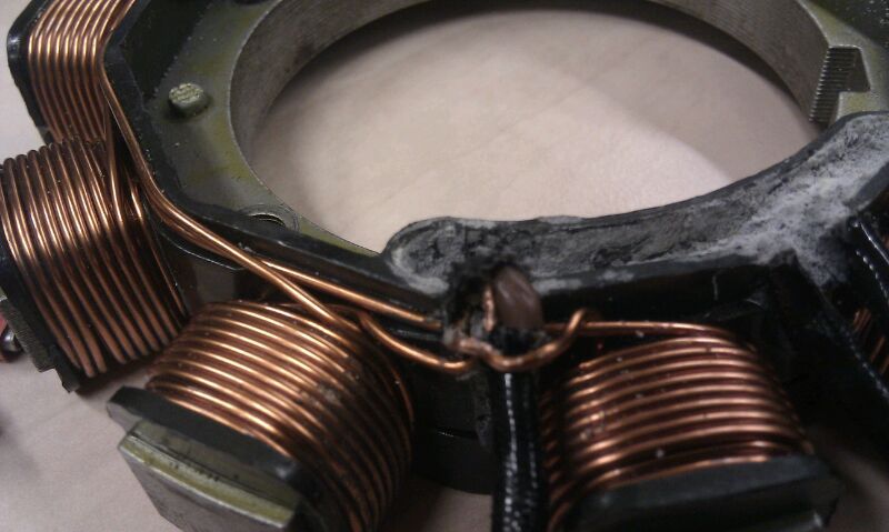

I had a small rattling problem with the Enfield that required removing the flywheel. After I found some loose metal causing mishap I also noticed the stator was stuk between a rotor and a hard place
Some surgery was required... sorry for the crappy pic.
The finished product, measuring ~1Ohm on the leads. Hope it works!
Just top it off with some goo of Het Gele Merk (it's like Sicaflex)
And finally a regulator from Hatz. According to the paper that comes with it they also make a DUCATI version. I suppose that is intended for turbodiesel 1B40s

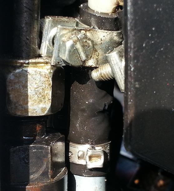

Just stopped at a traffic light close to home and noticed my left foot was slipping off the peg. I feared a primary case leak, but unfortunately there is diesel ALL OVER EVERYTHING. I have taken some pictures, I will upload them shortly, but there is a nice puddle on the rim of the back wheel as well. Blargh. Very bad timing.

Oh dear, that could have been dangerous! Where is the leak from, its hard to tell from the pictures.
Re: Hatz Enfield build
I haven't had time to take a peek yet, hopefully this weekend. Preferably a stretch of fuel line, but that would not be in accordance with my luck.
Hopefully its nothing major, doesn't look it.
Healthy dose of brake cleaner will sort that out
Welp. No brake cleaner was necessary, it squirts right out really. Unfortunately it is in a piece of Hatz hose and not in a piece of hose I put it. It has an annoying little clamp at the bottom, so I can't replace it atm. I do have some ABA clamps, but they are twice as high (see one in the pic for reference). I suppose I mounted it all under too much strain and in the end it ruptured.

That's bad luck with the hose, hopefully you can get it fixed soon with a better hose and reusable clip.
