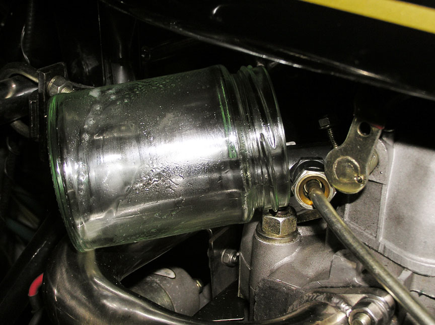

After checking the condition of the injector tip and seeing if the four offset 'microscopic' :!: injector nozzles aren't obviously blocked! it was time to see if any fuel is getting to the injector and check the spray pattern.
The pipe coupling is tightened to hand tight, plus around a quarter of a turn 'nipping up' with the spanner - that should prevent leaking. Then reconnect the rubber fuel return pipe from the side of the injector, after removing the bolt.
In the glass Jar you should have four fine spray patterns, and no leaks at the pipe coupling end! This is a high pressure system, so you have to be a little bit careful about high pressure fuel, and take precautions.

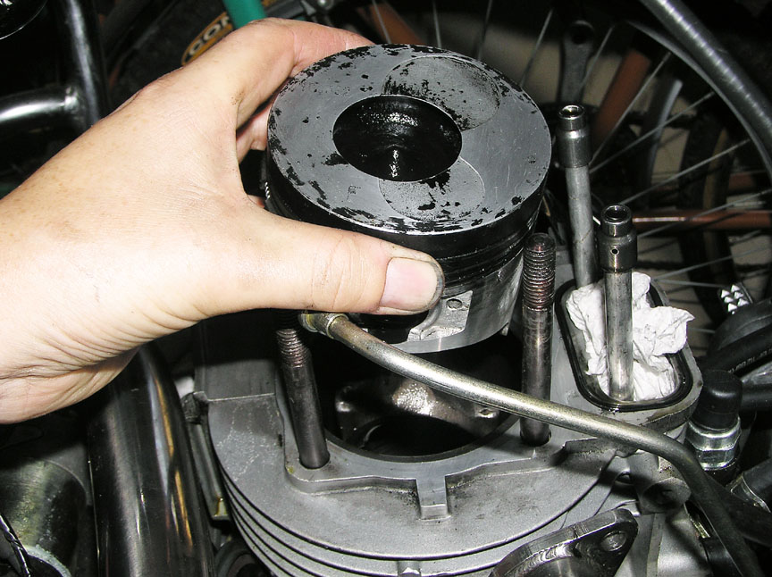

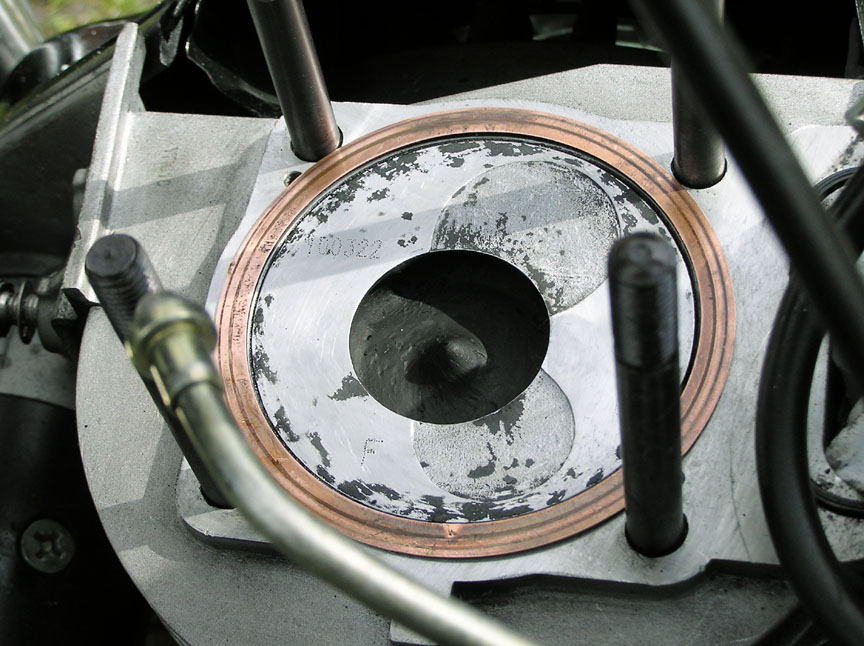

Eventually I got around to cleaning out the carbon in the combustion recess, and foolishly I thought that it looked like the piston rings weren't gummed up!
Also can be noticed the piston identification number, and the 'F' for correct piston location, which always faces the primary drive output side.
Next, I have to replace the copper head gasket with a new one, put a very thin smear of head gasket silicone sealing compound over the blended imperfection area, and put the cylinder head back on.

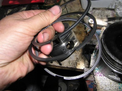

Thinking that I had done enough, I tightened the four cylinder head bolts up diagonally in two stages. Finally torque loaded up to 40 ft lbs.
Then I was time to refit/reconnect everything else, adjust the tappets/valve clearances to 0.15mm/50 thou inch gap at piston TDC, also marked as a 0 on the top of the flywheel/cooling fan assembly.
At last everything was back together again, only to find that the compression was a bit better, but the engine still didn't start! :( I have to get really serious with the engine now, as I found that there was also an oil leak from the bottom of the crankcase gasket, when I tried to start the engine, so it looks like the gasket has also blown!

Hello Coach, the black rough looking 'moonscape' as you put it! is due to the irregular build up of carbon, due to incomplete fuel combustion in the combustion recess in the piston head.
It took me about a hour to carefully scrape the majority of the crud out, and also using some fine emery paper, to get the finish back nearer to the original smooth cast alloy profile, with a smoother cone shape in the middle for the fuel swirling process.
What the piston design needs is a less or different heat conducting metal insert, such as stainless steel in the combustion recess, and a glow plug fitted to the cylinder head to give more complete fuel combustion of alternative fuels. Unfortunately diesel engine manufacturers can't be bothered/or it's not in their interests to do so.
The injector is set into the cylinder head at an angle of about 30 degrees approx. from vertical, and it looks like with the 4 spray injector pattern, each hits a different side of the cup and cone, in the piston crown.

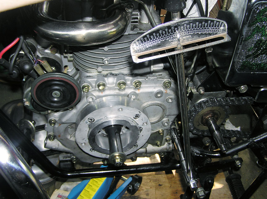

Now the engine is locked in place the engine shaft bolt can be undone, and a 13 mm socket fits, and the bolt unscrews anticlockwise. The spring washer and penny washer can now be removed, and the old Loctite thread adhesive can be scraped off. The engine output shaft has a welded woodruff type locating key in position, so don't bother trying to get it off! Lucky for me that I have an old impact driver with hardened steel bits, and a hex headed one that fitted perfectly!
The two sprocket securing grubscrews are a bit stiff, but are fairly easily removed with the impact driver.

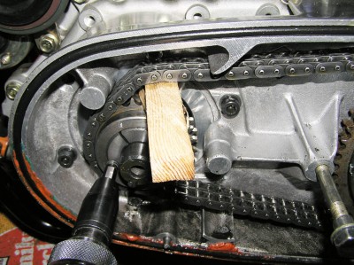

The clutch centre and assembly is held on with a large securing nut and circlip. After locking the clutch sprocket assembly in place with the brake bar, and then removing the large securing nut, I preferred to leave the circlip in position, and take it off later.
A clutch centre extractor (PED2005) using the original three clutch spring pin bolts, and brake bar (PED2025) or equivalent, makes the clutch sprocket removal relatively easy.
I jammed the brake bar against the rear brake pedal, which made things easier when removing the clutch, and freed up one hand.

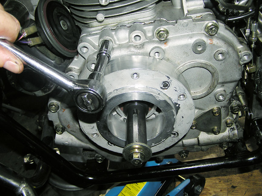

At last I'm just left with the inner chaincase, which just has a few securing bolts and a plate to remove - we're almost at the engine now!
There's just four allen bolts and a inner chaincase flange plate assembly with a metal bush insert to remove - the flange plate is secured with 4 hex head bolts.
The four allen bolts are removed first with the impact driver and hex bit, some of them are quite stiff to move. Also noticed was an oil leak from the crankcase rubber oil seal. Part of the oil seal lip wasn't in contact with the driveshaft properly, and the oil seal had appeared to be 'blown', as indicated.
Next was to remove the four chaincase flange securing bolts with a 10mm socket and ratchet wrench. You have to be careful removing the flange assembly here, as there is a paper gasket behind and a rubber oil seal also in the assembly. Both can be easily damaged during flange removal.
Now we can use a little bit of controlled "brute force" on the chaincase! with a metal bar. This is to break the seal caused by the original thin layer of silicone gasket jointing sealant used between the chaincase and the large drive shaft adaptor collar.

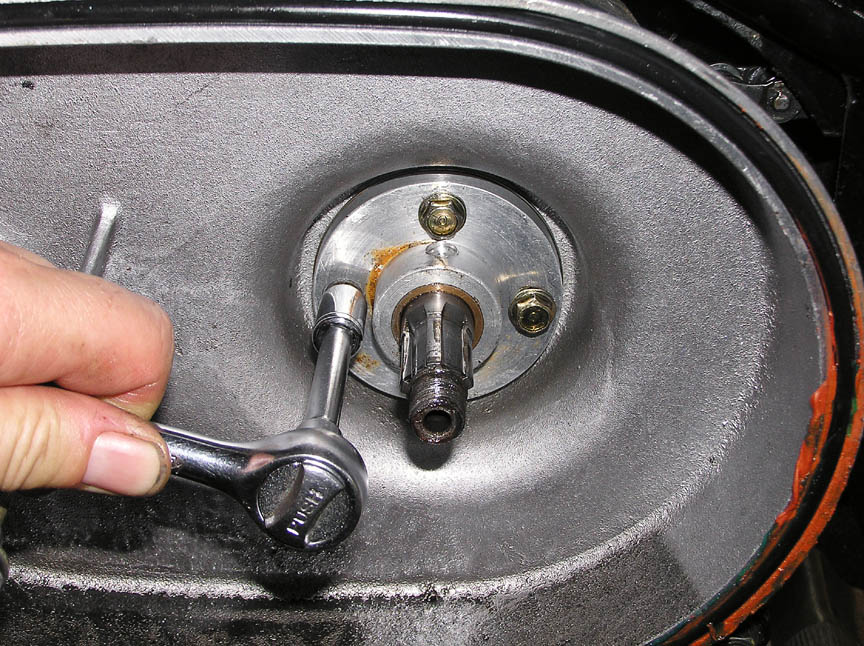

After all this work, the engine crankcase and gearbox drive sprocket are revealed! :D
In my case, a green coloured paper gasket is used to provide an oil tight seal for the chaincase flange assembly, which can be seen.

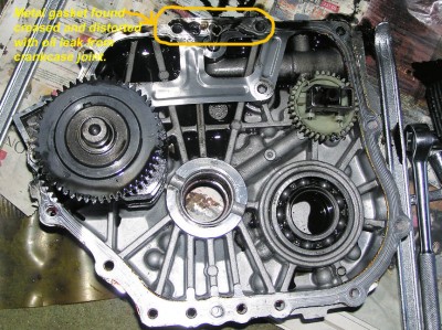

The first thing to do was to number the crankcase bolts as shown in the Yanmar L100 PDF manual, as they eventually have to be tightened up in a specific diagonal order, for the crankcase to be tightened correctly. So I removed them in the same order, loosening them off in stages, using a 12mm socket and ratchet. Then when I got to the difficult to remove bolts at the crankcase bottom, I removed the required engine bolts and jacked up the engine just enough for access, using a trolley jack under the engine sump. Then don't forget to take the oil filler plug/dipstick out!
The crankcase can then be carefully prised apart, and despite it leaking oil at the bottom, needed some quite strong blows with a plastic faced mallet to separate the halves. It eventually came away, with even more old oil leaking out everywhere on the floor. It's amazing that after being left to drain overnight, there's still lots of the horrible old oil "lurking" around in every corner of the engine! Finding any excuse to cover your hands and tools with it.
A "Jeremy Clarkson" style motoring metaphor for it all would be: - " The engine oil's like a alcoholic going home after a Saturday night drinking binge; spewing up all night and randomly into the next day as well!"
For some strange reason the balancer shaft assembly came off with the crankcase, rather than remain in with engine. I took it off eventually, though it was a tight fit in it's crankcase bearing, and refitted it to the engine before re-assembly. Also seen, is the nylon gear assembly of the engine governor, a remarkably small device!

Now the inside of the "Yanclone" diesel engine can be seen in it's oily glory! There's not much in there, though what's there is heavy duty....
The crankshaft has 'F' markings etched facing the crankcase, to aid in correct fitting, and the large gear assembly on the right is the camshaft.
There are also alignment/timing marks visible on both gear wheels.
Overall the condition looked good inside the engine, and following the old engineering adage:- "If it ain't broke, don't fix it!" so I didn't pull the camshaft assembly out, which would have meant removing the tappets, and loosening off the fuel pump. As it looked ok - best leave it alone, so a bit less work to do!
A closer look at the crankcase showed the source of the slow oil leak, after the engine wouldn't start.
The aluminium gasket had been fitted with some distortion and a crease at the bottom edge of the crankcase, and with a very thin layer of gasket sealant applied by the manufacturer, was an oil leak waiting to happen! It looks like they were trying to save money on sealant as well.
After cleaning it all up, definitely time to replace the metal gasket.

I'm getting to know this cylinder head very well now! A second time I've had to dismantle things off it and remove the head.....
At last the cylinder head can be removed, and make sure that the tappet rods stay in the right place, and nothing falls into the large gap, by stuffing a rag or kitchen paper towel in.

Continuing on again, after some effort the piston could be carefully pulled out of the barrel.
At last the piston is out! :D
The sides of the piston needed careful cleaning; again scraping off the carbon crud off the affected surfaces. The three piston rings were found to be gummed up, and not providing a proper gas tight seal any more.
So lots of time was spent cleaning up the piston sides, and freeing up the rings, until they are able to move in the piston grooves again.

Yes Sphere, without trying to give away too much of the engine story away for now! I got the engine working again o.k for one day, started it many times and had it running for over 15 minutes, and idling well :D . And then the next day it wouldn't start again when I was working on the fuel system! :(
Just slightly frustrating, and all due to a seized top piston ring! :evil:
Some Loctite gasket sealant is also applied to the back mating faces of the primary chaincase assembly before refitting. This also helps prevent oil leaks.
The primary chaincase assembly is refitted whilst the Loctite is still tacky, and then the clutch assembly can be refitted.
With the special clutch holding tool, the clutch assembly nut can be tightened and torque loaded to 40 lb-ft.
The rest of the clutch plates/assembly can be refitted, with the primary drive chain/sprocket. The engine drive sprocket bolt, is also torque loaded to 40 lb-ft.
At this point it's best to check clutch operation. For some strange reason, my clutch cable end came off on the actuator arm in the gearbox, so I had to take the outer cover off, and re-attach it to the arm, and adjust the clutch movement setting with the clutch adjuster nut and screw thread.
When that was done, the correct operation of the clutch pad rod could be checked, and the clutch plates seen to move smoothly.
Now I could fit the primary chaincase cover, and tighten it very carefully to about 20lb-ft. That's around the tightness required to prevent oil leaks! They claim 12lb-ft, but it's not enough....

There's three piston rings fitted, the top one is the 1st compression ring, the next lower one is the 2nd compression ring, and the bottom one is the oil control ring. Each one has a different profile, and has to be fitted in the correct order, and the open ends, are spaced 120 degrees apart, to provide the correct pressure seal/piston compression.
If either of the compression rings isn't working correctly, the engine won't reliably start or run properly, as I have found out the hard way!! :twisted:

The order I used to fit the piston rings, was the bottom one first then work upwards. The oil ring spring is first fitted into the bottom piston groove, the the oil ring placed over it. The ring end gap is placed facing the exhaust valve side.
Using suitable diameter feeler gauge blades!! I could now slide the second compression ring very carefully into it's groove with the manufacturer's stamp facing upwards, and the ring gap 120 degrees clockwise from the oil ring gap.
Finally the top ring is fitted, again with the manufacturer's stamp facing upwards, and gap facing the inlet valve.

Finally, a summary of what I have had to replace and do, to get the engine running normally again:
The cylinder head gasket had blown which needed replacing, and the cylinder head and valves had to be cleaned of incomplete 'vegefuel' combustion carbon build up.
Both the metal crankcase gasket and engine output shaft rubber oil seal had blown, due to the compression pressure leakage past the now gummed up and seized piston rings. These were replaced.
The piston and rings were replaced, because of the above, and the piston can be easily damaged when removing old piston rings, so it's a good precaution.
