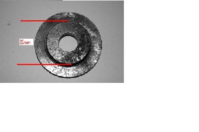

This is a wet type clutch, the plates perform better dry however the original supporting rollers in the centre don’t! the 47mm sealed bearing is fits in to the centre of the original clutch drum but you need to make up a new centre to fit the bearing (See Photo)
The centre support hub that mounts the drum onto the mainshaft and is the inner bearing surface for the rollers is need to be machined down to fit inside the sealed bearing. Being tempered steel unless you have access to grinder this is difficult. As this is not splined I machined a new centre up from a sacrificial sprocket.

The Villers clutch certre that need reducing or remaking as it has no splines its simple job
