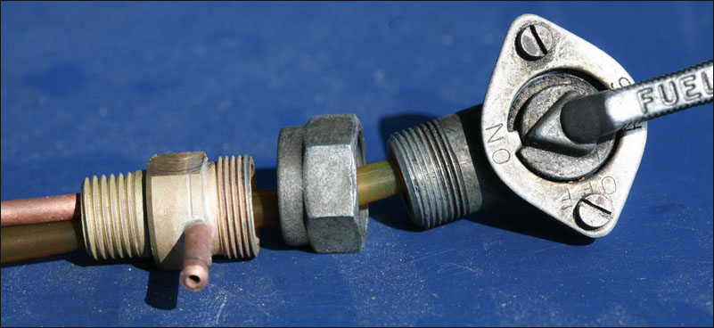

Now that's some fine craftsmanship.
Now please tell me why creating such compactness is needed to dictate using a method like that?
Are you conscrned that movment will cause the two to rub together inside that joint and cause a leak? Once you know it's leak free maybe fill it with expoxy??

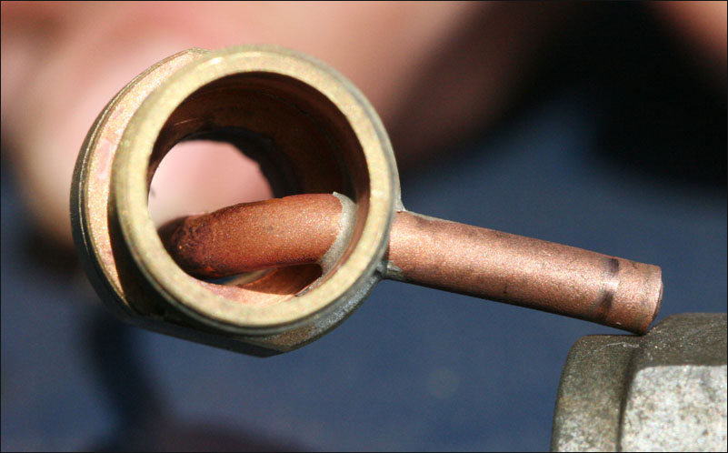

With this device you dont have to drill a second hole in your tank.
Injector fuel leak ( spill?) connection is connected to the coppertube

Re: Combined fuel feed/return
ahhh so the left side of the top photo sticks into the tank?

Yes :-)

That's a very nice piece of craftmanship :shock:

I really like it Nanko. Does it screw into the normal Enfield fuel tank?

That's the neatest return I've ever seen.
Is that a pice of Kunifer brake pipe?
Epoxies or Silver Solder?

4 mm copper pipe , silver soldered

my understanding is copper like that will work harden leaving the tendency to crack. Just something to keep an eye on.

The petcock mod by Nanko is a simple effective solution. It seems relatively easy to add a mesh filter. My only addition would be to add a length of tube to allow the excess fuel to dribble, pour or cascade into the space at the top of the tank near the filler.
