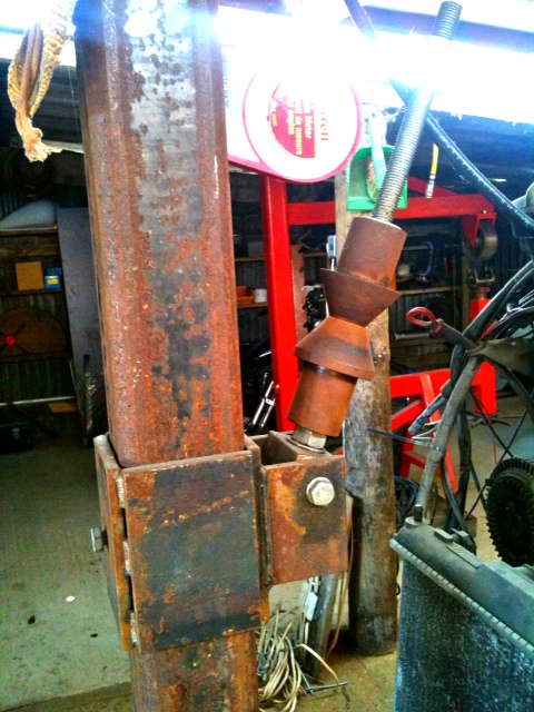

A shot of the jig used to hold front frame
