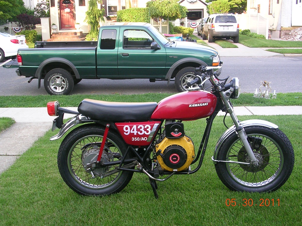

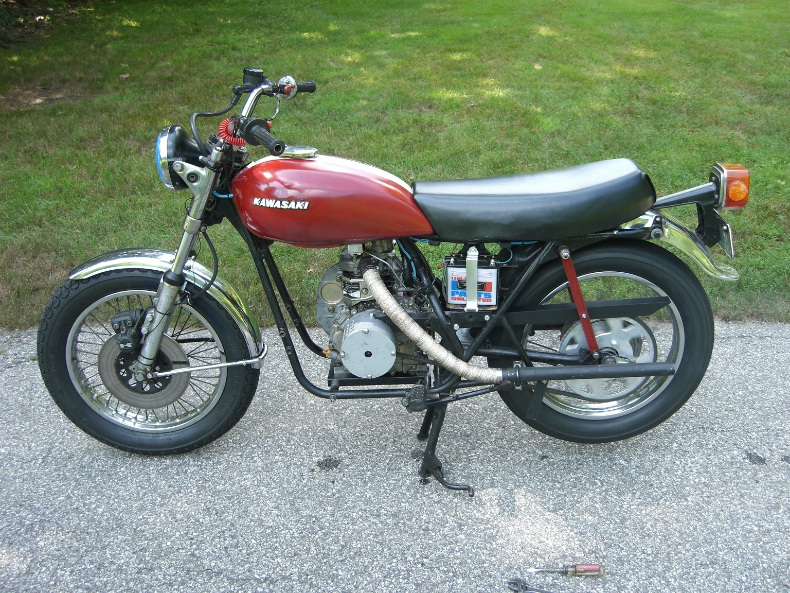

I posted one or two pics of this bike when I joined this forum, and think its finally time to put up a build thread. Improvements since the summer:
- new wiring harness
- solenoid kill switch
-better clutch lubrication
- new exhaust system

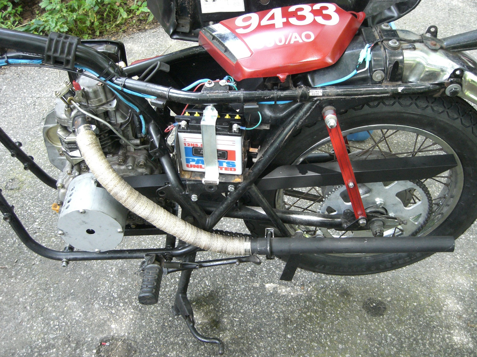

I made the exhaust from pre-bent wiring conduit that I bought from Home Depot. Stripped the zinc and found a guy to weld it up for me. There's no baffles, and its definetley given me more power (and an awesome exhaust note).
http://www.youtube.com/watch?v=r9Zfyyb_Lkg
I also made some adjustments to the clutch, and it now locks up strong enough that I can climb fairly steep hills (very slowly)

I love the style of your bike mate, its very much what I'm going for with mine, Whats the take off like with that HUGE sprocket and whats your top speed ? Also what size is your engine ? All ???'s but I love

Being a single speed drive, it looks like you've got a pretty good top end speed...what is the reduction ratio? Nice build!
