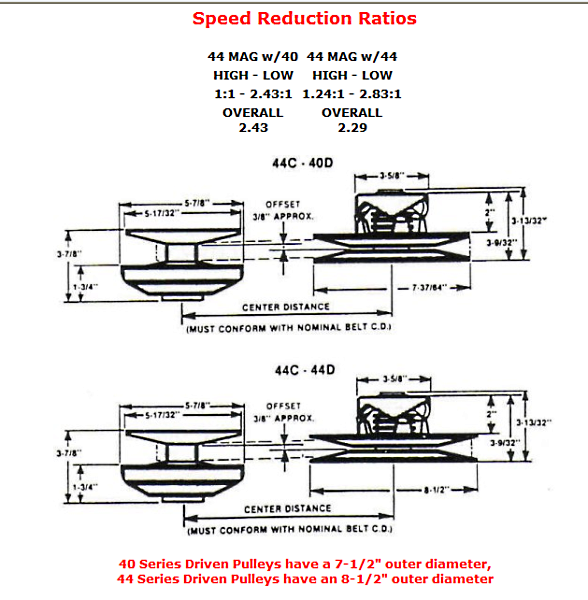

Thank you. What was your combination of Driver Clutch unit and Driven Pully unit? According to the below from GoCart's USA there are two ratio bands available according to which driven pully one uses.phoenix827 wrote:We have a 10hp Sterling engine which is a Yanmar clone and used a 40 series Comet. We tried several different gear ratios and the 40 series Comet is not adjustable. ....

My drive is the top in the diagram. Interesting thing to note is it only shifts the range. It does not increase it. It moves the entire range 0.24. This can be altered by changing the final drive. We tried that. Utterly useless change. The five speed having a overdrive gives me much more gear spread. This is very useful with a limited rpm range. This should work very well.
Re: CVT and hills- a no go?
Don't know how much affect tenths make on ratio range. My math may be off but it appears the spread of the range increased with the larger pully. Higher range went up 0.24 and lower range changed by 0.40.

The diagram you posted shows the ranges for both sizes. The range increase is negligible. The one drive never makes a true one to one ratio, basically an under-drive.luckily that is not the one I have. I believe it would be worse than it is. I have been in contact with many others, all report the same problem. The problem lies in the fact that there is no way to hold it in the top range. As soon as the rear wheel changes speed, the drive reacts. Its nice to have an auto trans, but there is still the issue of parasitic loss. Some have told me it is as high as 30 percent. That could mean as much as 30 miles to a gallon more for me. My new trans will be finished by the end of this week, then I'll begin the install.

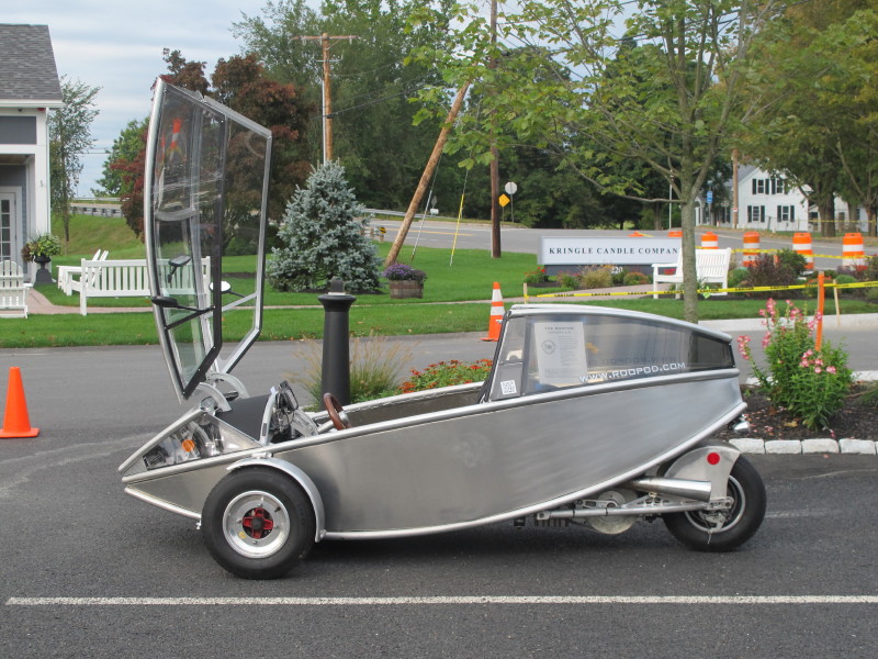

Hi there, I have a Kubota Z482 (13hp) engine with a comet 94c/90d set up...I also have the problem with slowing down on hills...but I think that is because I have the drive pully set up with extra weight to engage at a lower rpm which causes the centrifical portion of the drive to have more force relitive to the torque reactive driven pully. On a hill, the drive shifts to about the engine's torque peak (+,- 2500rpm) and just chugges up the hill...the drive should allow the engine to (just) reach it's top rpm (and max hp) on the 90d drivin, there are several adjustments that can be done to control the force that the torque reaction produces for overpowering the driver pulley's centrifical forces...I will be doing this shortly, and report back.
if you would like to see the Vehicle, go to http://www.roopod.com as far as durabilty, I have 2000 miles on my first belt, and I can see that it has worn, but there is yet very little if any change in the way that the cvt behaves...
