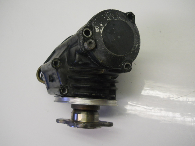

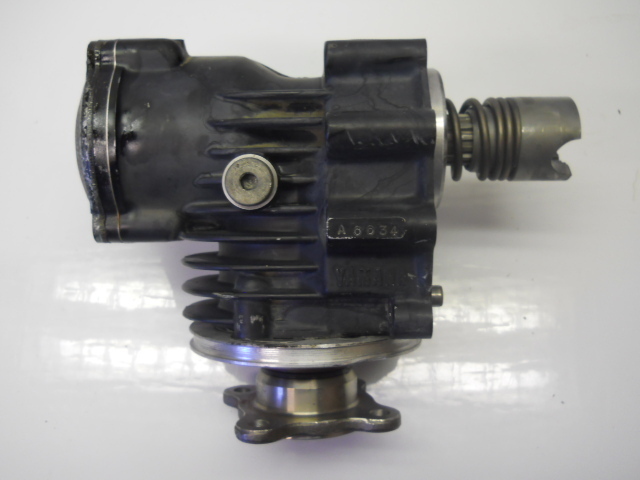

Another option to consider: There are many Japanese made bikes that have transverse engines and are shaft drive. In these bikes there is a bevel gear at the output of the transmission that usually has a ratio of between 1:3 and 1:1.1. These are referred to as the middle drive gear set or middle bevel gears and usually come in a separate housing that is smaller and made of aluminum so much lighter than some of the agricultural alternatives being discussed. Also they are rated for the conastnt acceleration and rotational speeds of motorcycles (industrial boxes can suffer from high drag forces at elevated rpm’s due to the use of heaver seals, and oil levels that run a much as 1/3 of lower portion of the gears through 90w gear oil). They are also designed to run this way for 100K+ miles.
Oh, and on EBay they are cheap. There are many options and good ones are $40 to $100
http://www.ebay.com/itm/Yamaha-XS750-XS ... db&vxp=mtr
Or if you want something even more robust you can use a set from a Kawasaki ZG1400 which is what I’m using on the Bonneville bike (in my own custom housing)
Peter~
coachgeo wrote:below info added by moderater (coachgeo) since the ebay link will be of use only very limited time. Info is from Ebay ad linked above:
Yamaha XS750 XS 750 #2317 Middle Drive / Bevel Gears / Driven Gears (Sold by the Cycle Barn, http://myworld.ebay.com/thecyclebarn1?_ ... 7675.l2559 )
The Cycle Barn wrote:the items for sale are the 1977 Yamaha XS 750 - Middle Drive Gears. They are in good usable condition. They came from a motorcycle that showed just over 25,000 miles on the odometer. Everything shown in the photos is included and in good usable condition. (LJ 12)
Does the design of this Kawasaki unit nessessitate a custom housing in most all applications?
bean juice
Posts: 20
Joined: Mon Nov 16, 2009 11:01 pm
Re: Mating a VW engine, frame, and transmission
Post by bean juice »
Sort of. The Kawasaki housing is designed to bolt to the side of the engine cases but unlike the XS750 is designed to be more esthetically integrated to the engine. My application has a number of requirements that add a level of complication that most people here won’t need. In my situation running a BMW style single sided rear swing arm has big advantages for me so part of my design is a rear spindle/axel that can accept a BWM R1150rt rear wheel. My housing also integrates the rear brake caliper mount as well as a mount for the ABS sensor which will be used to monitor rear wheel slip on the salt.
A number of other bikes (like the Honda CB900) had middle drive gears in housings that would work as final drives. The other place to look is Quads or 4 wheelers. A number of them had motors that were essentially repurposed air cooled motorcycle engines and they slapped on a middle drive gear box where the transmission output shaft once had a sprocket. Just doing a search on eBay for “middle bevel” comes up with a bunch of stuff. You’ll have to do your own research on ratios though.
