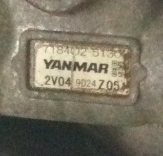

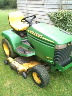

Re: 2v78 Yanmar questions
They use this John Deere 355D to cut the grass where I camp and yes it has V twin Yanmar under the hood. 2V04 on this engine. Not sure if it's newer or older lump.

Hi Stuart,
The 2V04 number is the injection pump number. Mine has the same pump. There should be a sticker on the one valve cover that would show the engine model number, year it met the EPA spec, power output, etc.
Now, if the engine goes missing and Stuart is riding a diesel bike...someone might get suspicious
Jeff
Thanks for pointing that out! Yes, I must admit to casting an envious eye at the mower, lol. Owner told me of a service place locally to it that may have speares/engines but I never followed it up. Mason's of Rixey Park. Chudleigh, Newton Abbot, Devon, UK.
