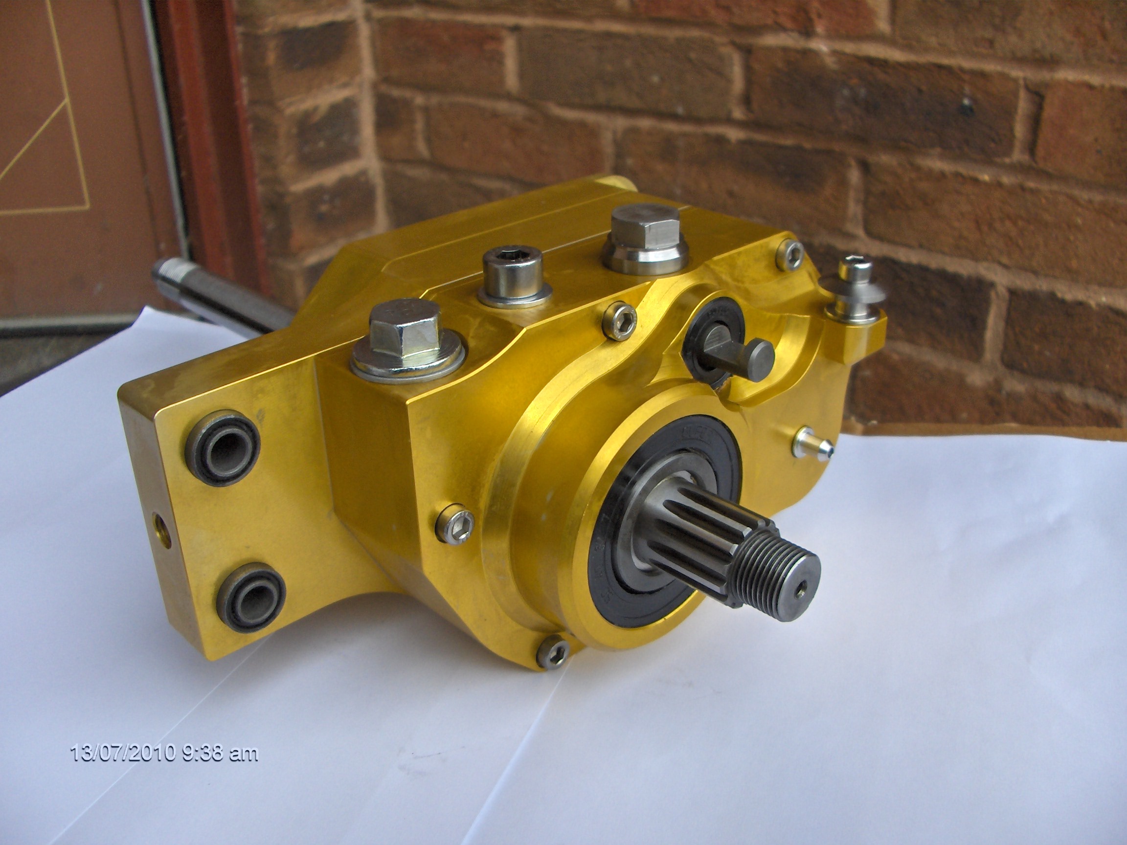

Re: Reverse-neutral?
Check this unit out...I ordered one of these with the appropriate shaft for a Comet 94c just about have it installed in the ROOPOD ( http://www.roopod.com ) I will have pictures of it on my site soon! Pricey but looks very first rate...
http://www.novaracing.co.uk/reversing-g ... ng-kit.htm
The roopod is far from done, but is now street legal..check out more on the blog: http://www.roopod.com that's me and the misses' when we got the 'pod inspected...now have 170 miles on it! nova racing reverse gearbox is doing great shifts like a dream!
