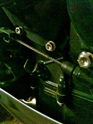

Some argue that several coils of the copper tube will absorb some of the vibration and reduce the chances of a vibration induced crack/failure (emphasis on reduce. The potential is still there).
Another option is to go with the braided stainless lines like the chap is using on the Estonian version of your bike for his fuel line. But also more expensive that a piece of copper. And while he has a substantial fuel filter and oil cooler, I see no evidence of an oil filter.
http://static2.album.ee/files/922/41/or ... 7_rnQ1.jpg (click on the pic for the close-up)
Keep up the good work and may Molly enjoy many more.
