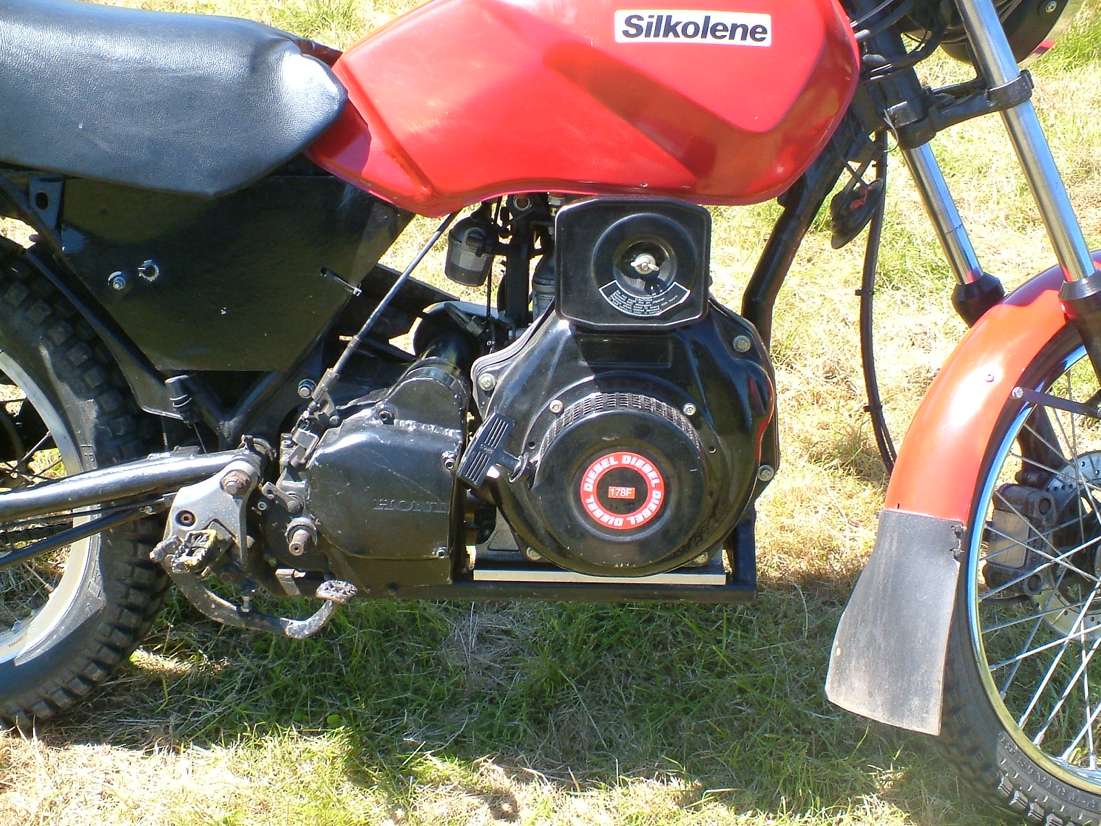

Many people are wondering how I used the original 5 speed trannsmission from a 1972 Honda cb350 in my dieselbike, seeing how the factory eingine and tranny are one integrated unit.
I have lost many of the original pictures i had while i was building the bike, so bear with me.
So, In a nutshell, the first thing I did was to cut the cylinders off the original cb350 engine\tranny combo using a sawzall. the next steps were to modify the frame so the engine would fit, mount the diesel engine, etc.
I hate pull start...at least it works every time.
Stretched frame...two inches makes a big difference.
The Engine and tranny are linked via a #40 chain, The sprockets being a 48t and a 24t. This gives the bike a primary drive ratio of 2:1 (obviously), which is considerably taller than the factory 3.62:1. It's actually geared too high because i do most of my cruising on 4th gear (I use 5th for downhill sprints and with the wind...lol). The chaincase and tranny are both lubricated by synthetic 75w90.
adjustable tensioner, as long as you have a die grinder and a welder.
The 48t sprocket is attached to the clutch basket with four 5/16" bolts through four nuts that are welded to the original gear on the basket. I did that so i can replace the sprocket if necessary. There is a chain tensioner on the slack side.I actually had a problem with the tensioner coming loose (another story), but so far it's been pretty reliable after almost 1000 miles.
Sorry 'bout the dirt, i ride a lot of back roads
I hope this sheds some light on the project, any questions...just ask.

You should also mention and others take note, your engine is a reverse running engine, one that runs clockwise verse normal counter clockwise. I didn't see it mentioned in this forum. I noticed it right off the bat on the YouTube video, good job.

This engine turns CCW, just like most engines. That's why i put the tensioner on top...less stress.

Your right, I never knew the gear box reversed direction, wow, I learned something. It makes sense now as it was gear drivin, reversing direction. Your engine does run in a reverse direction from normal, back to the drawing board.

anyone got pics of the engine/tranny complete like the one he disected. Hard to picture what he ended up with out knowing what it looked like before disecting.

Did you have to cut the side off the box and then weld a plate on? I love the primary case btw with the little welded nuts in.

looks like a normal engine to me, CCW rotation, it's just mounted in the frame, reversed...primary drive on the right...not the left...that's why the chain tensioner is on the top run of the chain...original drive for that tranny would have been with a gear, likely...so it makes sense that's my 2cents...Roo

The chaincase is designed to bolt onto the tranny where the original clutch cover was mounted using the original bolt holes on the tranny (and i added some for strength). It's all sealed off and in oil ...well, it leaks a little.

Roo is absolutely right, CCW rotation, nothing special about this engine

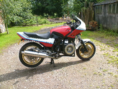

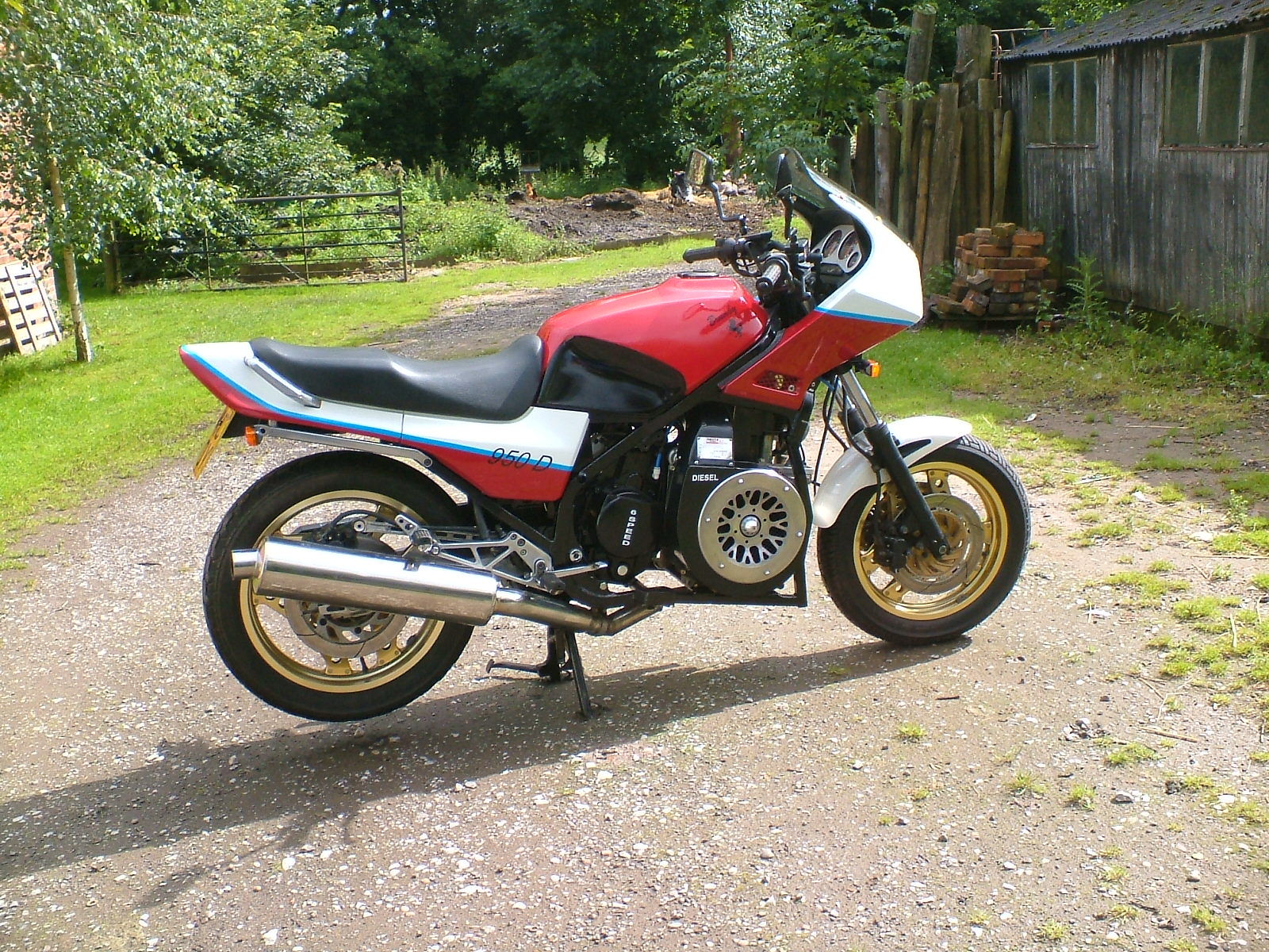

hey guy's here's what ive got going on, not mobile yet so no data to reveal, perhaps one day.

Looks like things are going along really well Boxer! CoolBoxerOtto wrote:hey guy's here's what ive got going on, not mobile yet so no data to reveal, perhaps one day. http://img36.imageshack.us/my.php?image=dsc01495f.jpg http://img524.imageshack.us/my.php?image=dsc01494h.jpg http://img197.imageshack.us/my.php?image=dsc01456w.jpg http://img44.imageshack.us/my.php?image=dsc01455l.jpg http://img530.imageshack.us/my.php?image=dsc01454q.jpg http://img14.imageshack.us/my.php?image=dsc01451m.jpg
The Japanese tyranny's are so compact and very reliable most of the time, making a really good box unit if you can adapt them as been the case by others on the thread.

thank's andrew, i really can't wait to take this thing for a spin,but you know, LIFE!!! anyway now my imageshack thing seems to be working i'll try to keep a little more up to date.it's a kawasaki kdx 175 transmission with six well spaced gears. if you turn the former crank shaft 8.5 times the countershaft goes 1 in first gear and in sixth works its way to 2.25 to one. should be plenty low for taking off. it's geared 2 to 1 up from the motor so at 3600 it's turning 7200 just like the kdx used to.capped off the cylinder area and is just an oil well for the bearings now. i'm going to try an automotive style tensioner under the belt and scince these pictures it also has a buffer to keep the engine from twisting under load.

Can you get a shot of mostly engine/tranny combo. Those pics are so small its hard to tell much.BoxerOtto wrote:hey guy's here's what ive got...

let's give this a go, a few closer tranny engine shots. http://img196.imageshack.us/img196/9914/dsc01369w.jpg http://img44.imageshack.us/img44/3686/dsc01368q.jpg http://img19.imageshack.us/img19/7675/dsc01350cfg.jpg http://img132.imageshack.us/img132/3677/dsc01349d.jpg http://img34.imageshack.us/img34/5150/dsc01370gcp.jpg http://img197.imageshack.us/img197/7682/dsc01347dcv.jpg http://img44.imageshack.us/img44/9177/dsc01388g.jpg

no problem, but don't take this as a problem free solution. this is just my way of mounting it in and is still an unproven concept. i make changes as i go along but fairly confident i can make it work. it helps to have machining & welding capabilities on site. its the lack of time that keeps it from getting finished.
there are many solutions to come to the same end, some work,some work well,and some may not work as thought.keeping it simple should keep the bike reliable and easy to work on and service.this is why this site is so great for sharing ideas and experiences.
cheers, Otto.
