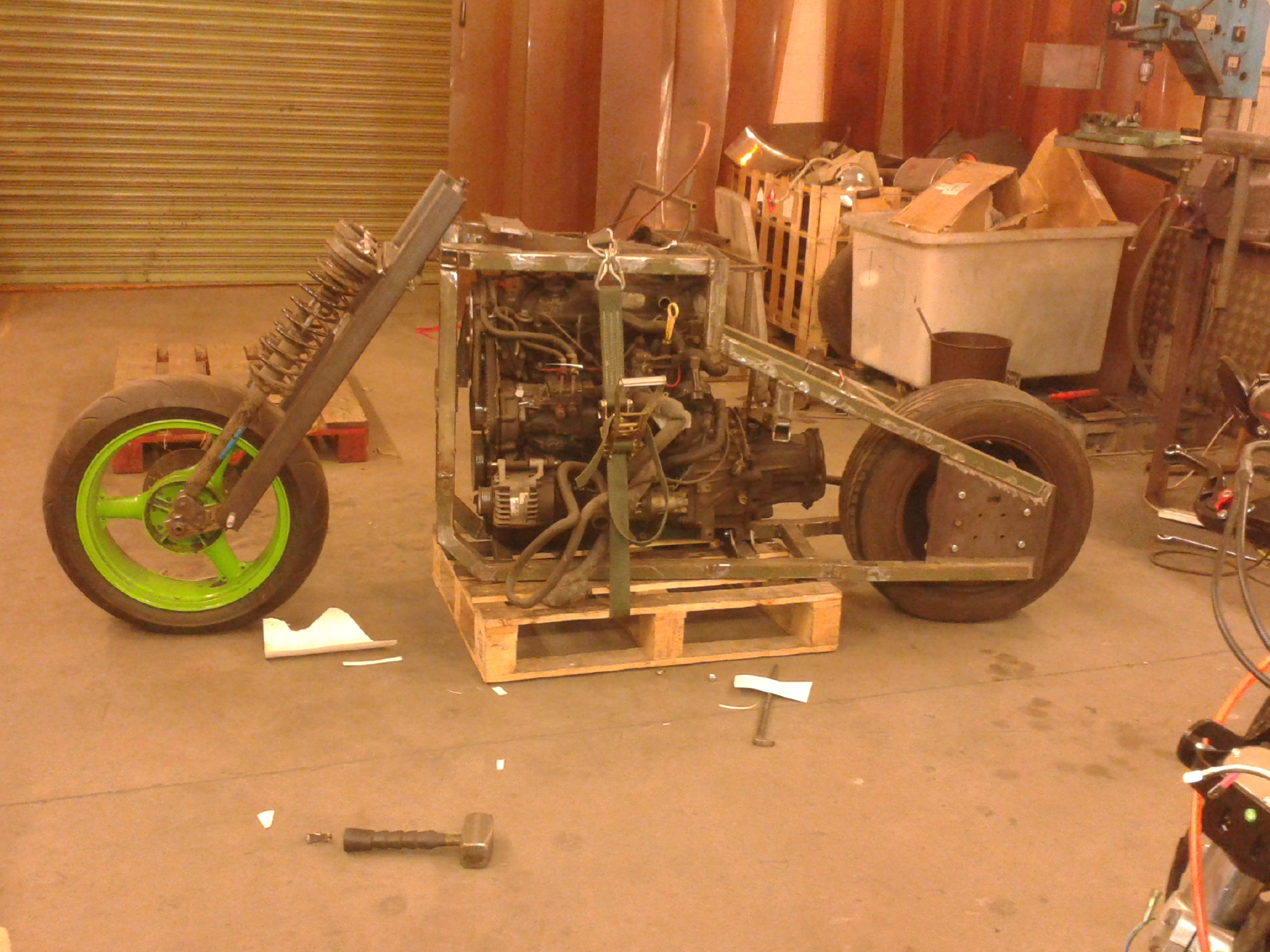

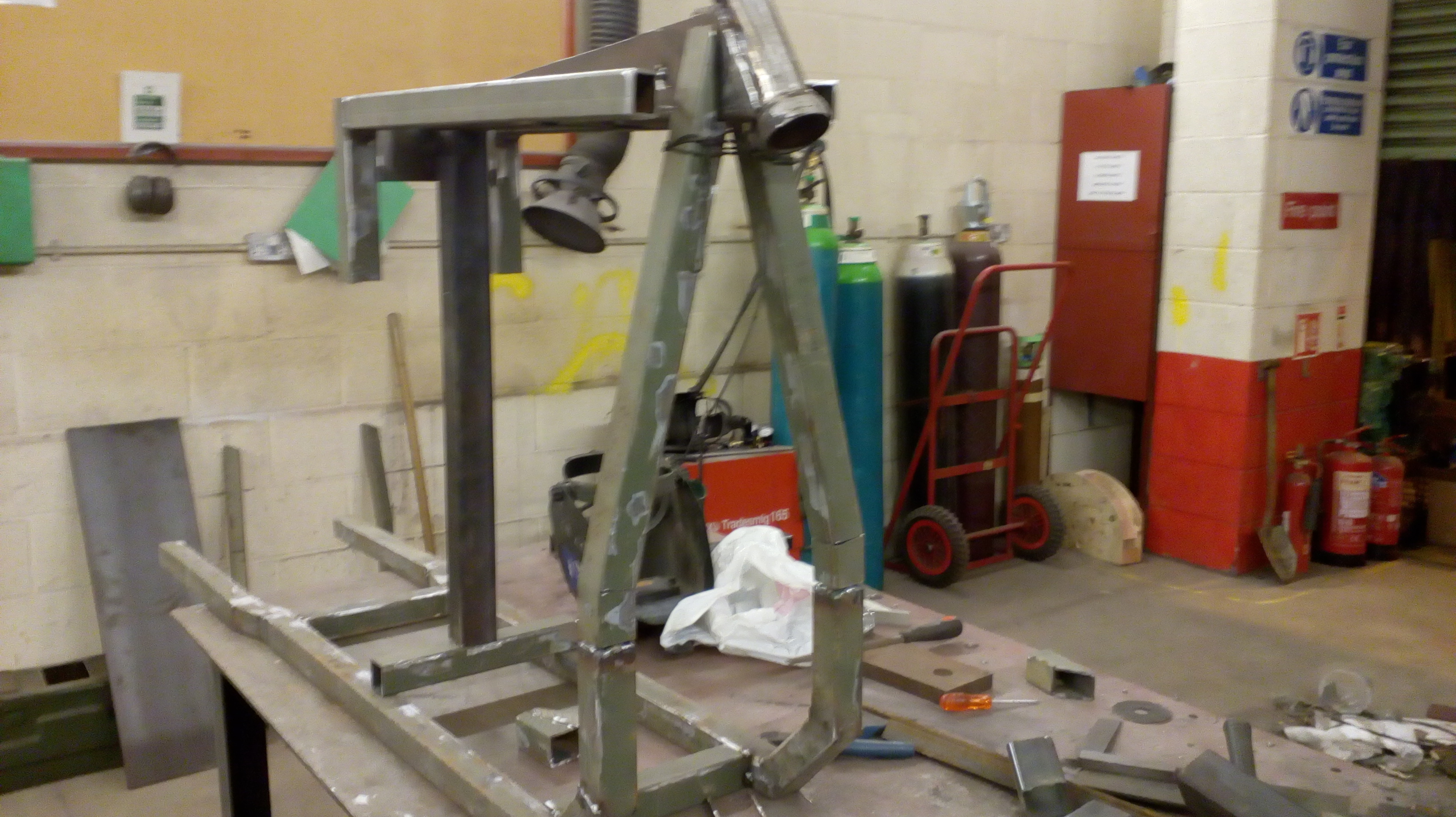

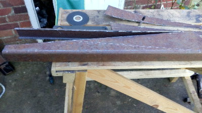

Ok I have now finished Ed's bike. I have started the project as of yesterday. I have been gathering parts from all over on my bike and i have had a few strange looks along the way.
but I have now got most of what I need to start.

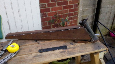

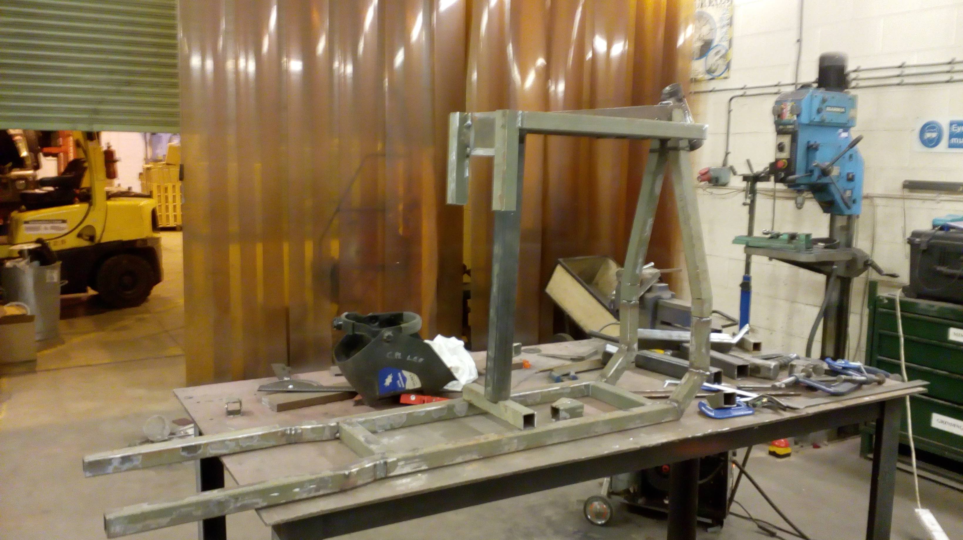

I have started with the best bit had a good afternoon with the grinder I have cut the headstock from the frame that I had in the garage.
I have been scraping around looking for stuff to build the frame with I have done quite well. I have got enough to make the frame but I will have to part with some cash soon as I need some 8-10mm plate but i will try the scrap yard up the road first as I think it will be about £50 for new. I am keeping to my budget so far £0 as i have sold some of the car parts and I am still in credit :D . This weekend I want to get most of the frame parts cut ready to be assembeled. I am aiming for a rolling chassis by end of march hopefully but i have to make everything.The frame is offically the start of it for me now. :D

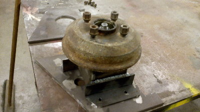

Parts that I will be using so far

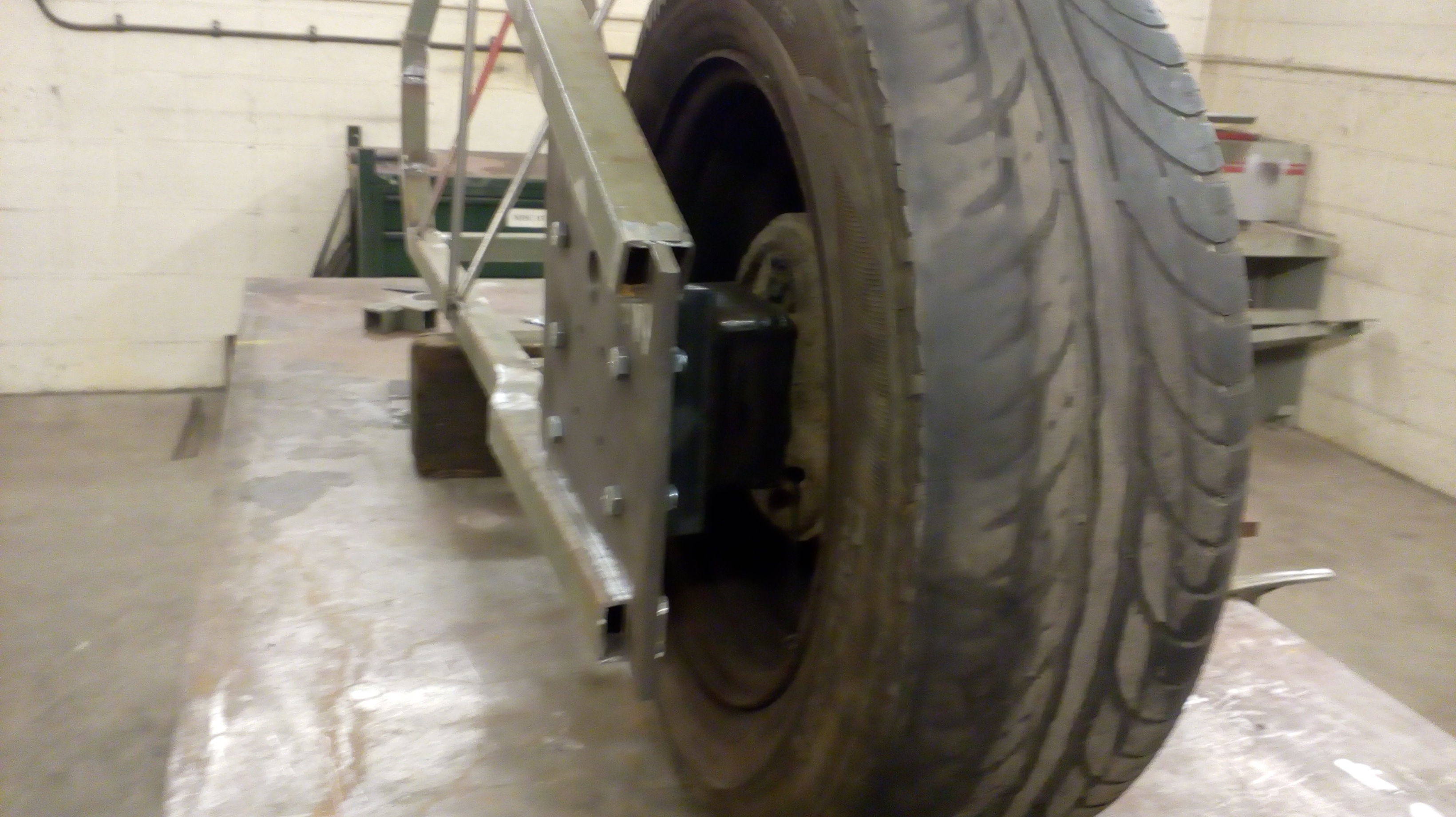

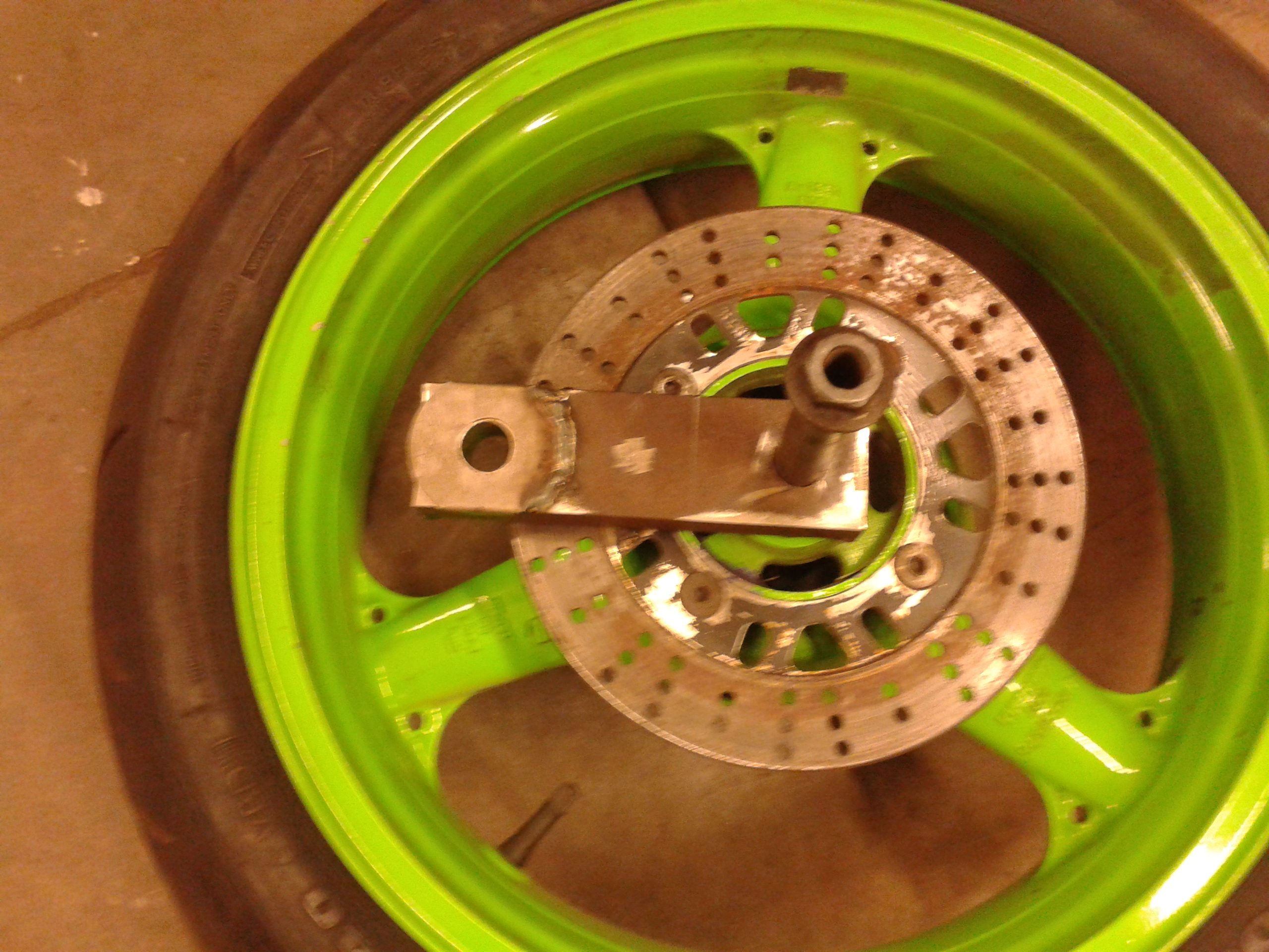

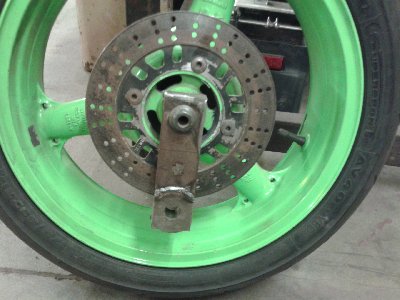

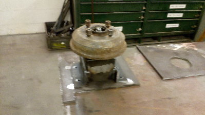

rear hub - rear drum brake from car bolt on
rear wheel - modified car wheel and tyre 15"

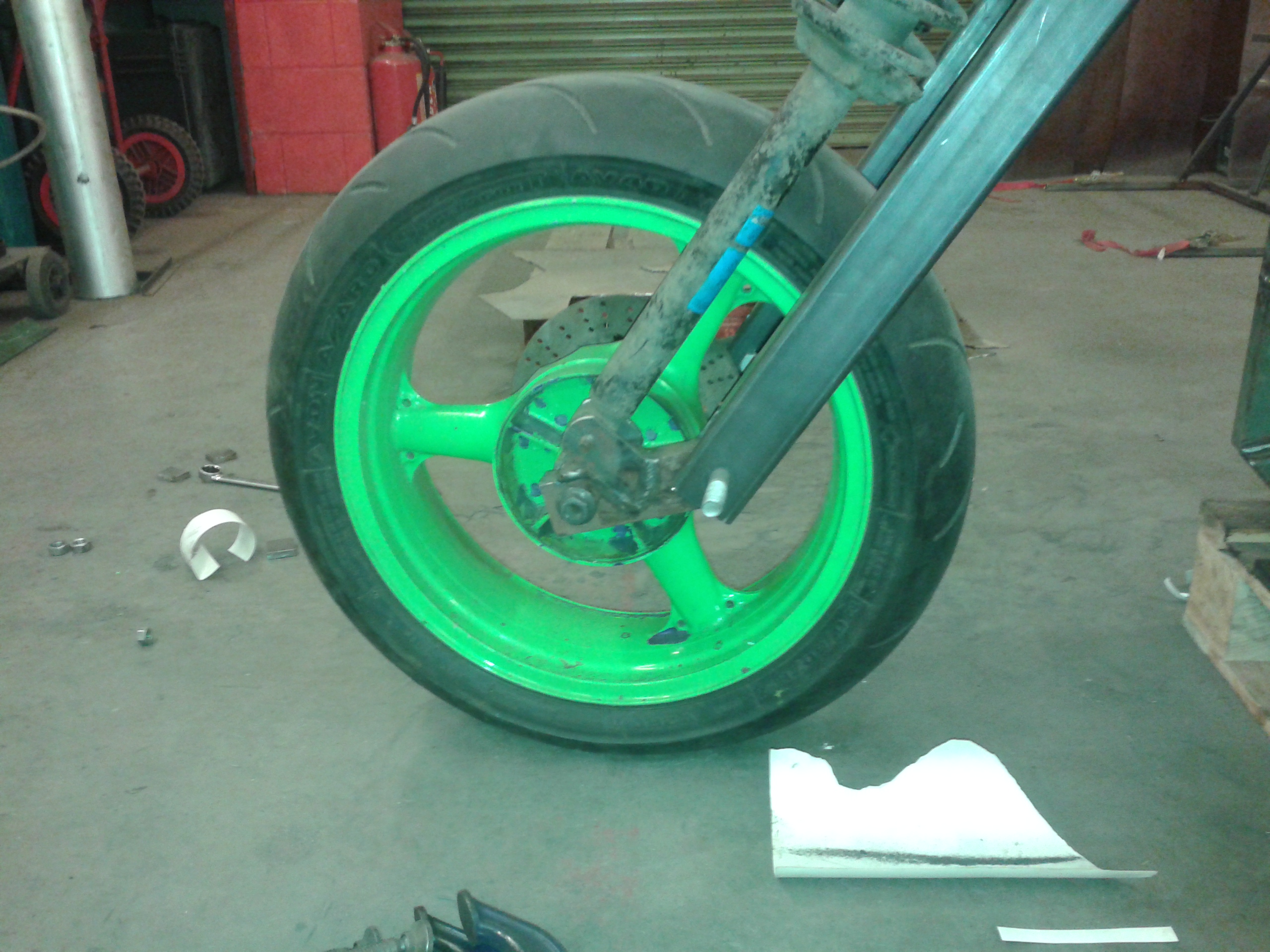

front wheel - rear wheel off bike 17" as it came with everything including tyre.
fiesta 1.8TDDI engine and gearbox
drive to rear wheel - MF35 PTO belt drive gear.
forks ? heavy duty springers I have got to make them.
Frame - reclaimed 40mm box section and some 100X50 that I had in the garage.

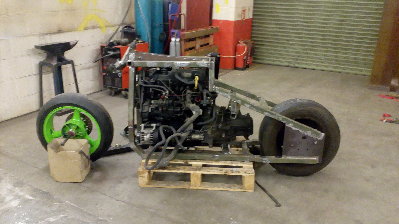

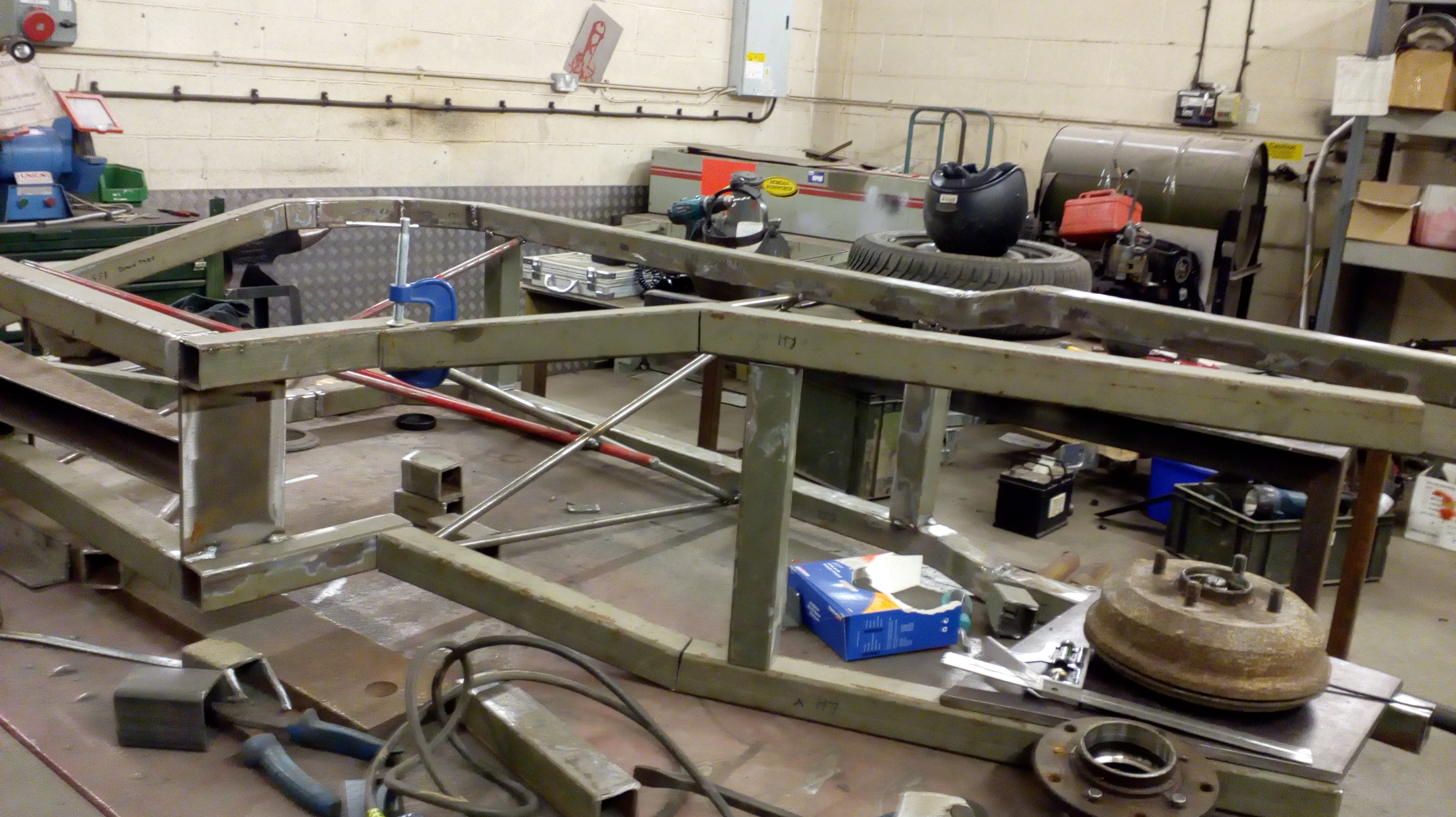

Slow progress

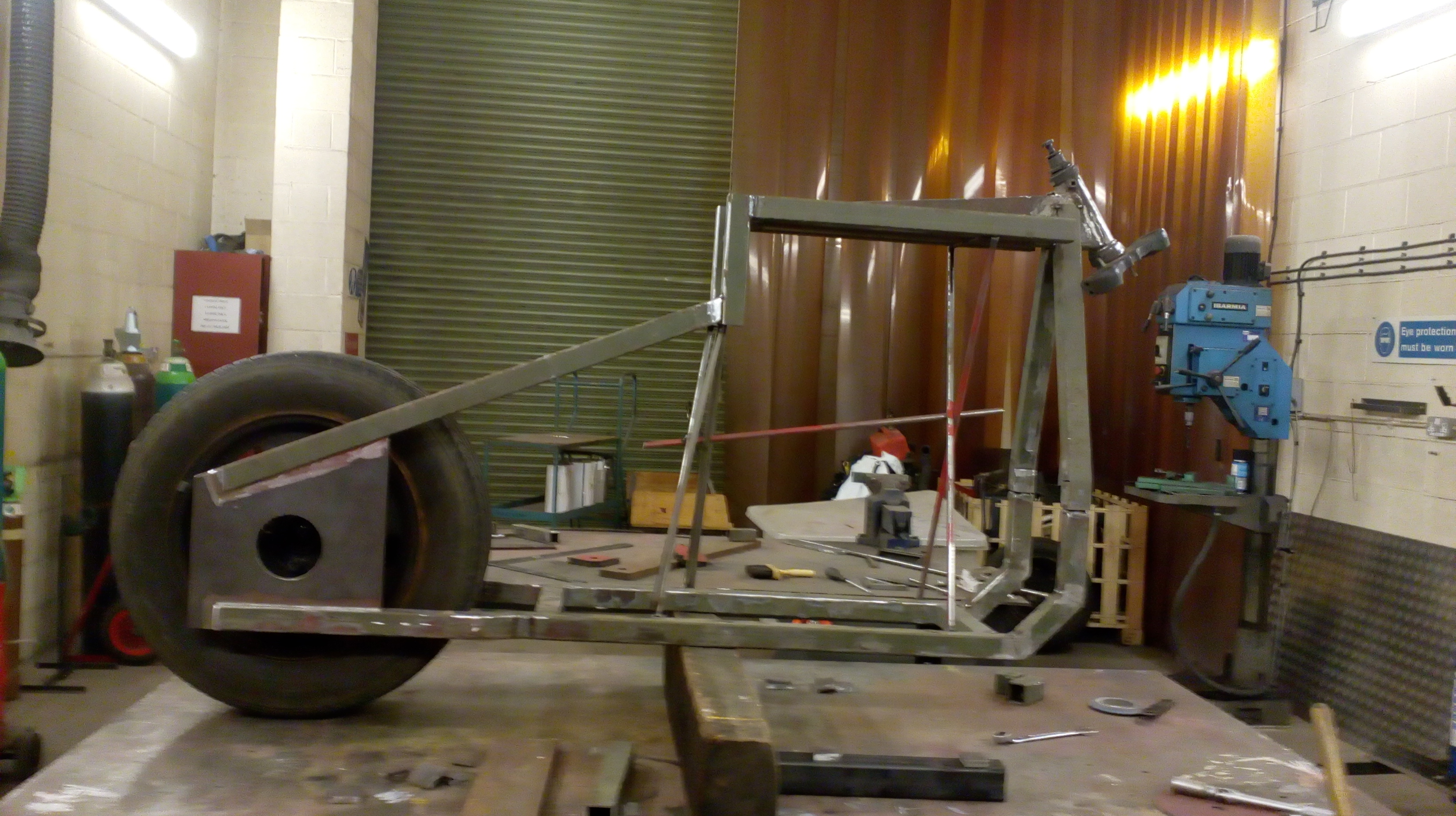

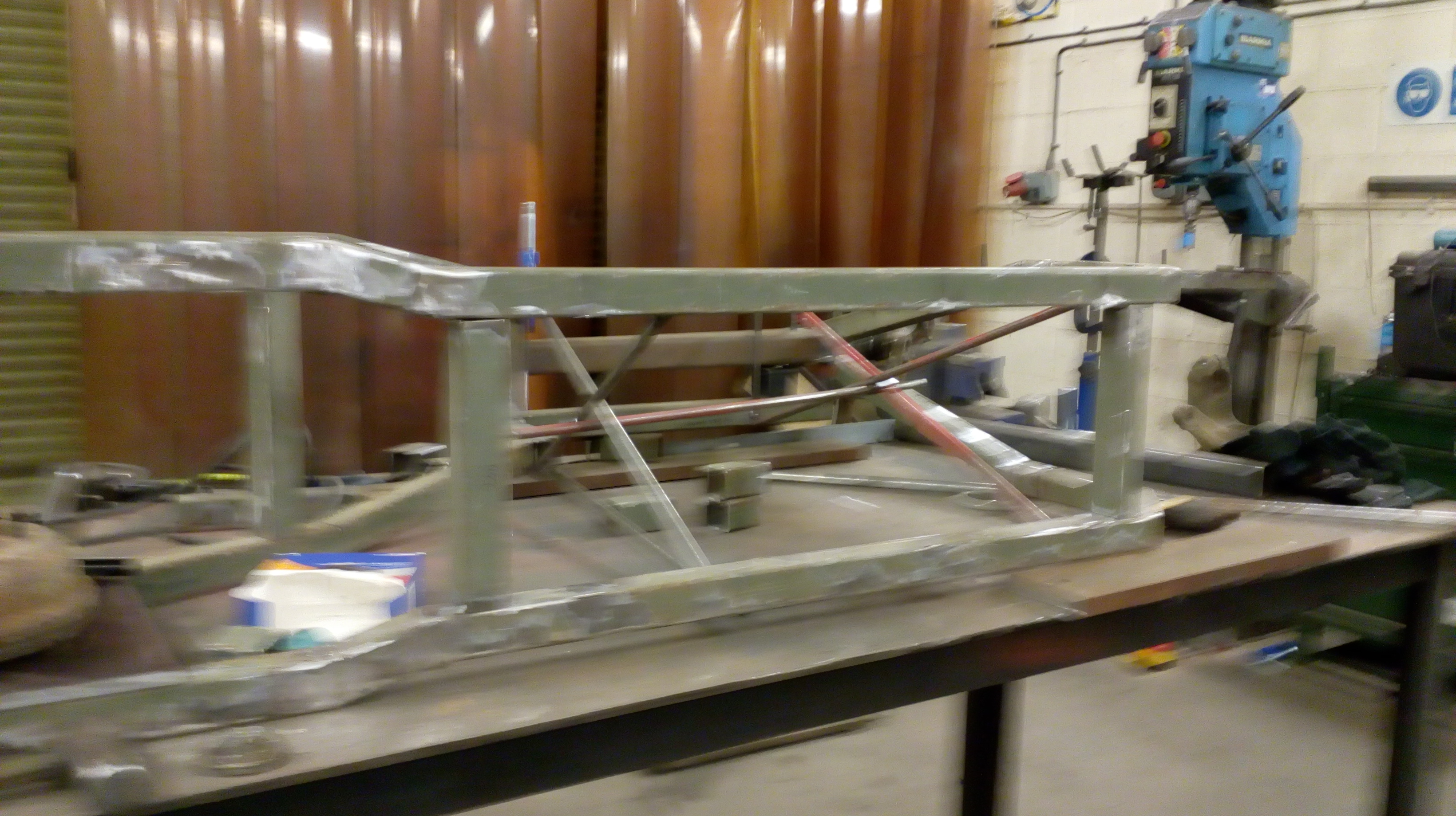

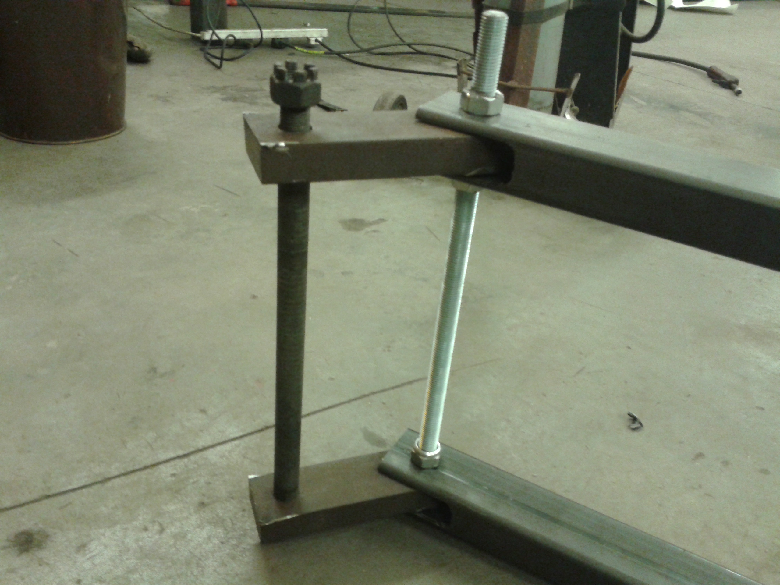

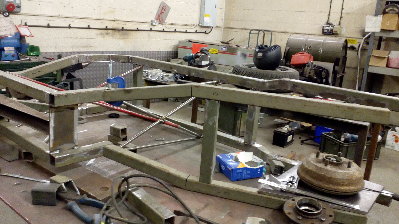

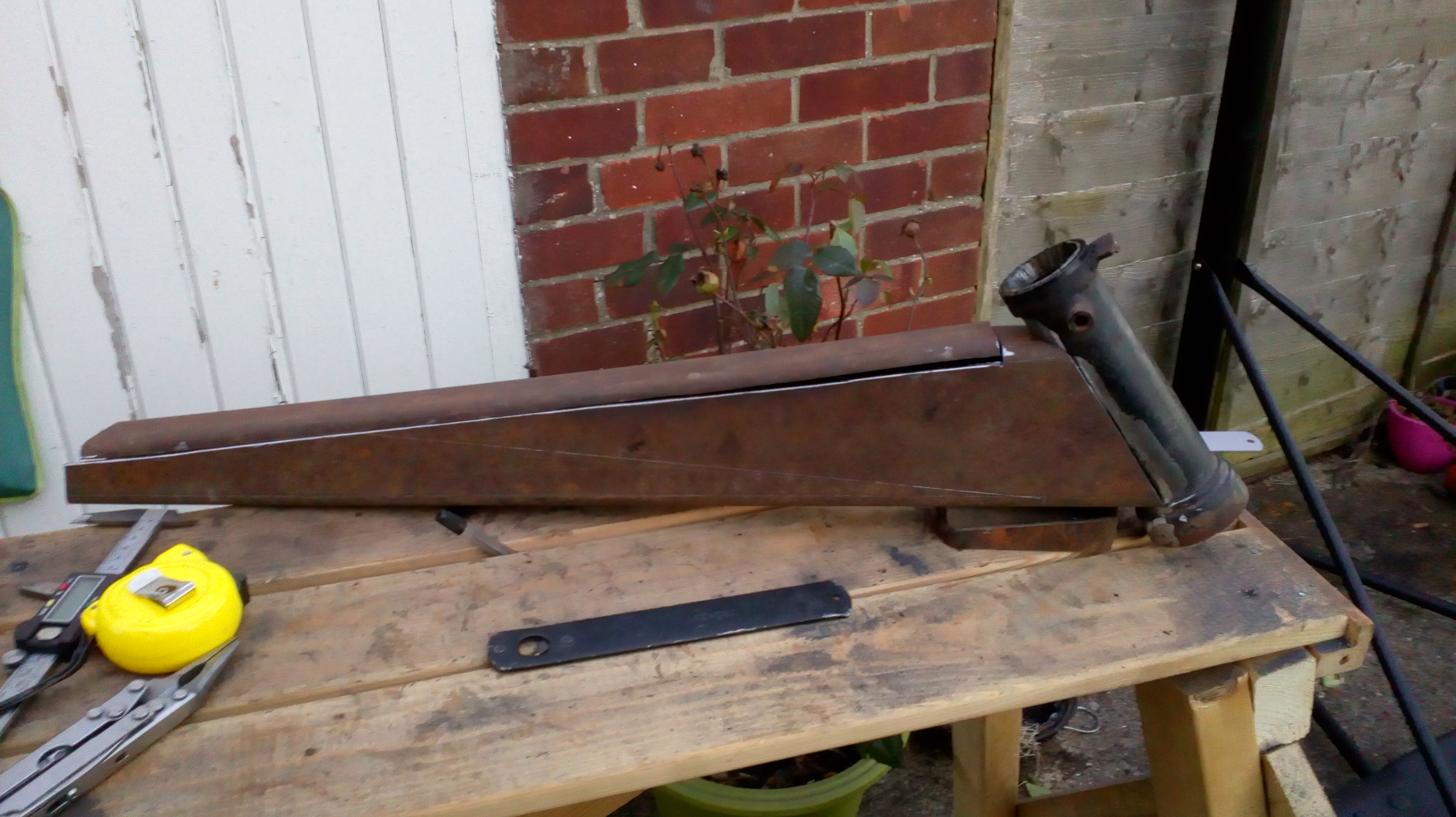

I have been busy at work but I have started on the frame i have everything that I need now but it is taking time. I dont have a jig so I have to make everything in stages and keep checking allignment. I am having to make the Hub attachment at the moment but it involves quite a bit of thinking and I have to make the wheel fit everything that I have. I think that I will be spending some more time digging through the metal skip at work for the perfect bit as I dont want to spend any money I have had to spend £50 for some material for the forks and the rear of the frame but I sold a few more bits from the car that has covered it. That will be it for a while as I am busy at work but I will keep plodding on to get this next part finished so that I can complete the frame. I hope to have the frame completed by march ready to make all the engine mounts. :D

It’s been a while but I’m back on track now I have been busy at work. I have not had much time and no time to get on with the bike. I had made most of the frame but I could not finish it until I had modified the wheel I have or bought a wheel to fit the hub. I found a wheel for £5 while I was looking for something else and the bloke worked in Abingdon so I got him to take it to work. I picked it up on Friday. I have been measuring everything up and am now ready to get it started. So I run a car club on Tuesday on the camp so I spent most of the evening sorting out what I needed to make a boss for the car hub to bolt on. The lads finished early so I thought I would just tack everything up I ended up texting missis will be late and I got it all welded drilled and still got home just before midnight . I had some spare time yesterday so I thought I would have another go I did a few more welds and I ended up tacking the rear of the frame and mounting the wheel and the hub .I will be trying to get some more done over the weekend to put some more frame pieces in. Here are a few photos up to now. :D

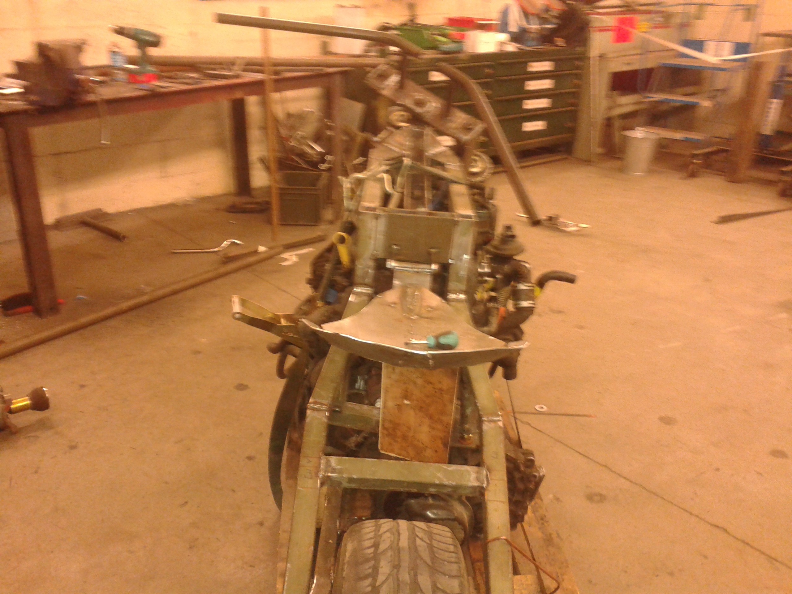

Getting there,
Done some more today all welded up now no photo's going see if I can get the engine in the hole this week. will put some photos up when its in the hole.
hopfully I will be making engine mounts tuesday. :D

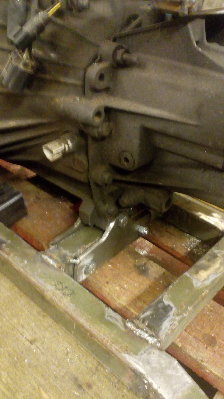

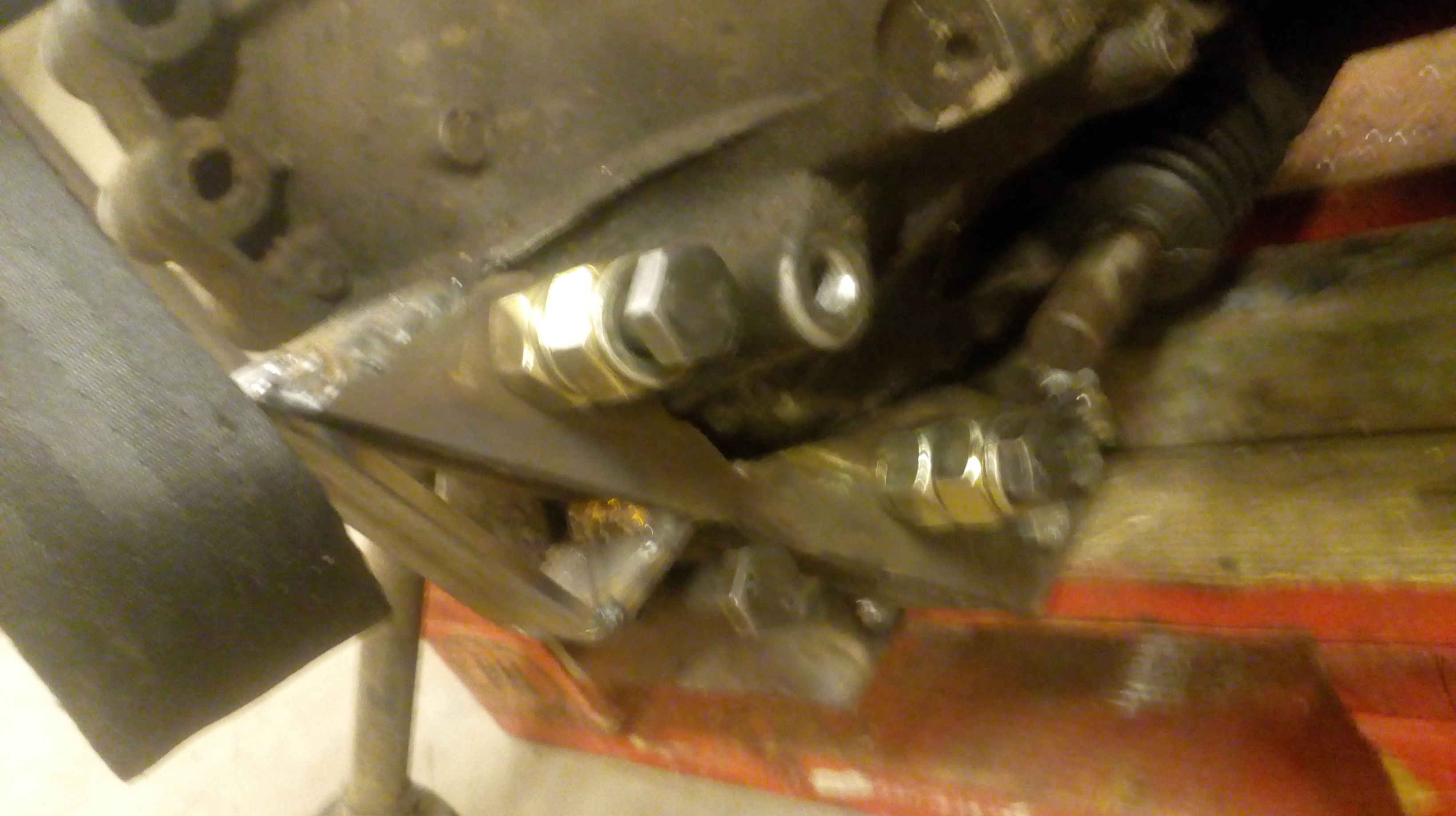

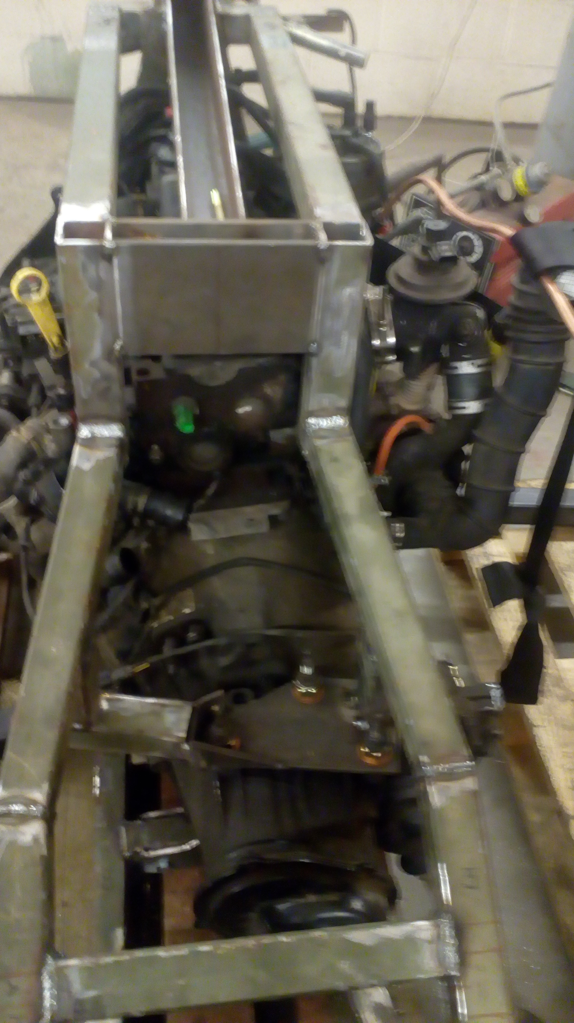

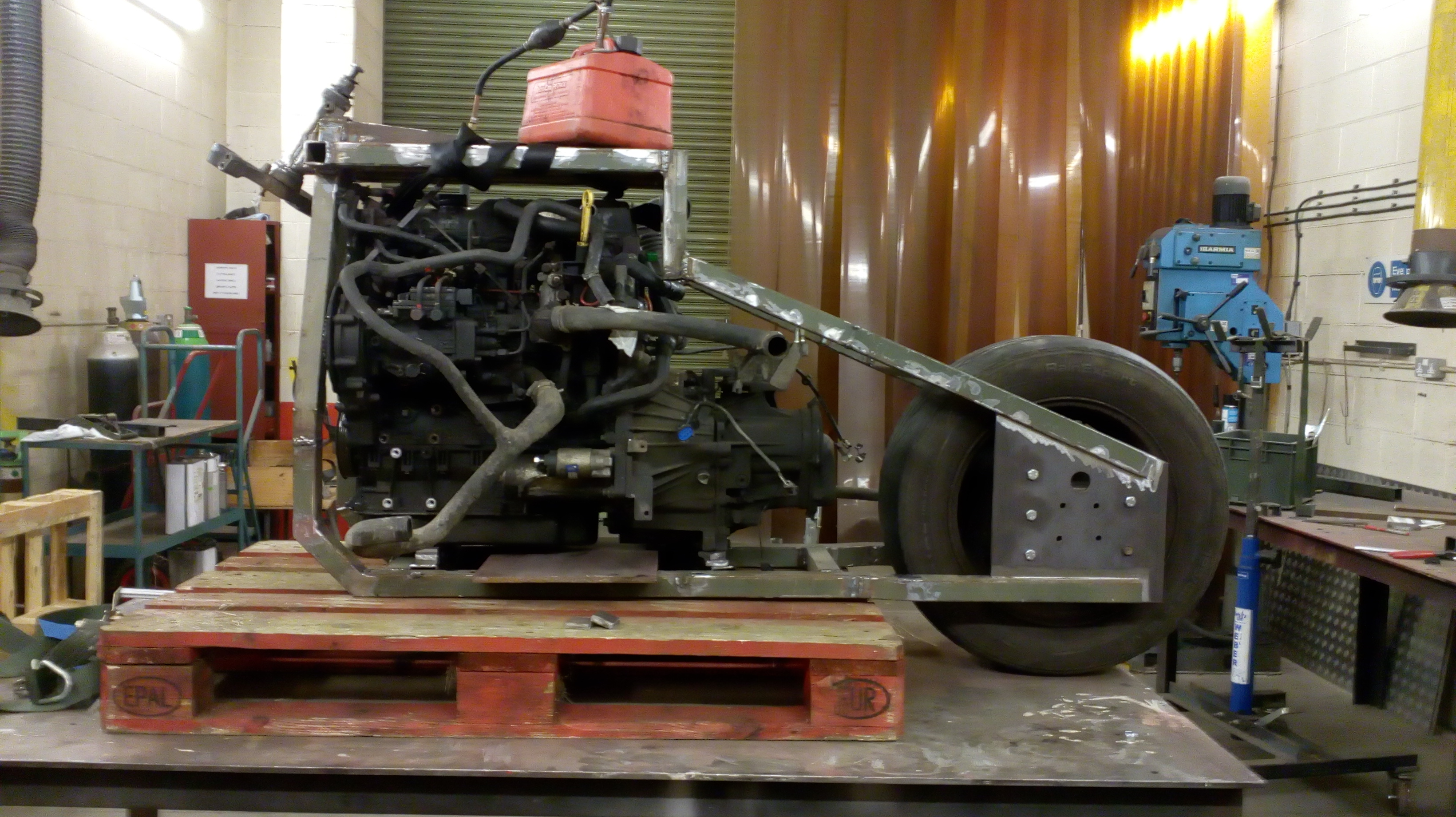

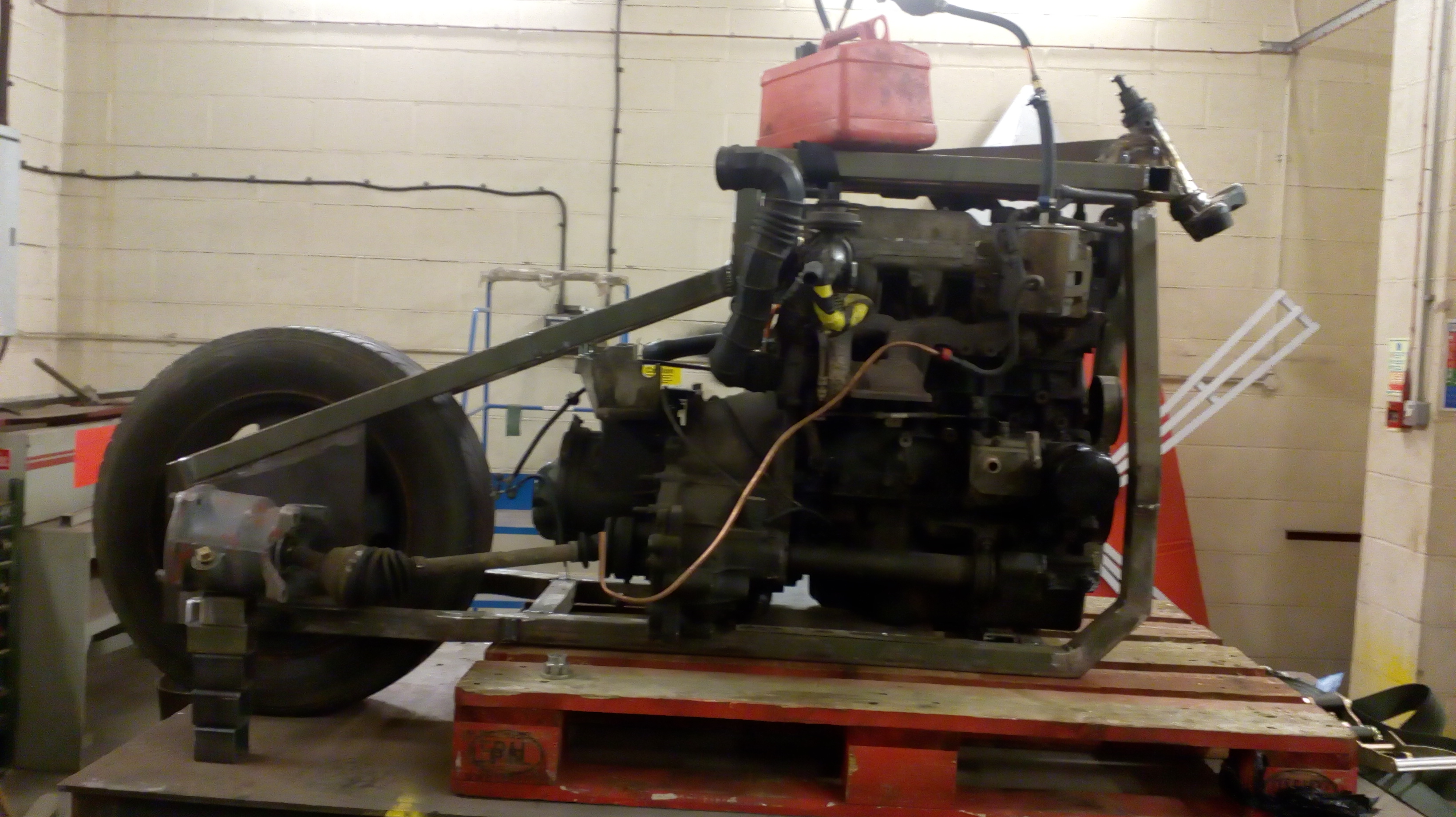

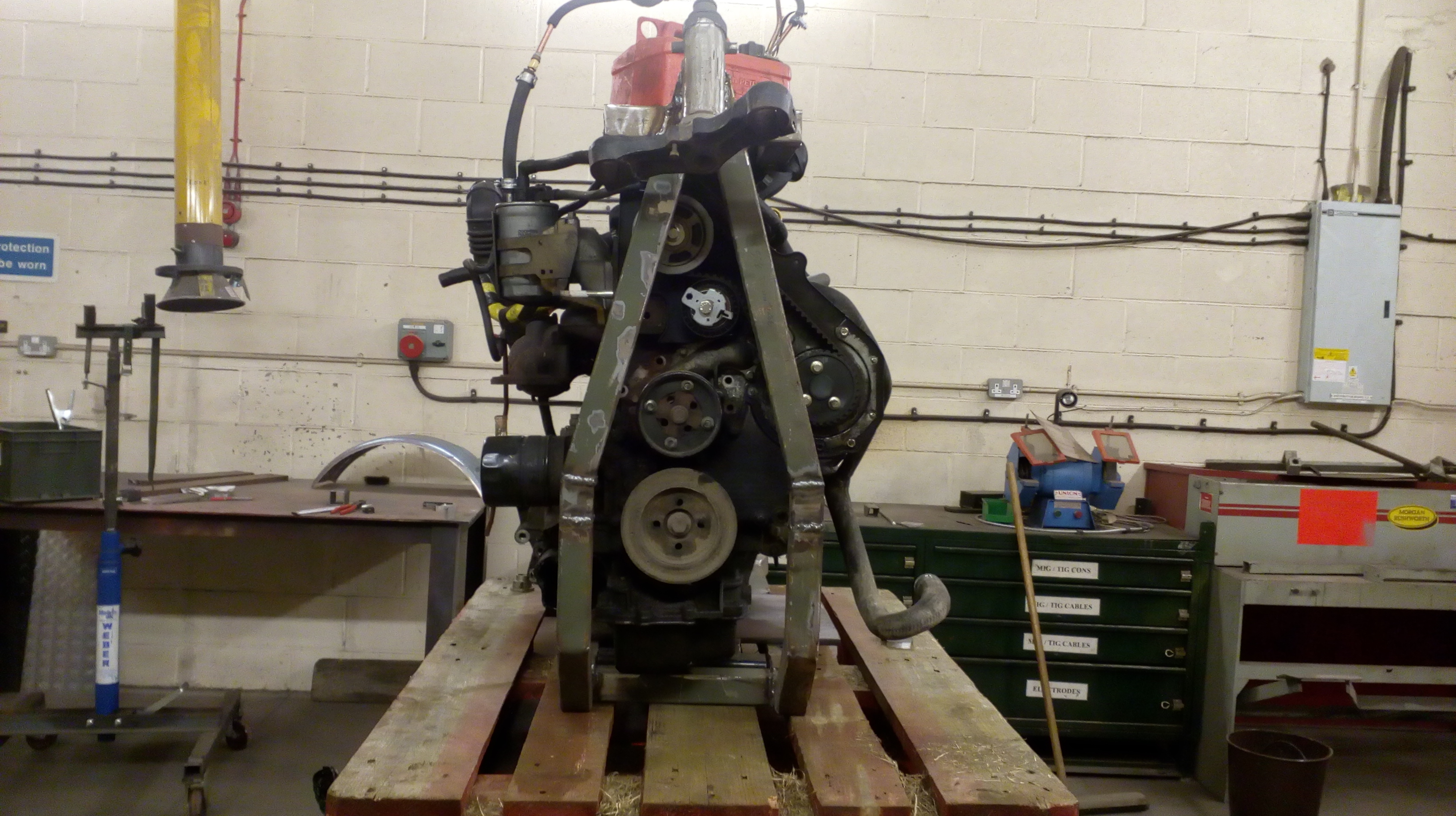

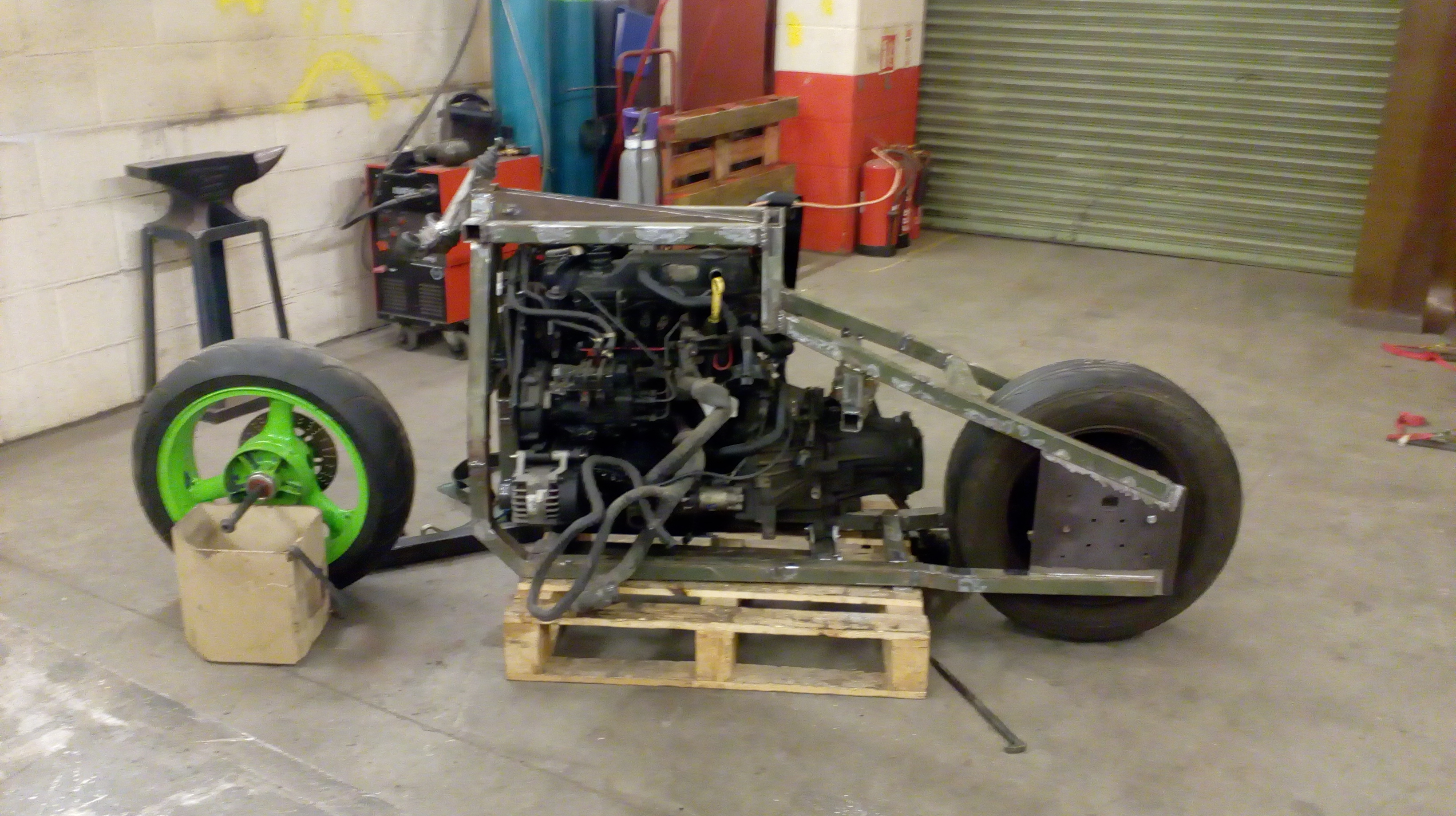

Well I have got the engine in the frame I still need the engine mounts but it’s in place I will make some mounts up tomorrow. It was not too bad to get in a little bit of planning I cut some 2” box section and made a pair of rails and 2 blocks between the frame rails it just slid in. Things are going far too smoothly I am expecting a problem to arise. :D

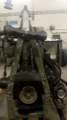

I have had a productive week in my spare time. My bike is coming along I have made some crude mounts for the engine although they are not finished yet. I may have to re-make the front mount with a bit thicker steel. But it is in all bolted down with a gap around everything. I thought I had come across a problem with my drive plans but I managed to find the part I needed it is on its way. I have ordered some bronze bushes for my fork pivots. I still have not decided on the design but I think the flintstones will be a good place to start. Next I will probably be making a seat for it. I want a vintage tractor type seat but don’t want to spend the money to buy it so I will have to make it. This will give me more time to think about forks. :D

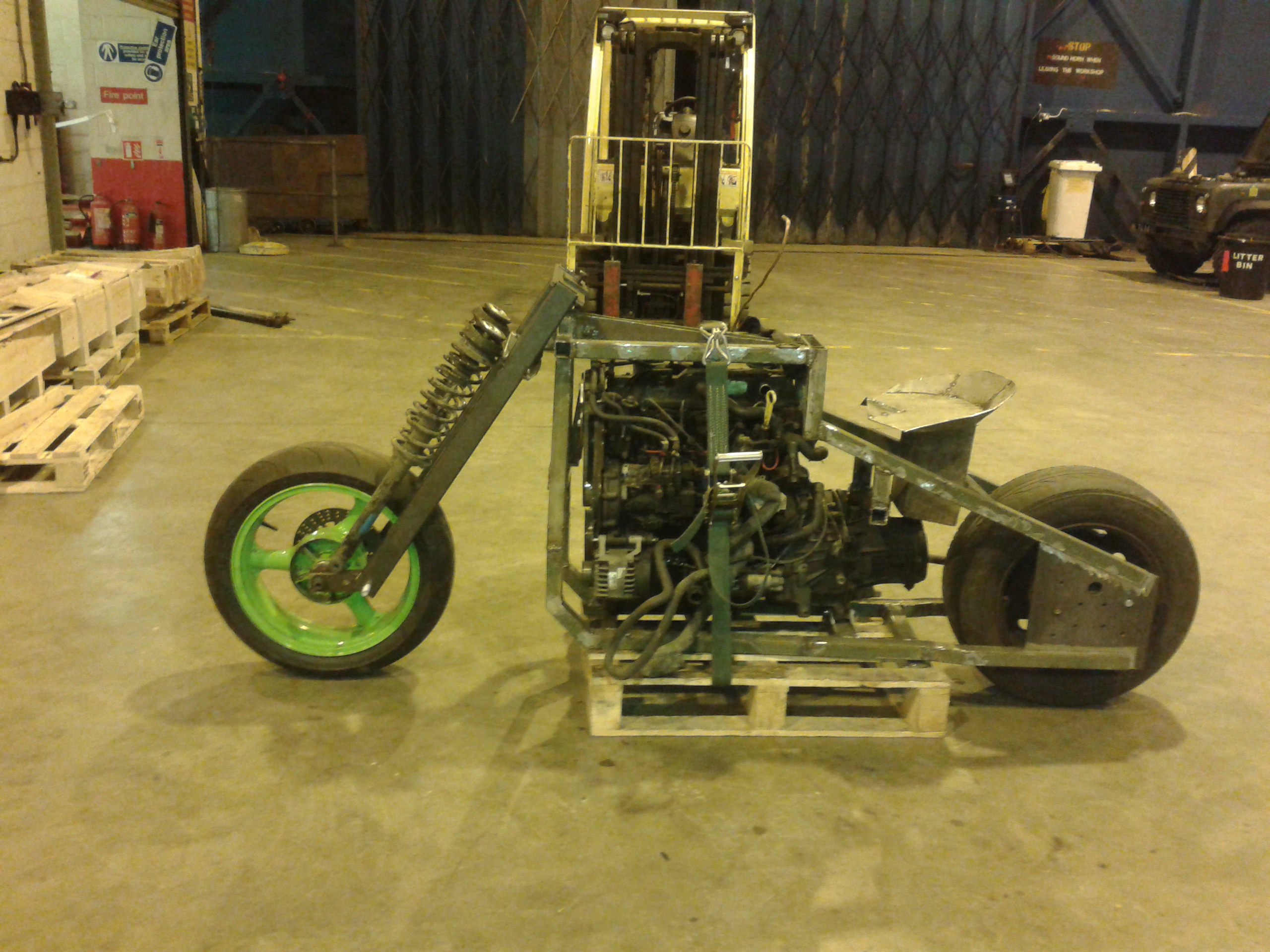

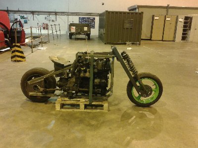

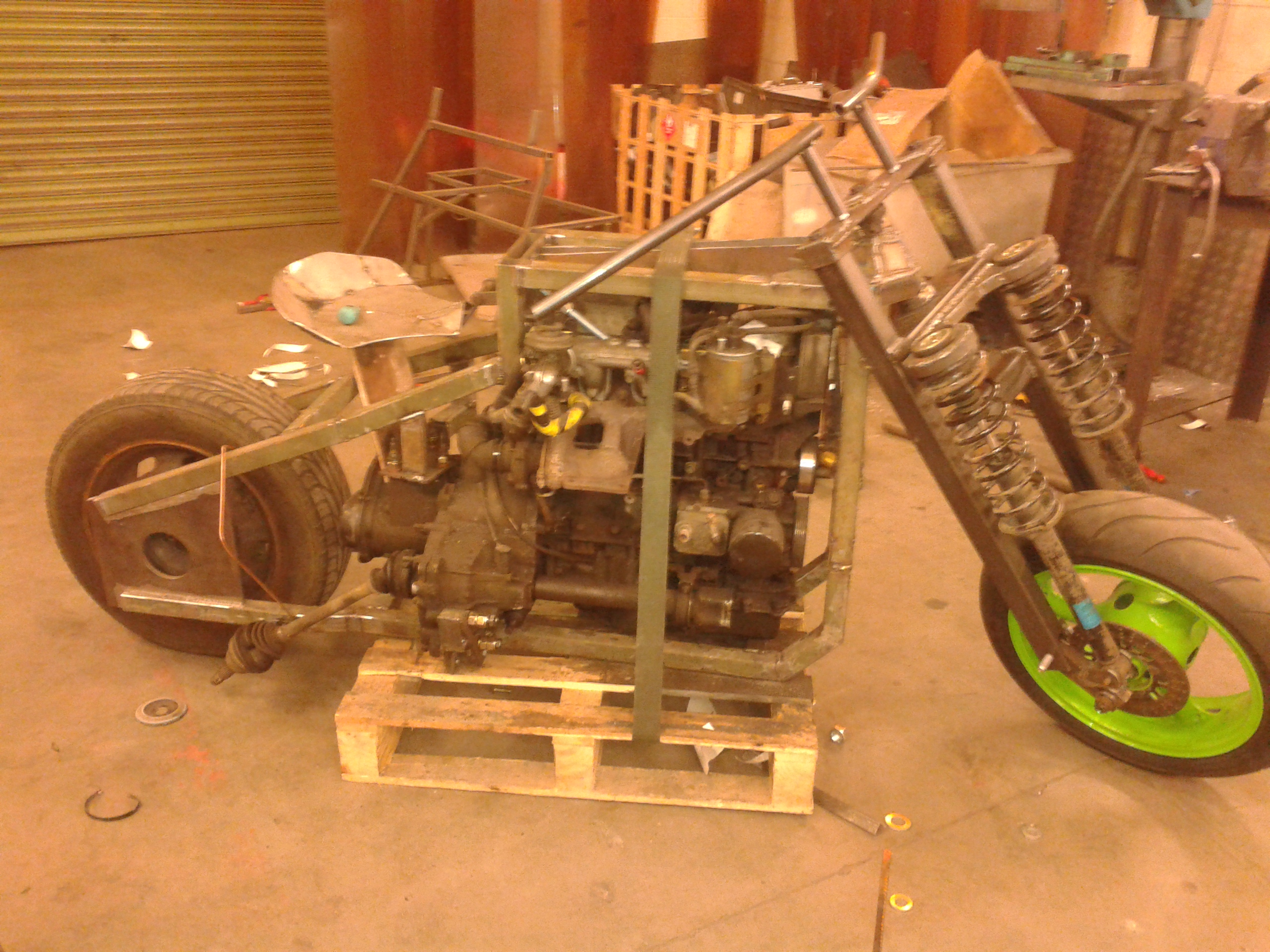

Not enough time for the build past couple of weeks but I have made a little progress I have thrown together a seat and started lookin into the driveshaft. I have decided to make a sort of springer front end. I have had big problems with my choice of steel for the bottom yoke I went for some 20mm x100mm plate I had been saving for the scrap man. It is plenty man enough but cutting the 30mm hole for the stem proved to be quite a problem. It took 2 attempts and 4 holesaws. I still have a fair few hours left on both yokes before I can make the rest of the forks. I have decided to use the fiesta rear struts for the front suspension. I have some bronze bushes for the main pivot. My main aim is to have the forks done end of the month. I have to work it all out and do the drawings today but I am hoping to be starting assembling the forks this week. I will post some photos when I have made some more progress. :D
the grinch
Posts: 91
Joined: Wed Mar 23, 2016 5:29 pm
Location: Abingdon
Re: The biginning of the heap of crap
Post by the grinch »

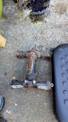

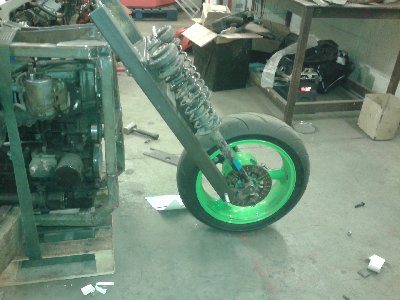

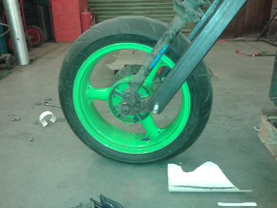

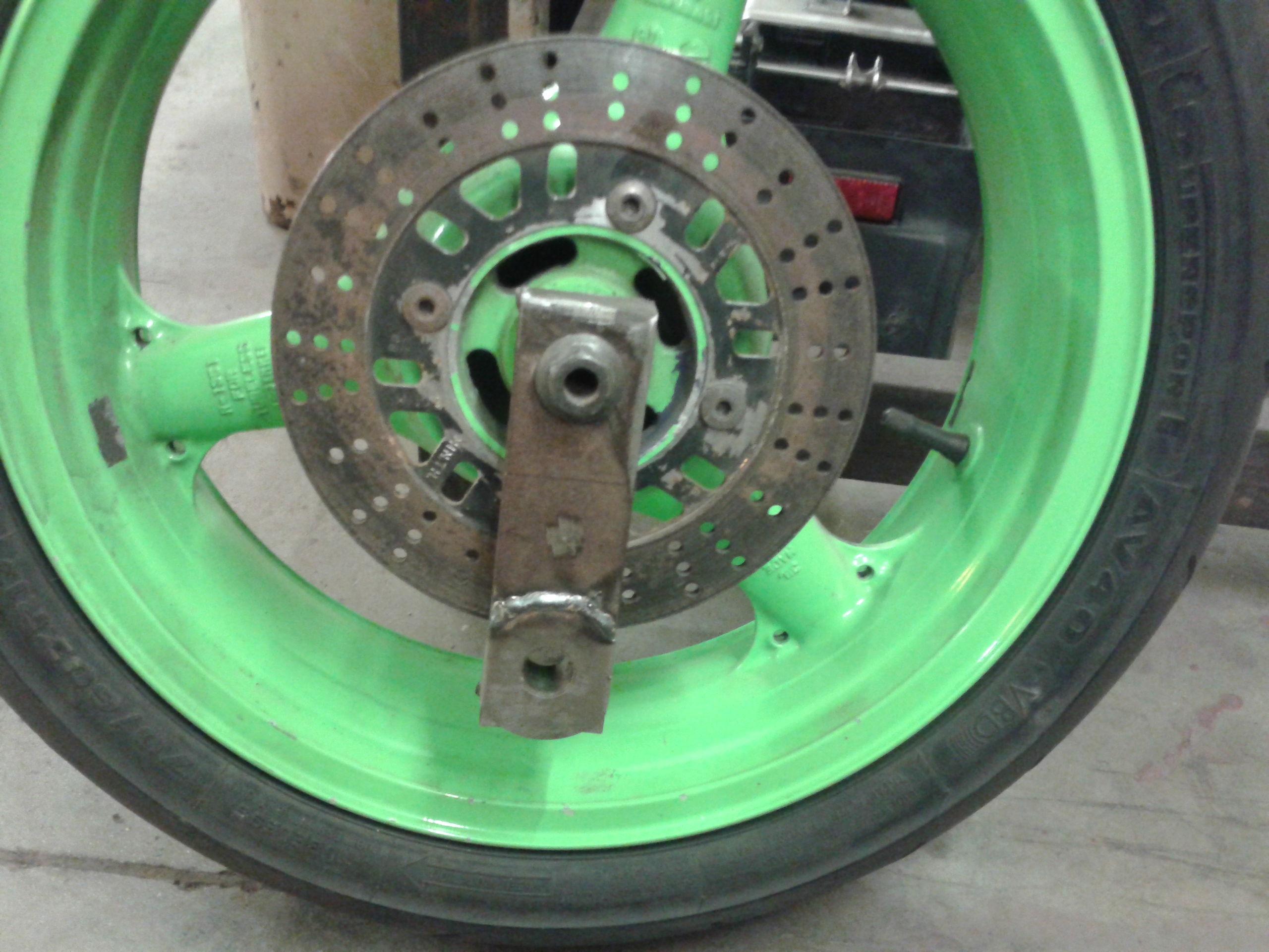

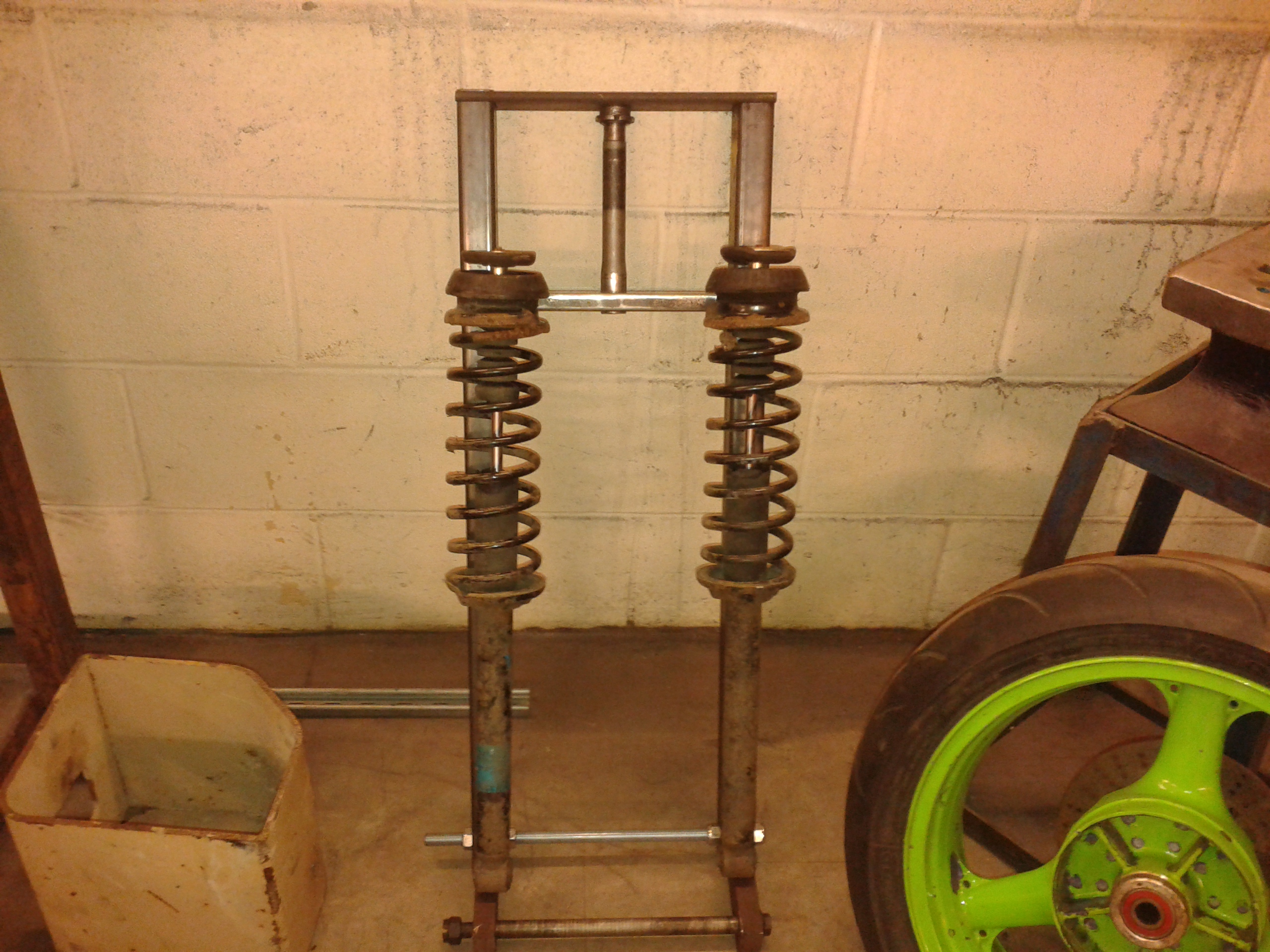

I done a bit last night I have roughly made my rockers for the forks and I have rough pair yokes.I still need to finish everything off but I think I will have my forks mocked up and finished sooner than I had planned. The car struts will be the quickest route and I don’t need to buy any bushes I will have a bit of a fiddle with the top mounts but I think it is going to be achievable. :D

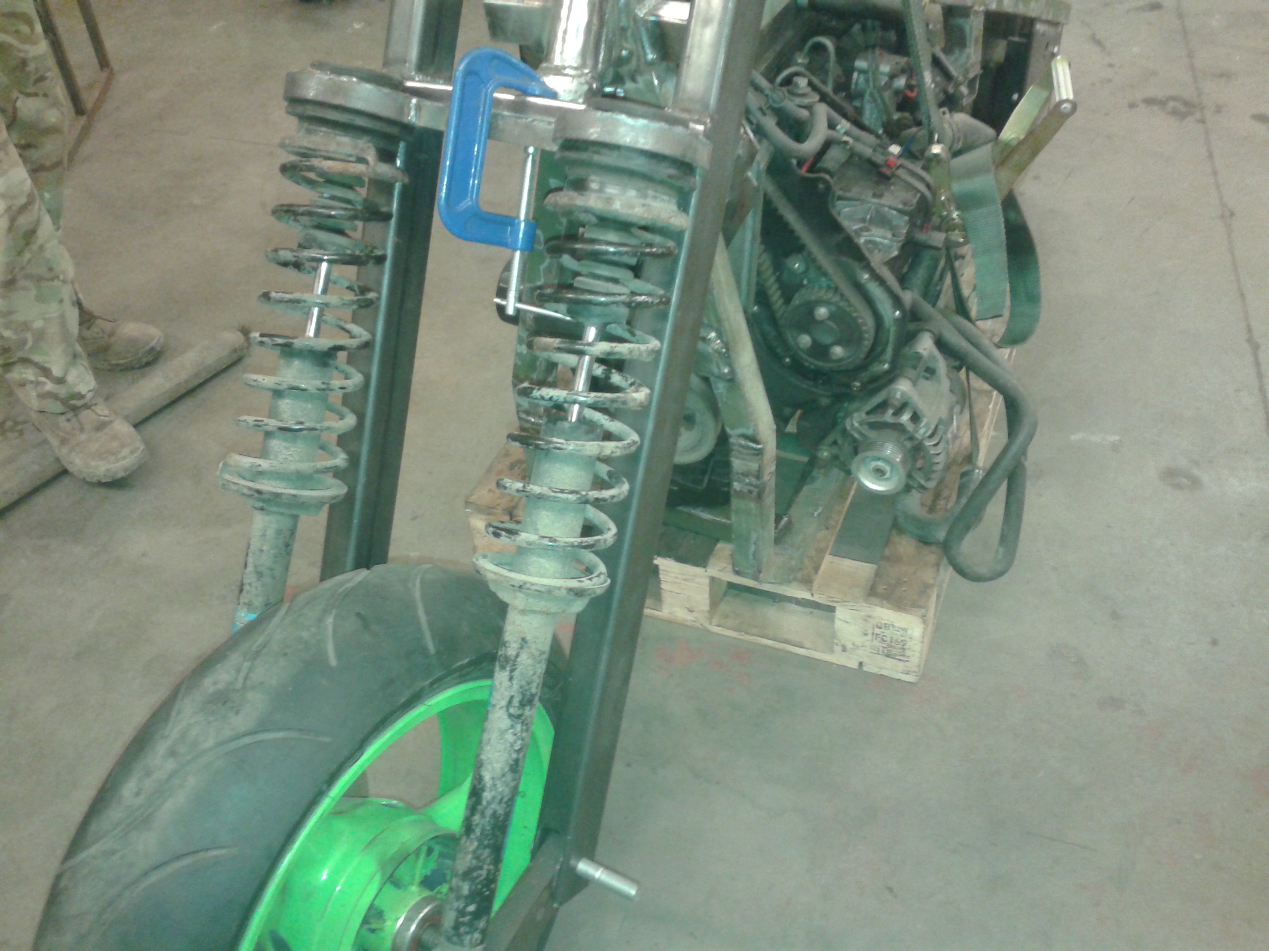

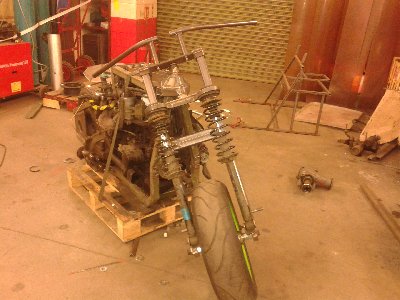

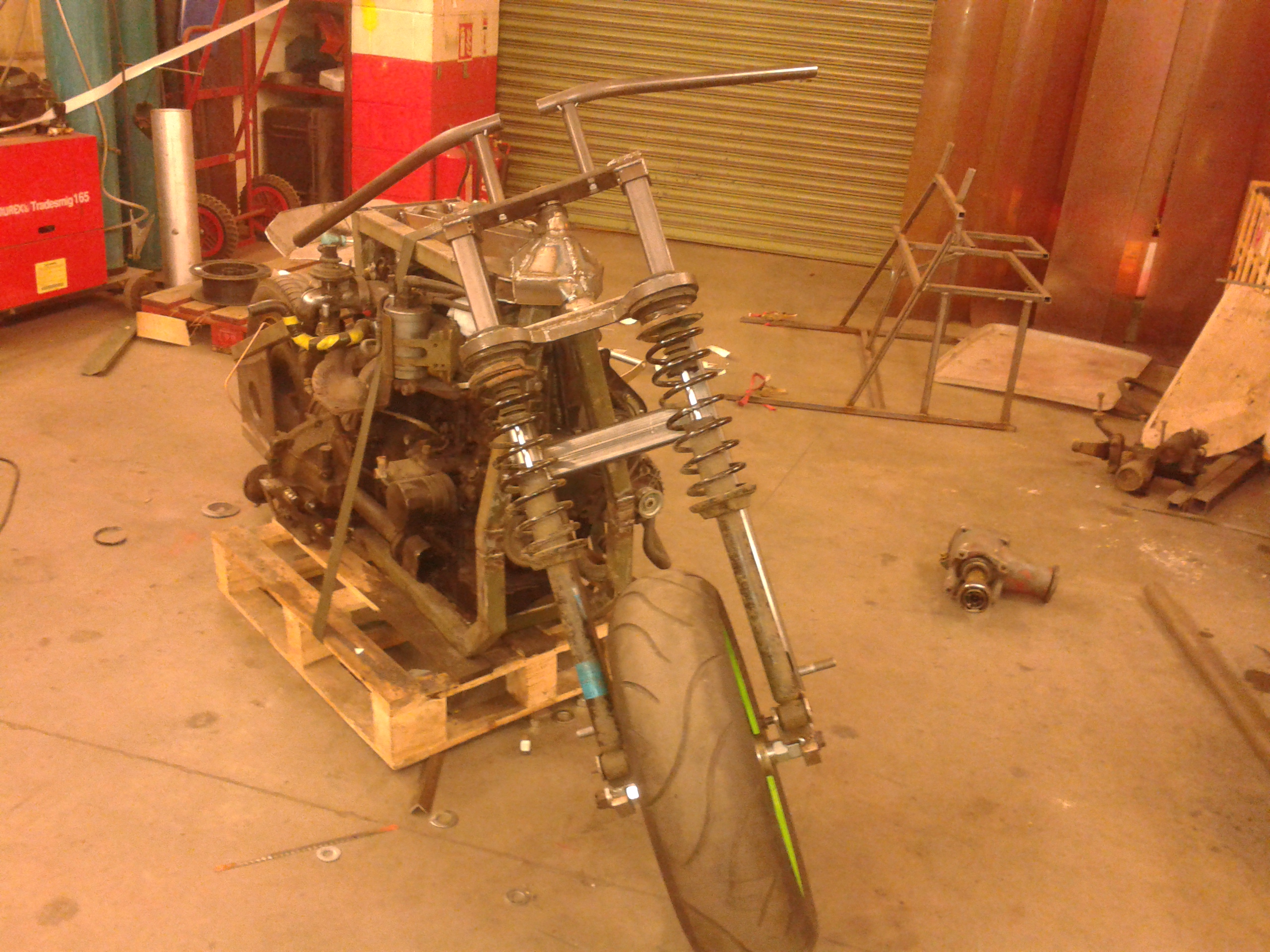

Forks
Ok I have been busy at work but I managed to get a bit of bike time in the evenings as some lads needed to do some cars, I finished the filling to get everything where I am happy. I am never going to get it perfect I know but as long as I can split a mm as small as possible that will do for me near enough is good enough. Forks have been quite a challenge but I mocked up and tack welded re checked my measurements then welded everything up. I am not interested in good looks as long as it is cheap and it works that will do. The car struts are going to save time as well as money I just have to mount them. My trail has worked out at just under 3” I wanted between 2” and 4” as this seemed to be the figure I could find for a side car outfit. I will need to put a brace under the bottom yoke I think there is quite a lenght of fork underneath I think it's better to beef it up than have to much flex. I will have room for 2 7” headlamps above the struts I have seen some at the bottom of the scrap skip so they will do for me I will find an excuse to empty it today and retrieve them.
Clutch well it is hydraulic going into the bell housing I have the master cylinder from the car it’s not that big I was thinking of a foot clutch maybe with a cable to control some sort of valve so I can put my foot down if needed. I’m thinking for the first test / death ride as it won’t have the side car to keep it up otherwise. As for the gears mouse I have still got to work that out but I have something in mind. The rod going into the gearbox has to go in and out to select gears as well as turn a bit to select the other set. I will probably use a rod to turn and a simple pivot to do the in and out bit. I have a 450 mile round day trip on my chopper to do soon If I haven’t sorted it by then I will have worked it out by the time I get back I do a lot of thinking on my road trips. I try not to start anything without being sure in my mind it will work I have limited time if I plan everything well I can get it done quicker. :D

I saw a man in VA use the telescoping front suspension from an expensive BMX type bicycle in the same way on a 500cc Honda single !
Worked very well !!

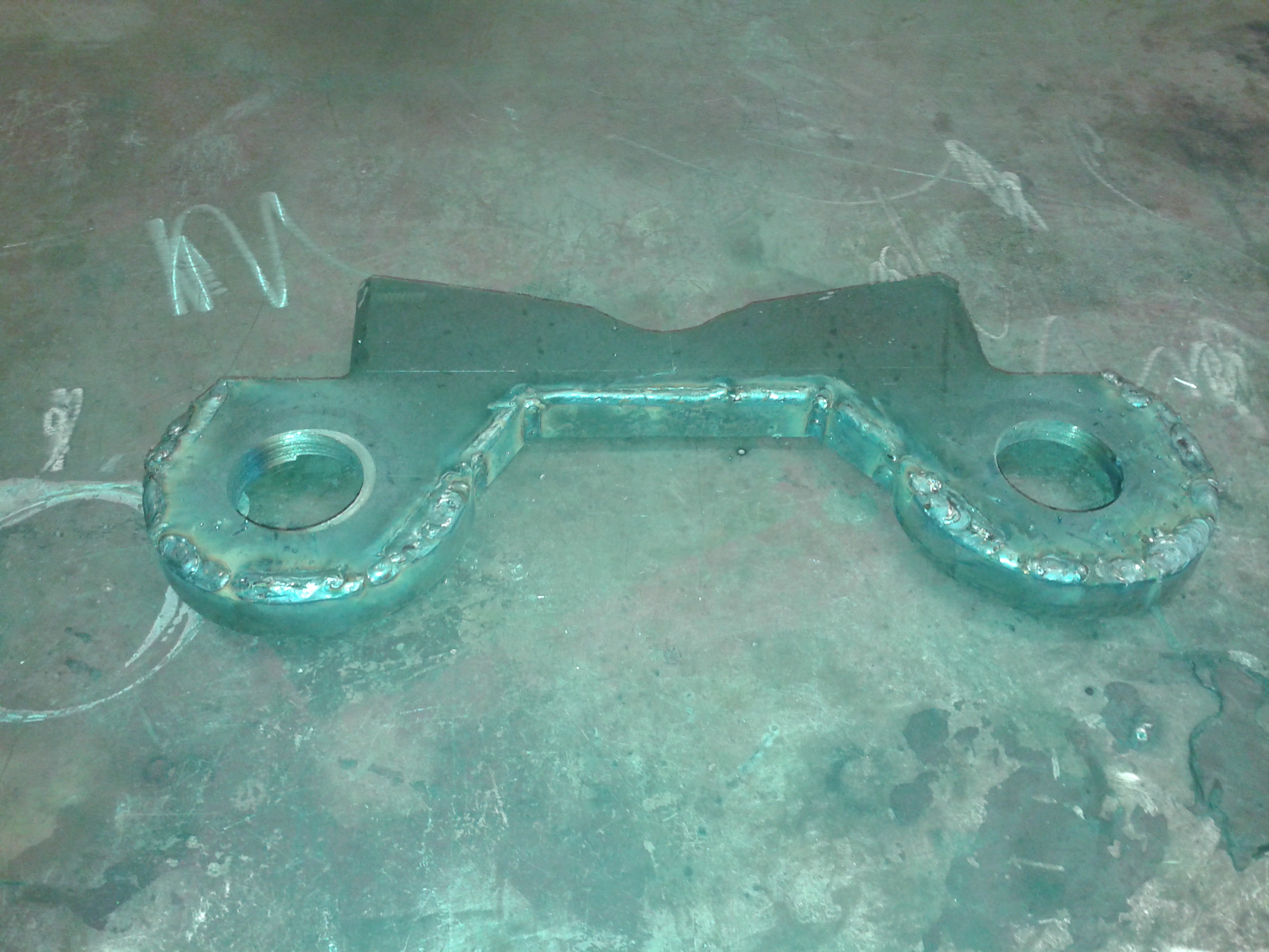

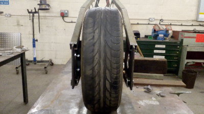

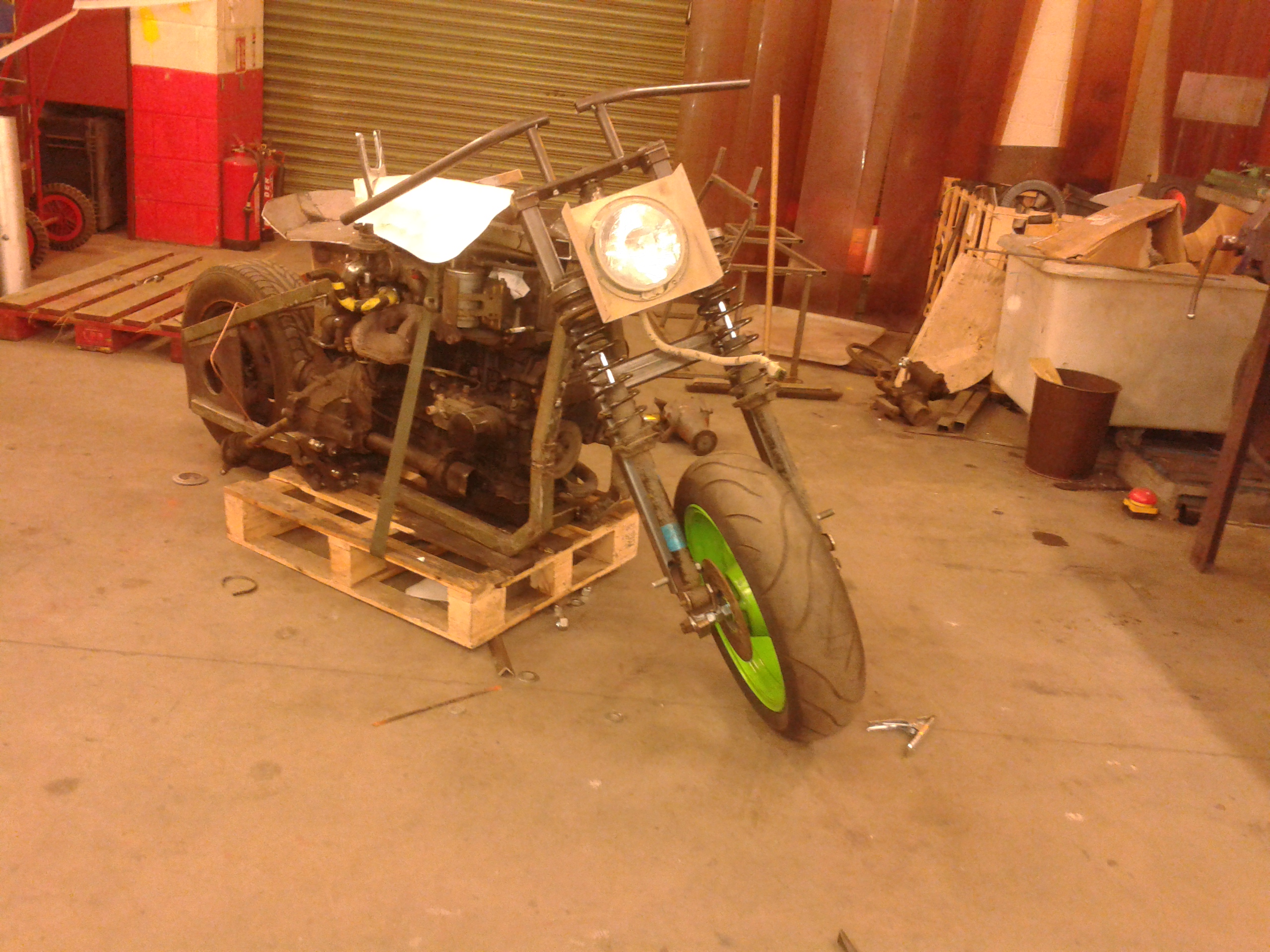

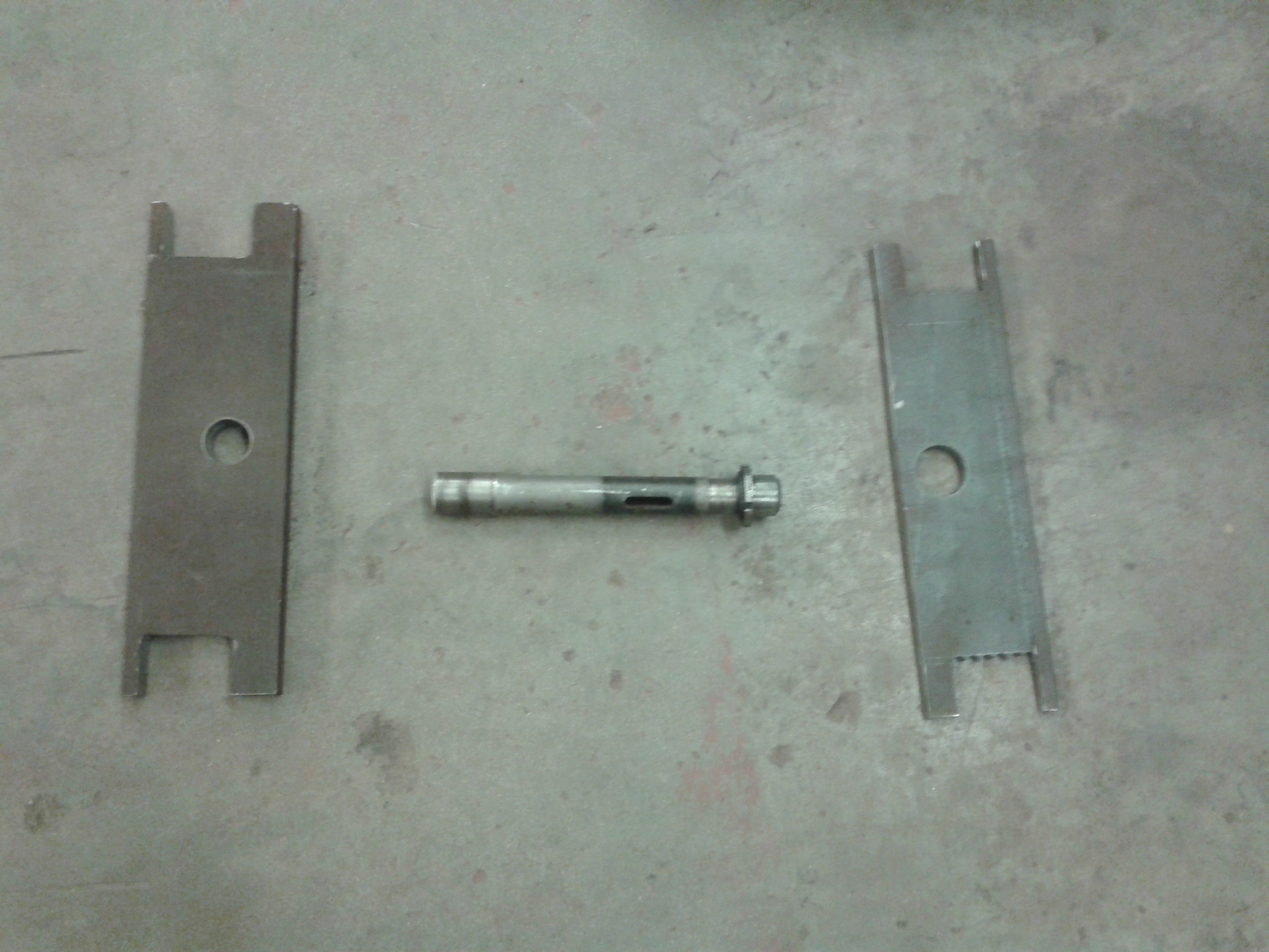

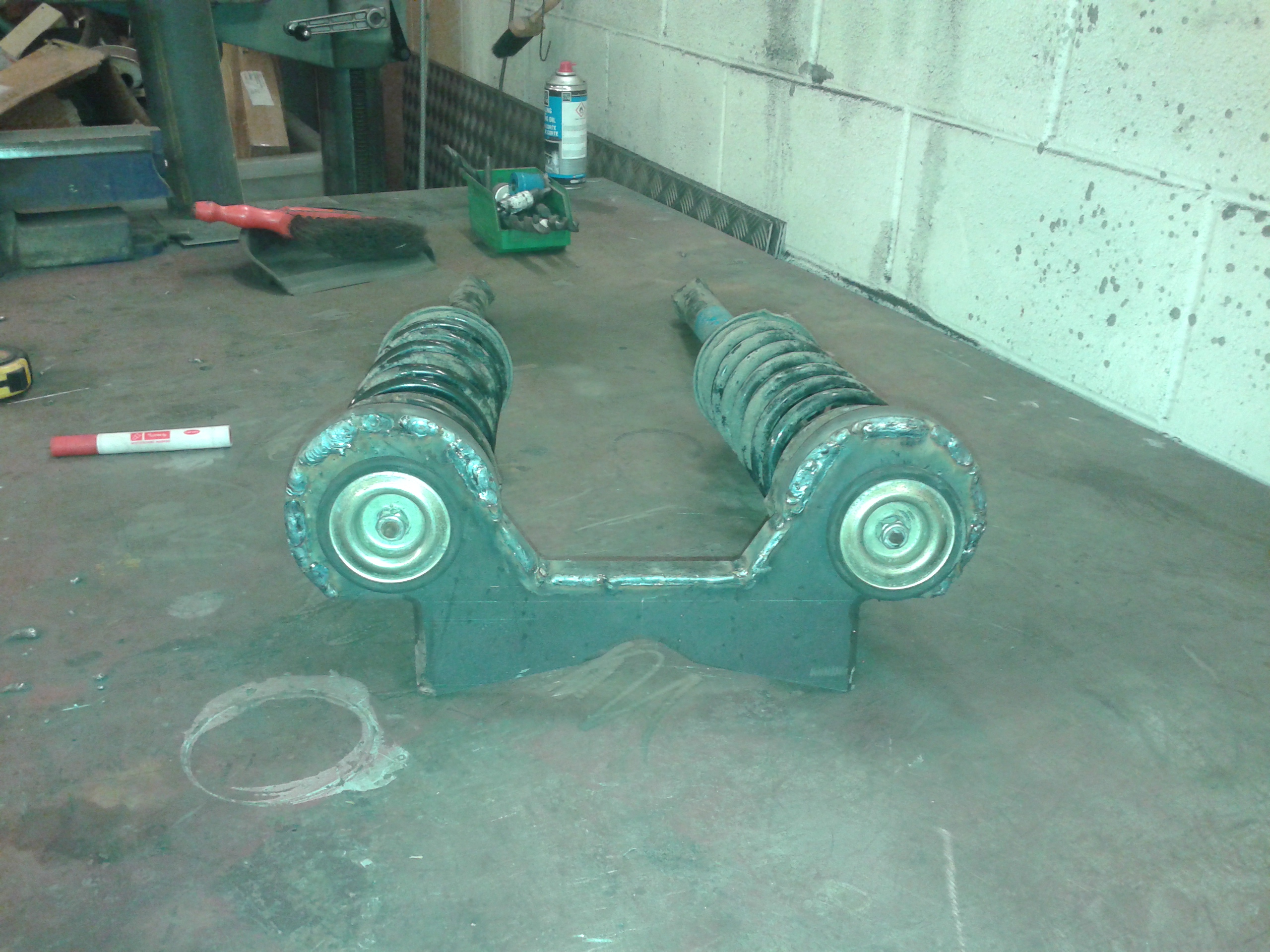

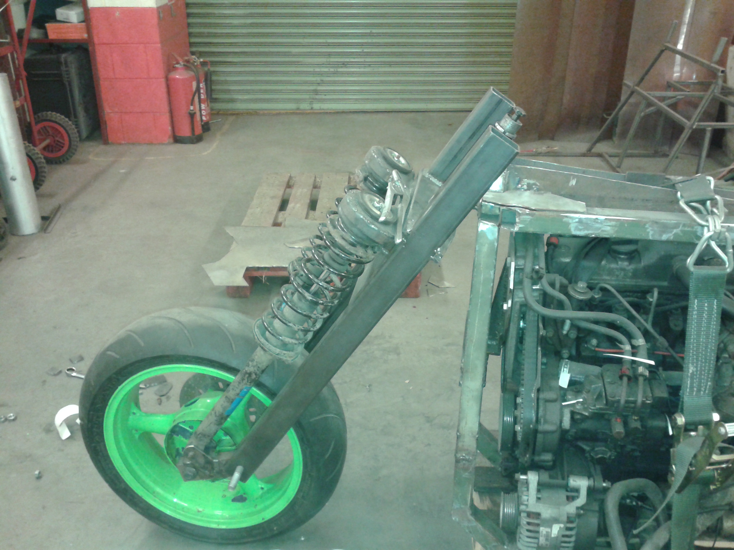

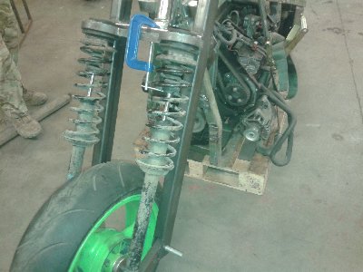

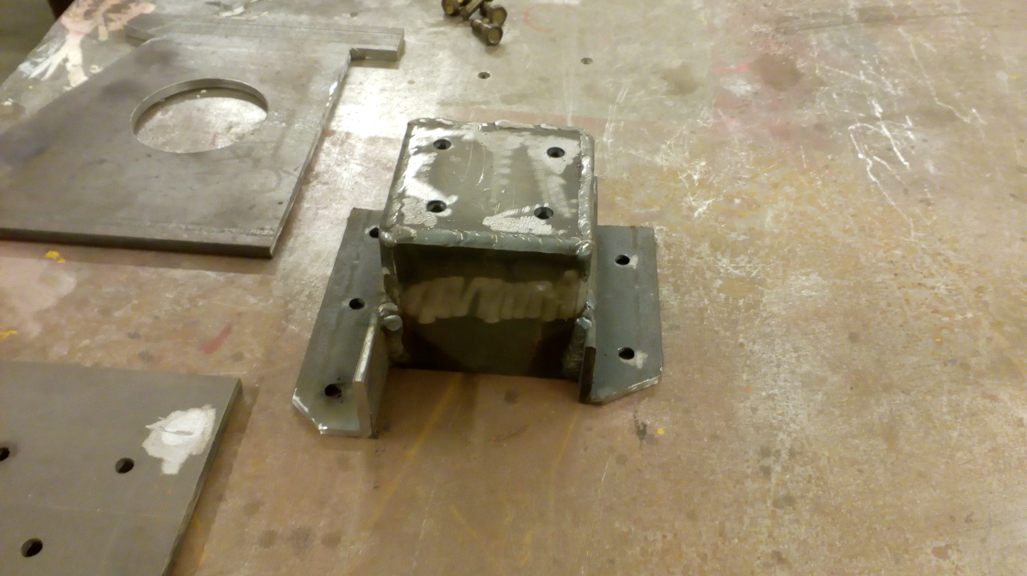

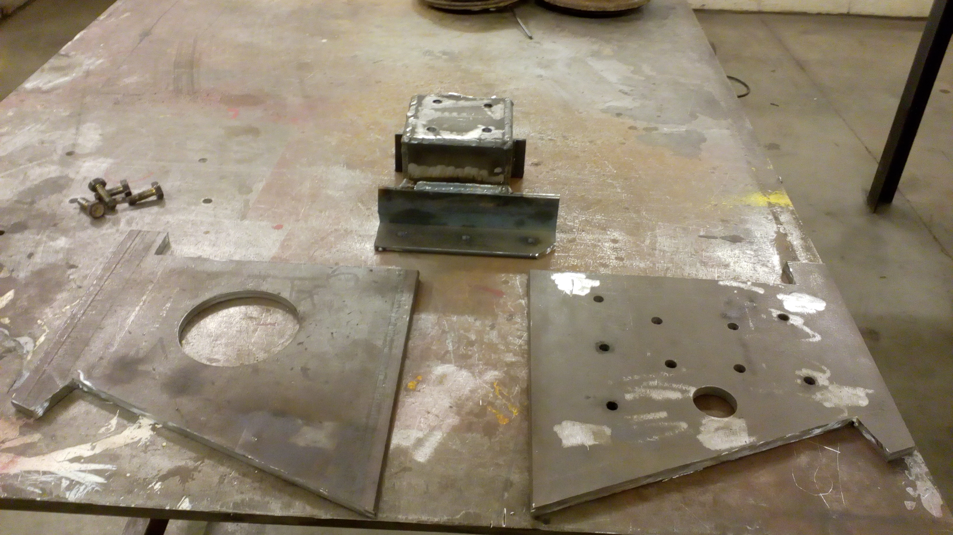

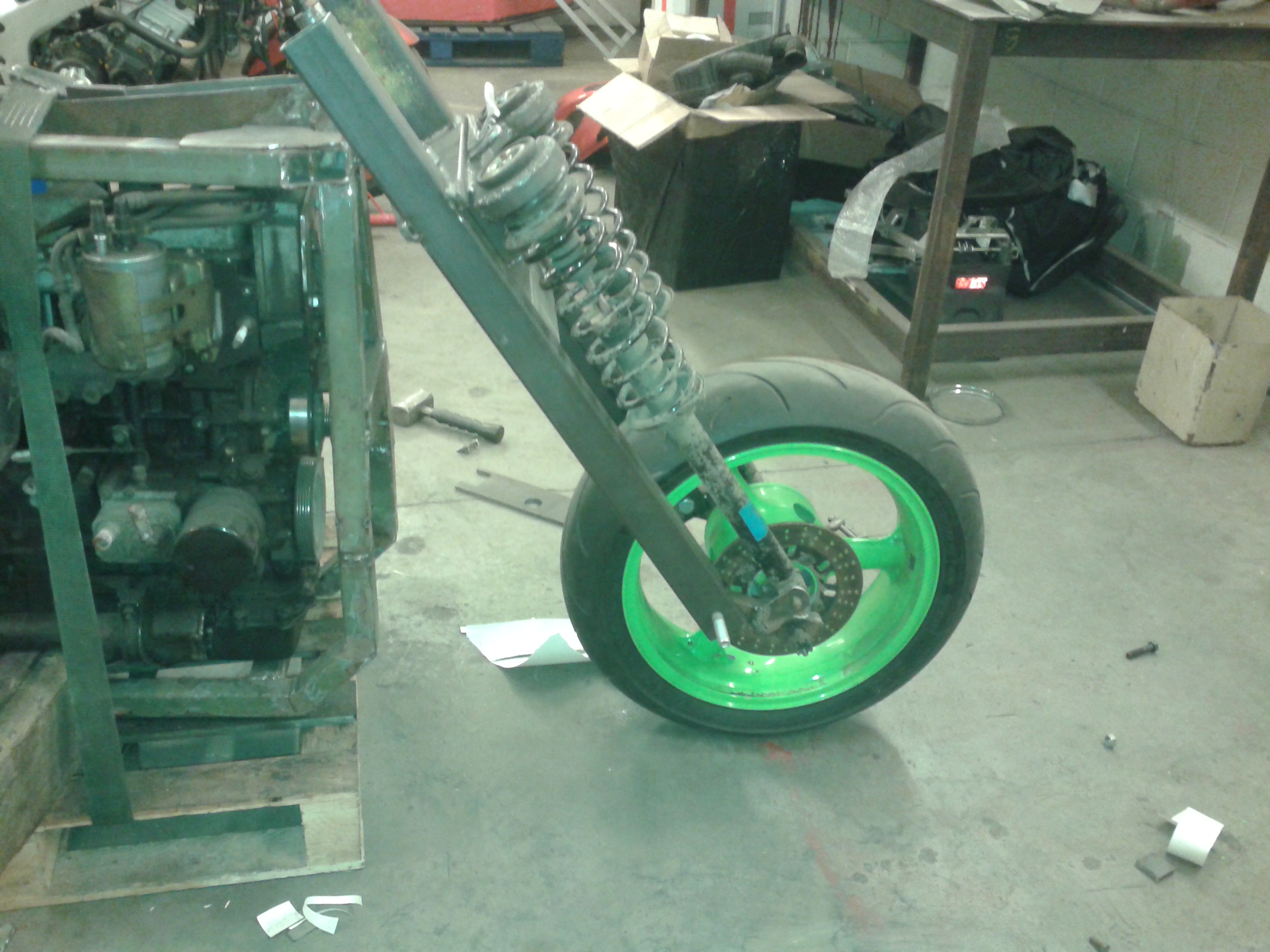

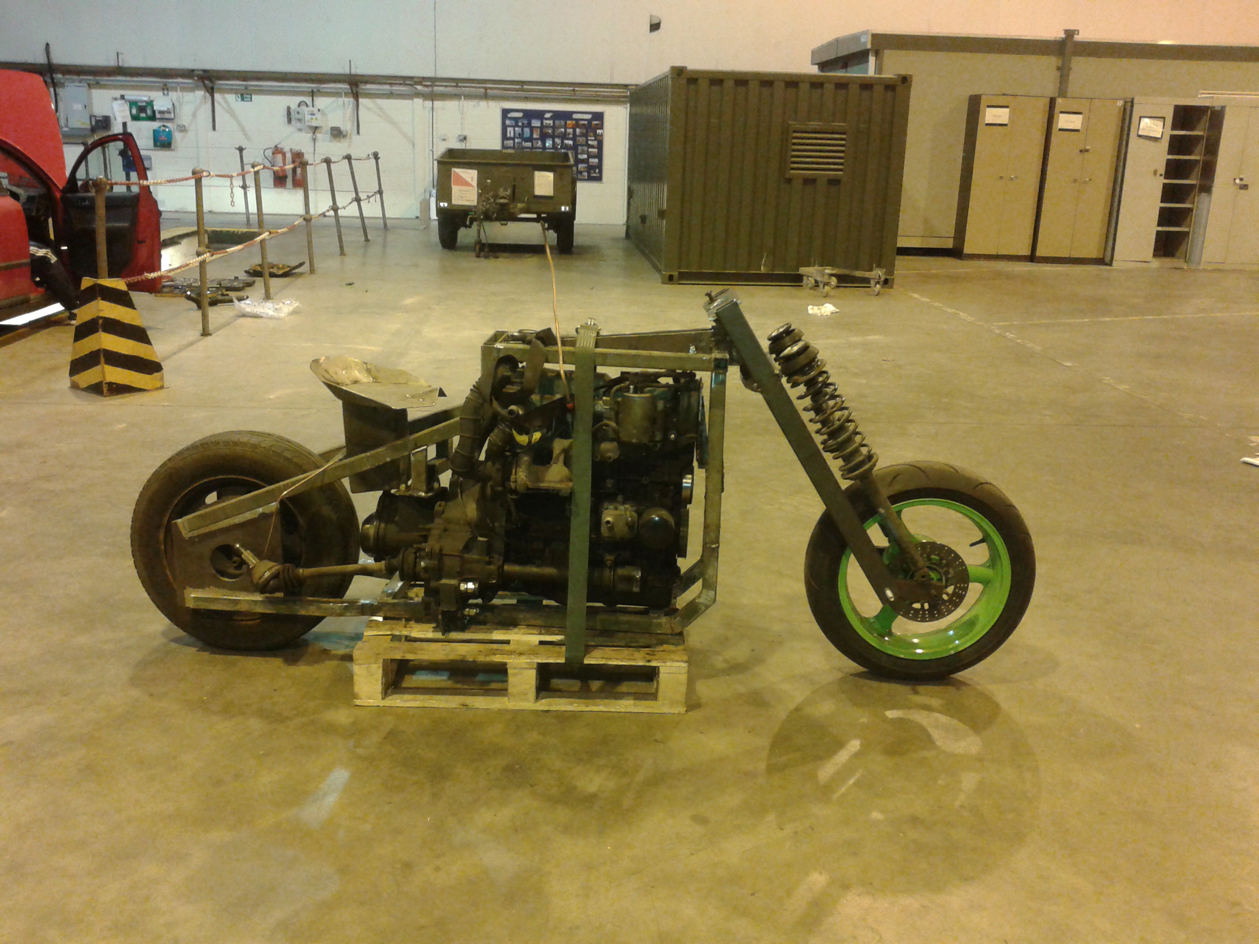

I have started the mount for the struts it was fairly straight forward the hardest part was cutting the plate I have to tidy them up but I have offered them up and they look ok. I will try to weld them in place sometime this weekend. I have the bottom mount to make but that will be ok I will probably use some angle iron and a bit of plate. Hopefully it won’t be long now and it will be rolling. :D :D :D :D
the grinch
Posts: 91
Location: Abingdon

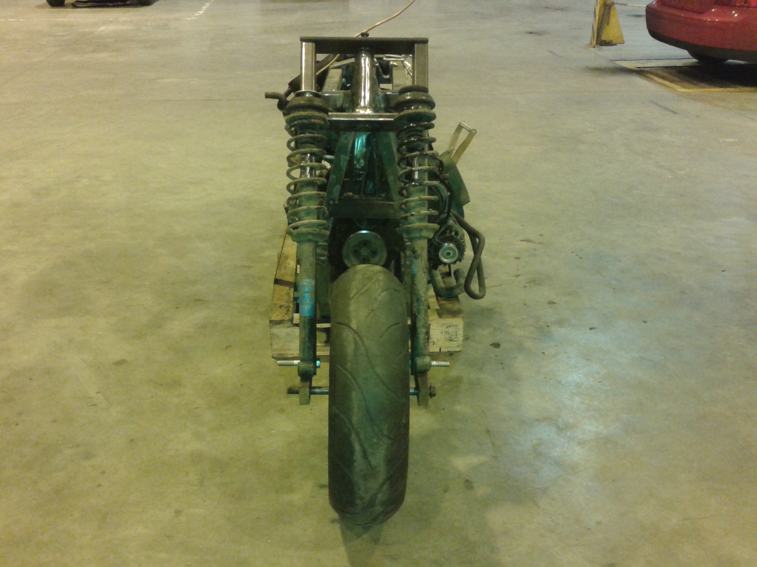

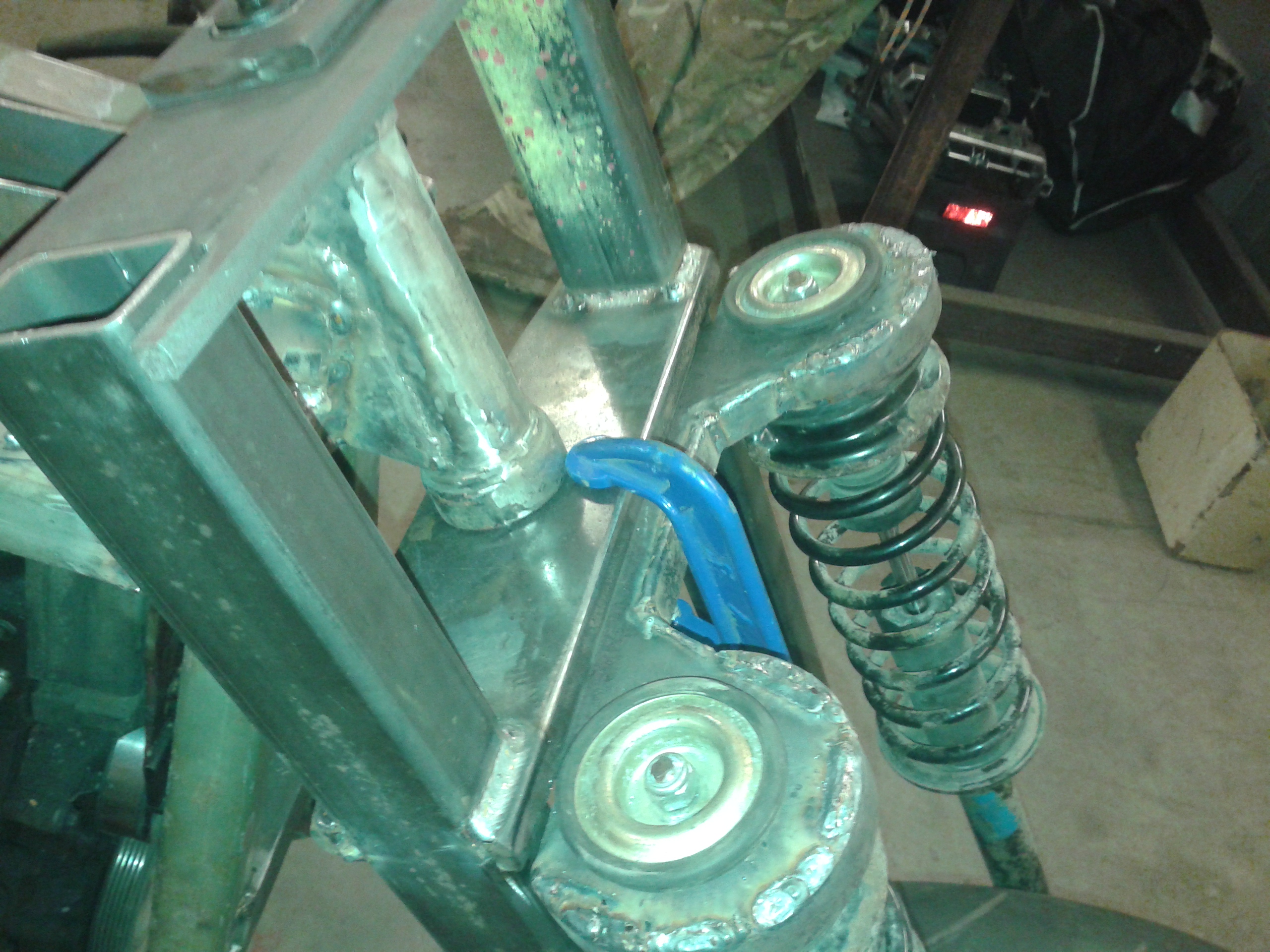

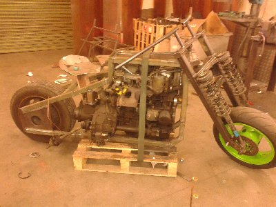

It’s rolling :D :D :D :D

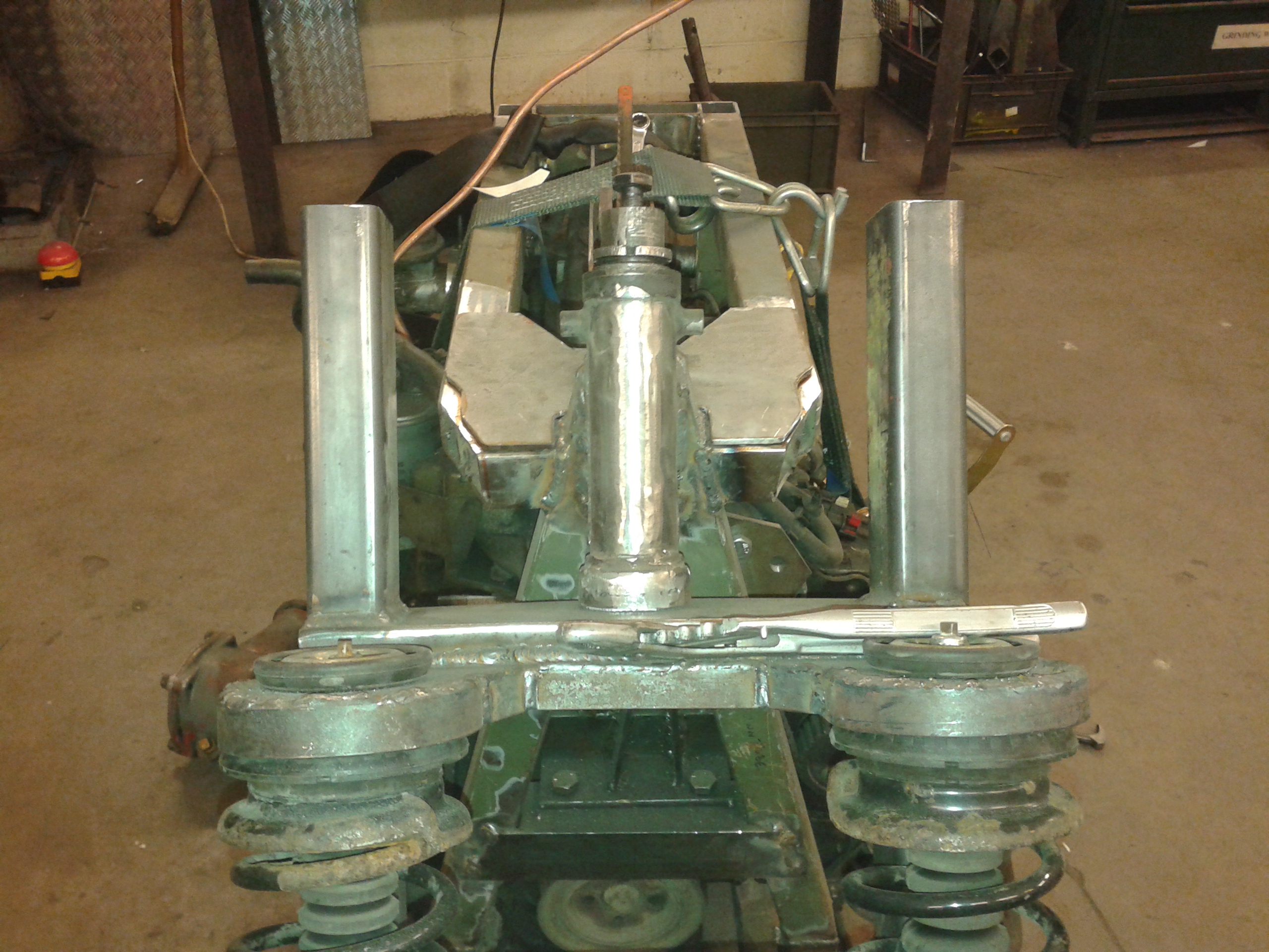

I have welded the top mounts and made the bottom mounts all welded up and put together. I had a bit of a job with the top mount and I had to put a brace in the forks as it pulled in about an inch as it was welded but I jacked it all out with a piece of threaded bar and put the brace in it has worked ok. I thought I would have an issue with the wheel spindle due to this but in the end everything came out ok the spindle went straight in. It is sitting level on the springs I was surprised as I didn’t measure that bit. I could compress a strut it about 1.5” with my weight so I thought 4” then it was just convenient that it went under the bottom yoke. Next I am going to do the gussets and strengthen the top of the frame by the neck. :D

I have got a bit more done i strengthened the neck , finished off the top fork mounts I just have to put a pinch bolt for the head bearing adjustment and a piece of flat across the front . It is still going a bit slow I am not getting enough time on it but as long as I make a little progress each time it’s better than nothing. I want to be finished the mock up before end of June I still have to weld some gussets around the frame before I strip it down. I have put the seat in place. I intend to house all the electrics and clutch mechanism underneath it. I have an air spring to go under the seat. I made a rough set of handlebars for the initial fitting. I have worked out roughly where the footrests will go feels ok I thought I may need to move the turbo but I think its ok now everything is coming together. The fuel tank will be my next bit to do it won’t be very big 2-3 gallon will do as I will be having a Jerry can for the main fuel tank by the rear wheel. I think I may be able to cheat a bit as I have a CB250 dream tank in the garage that I have been saving for a project or I will make it from scratch whatever is quickest but I will make that call when I get to it. I have a lot on now at work and also I am helping wife break a horse so it may be some time before I update but as soon as I can I will be on again as I can’t afford the project to stall due to my deadline to be on the road for ride to the wall this year. :D :D

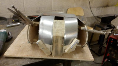

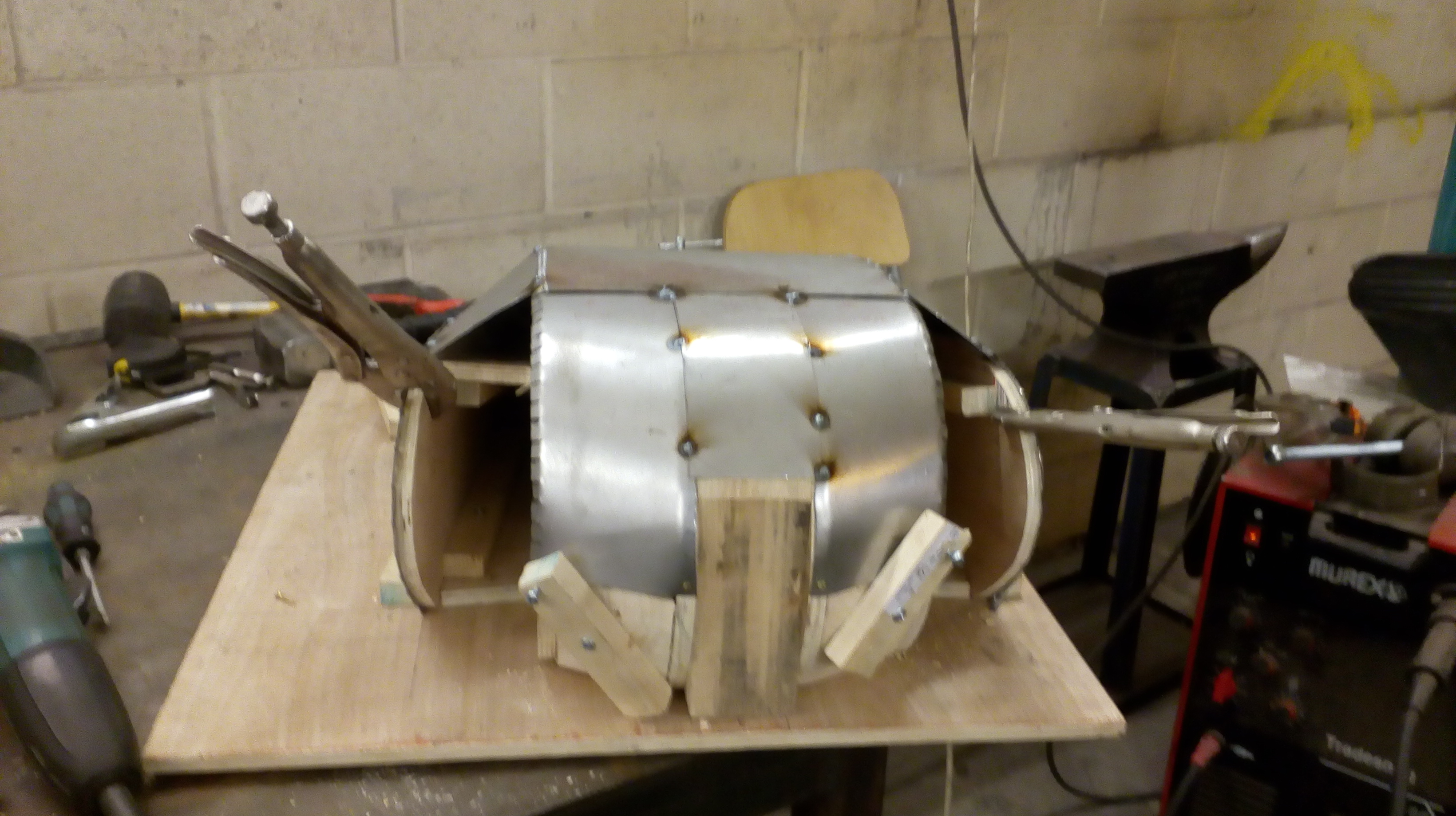

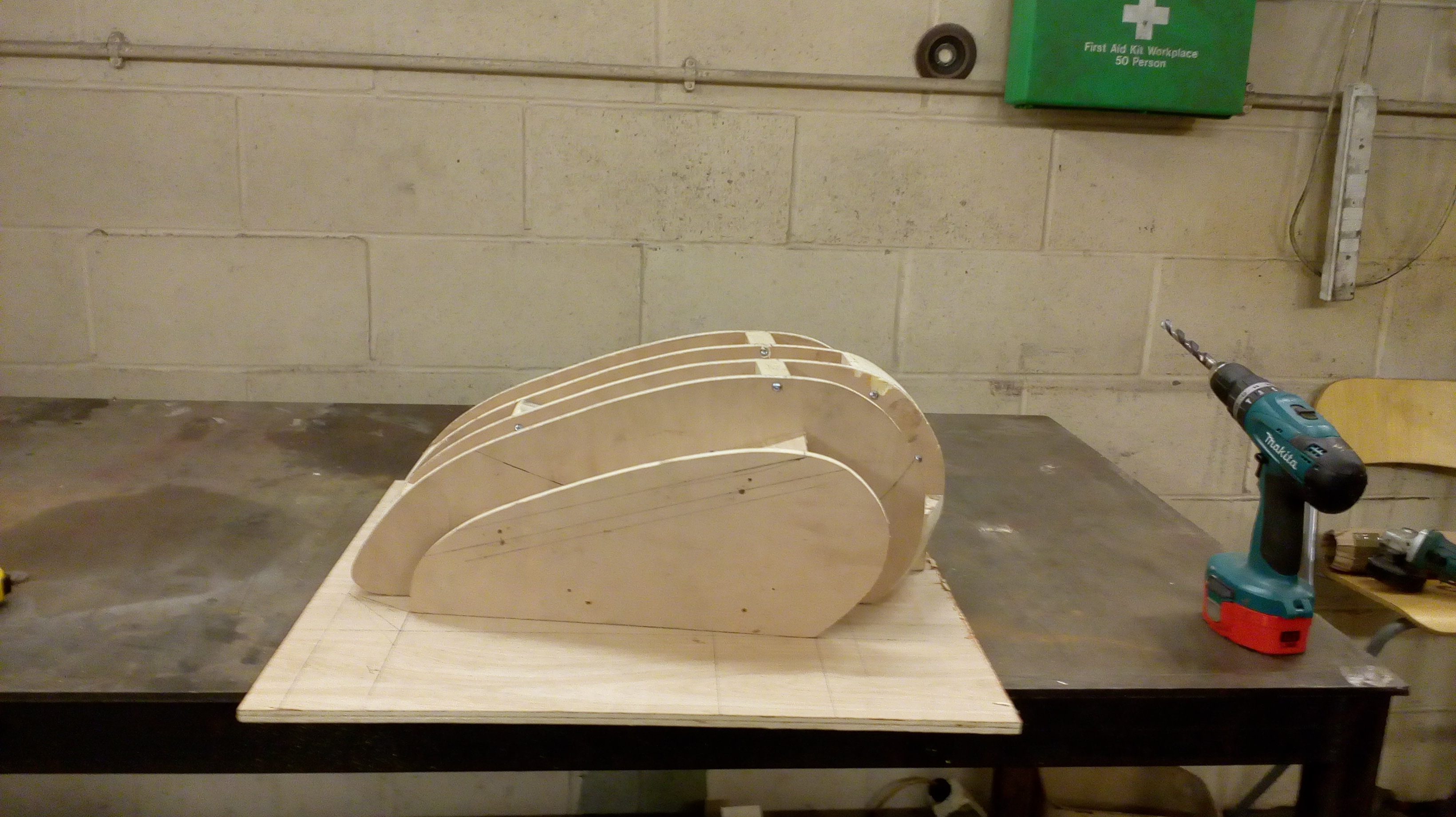

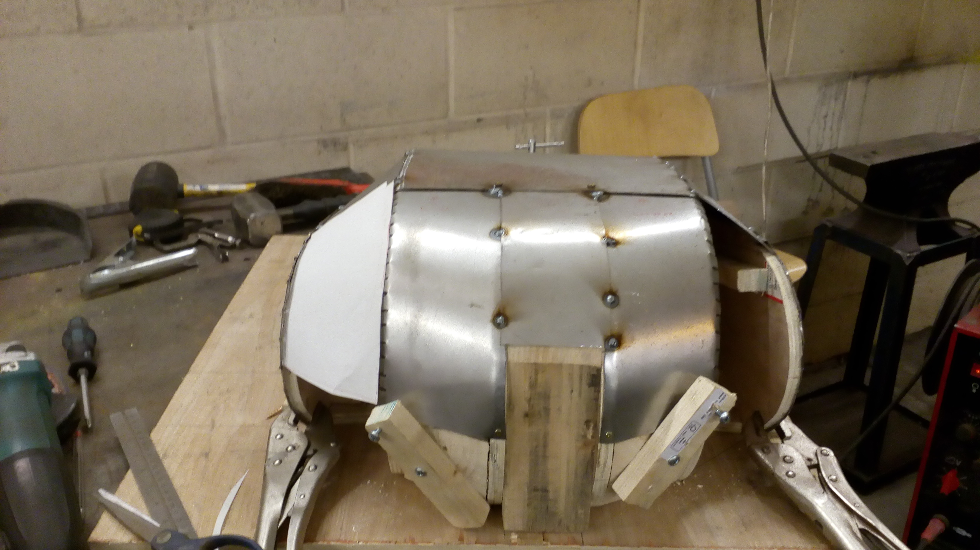

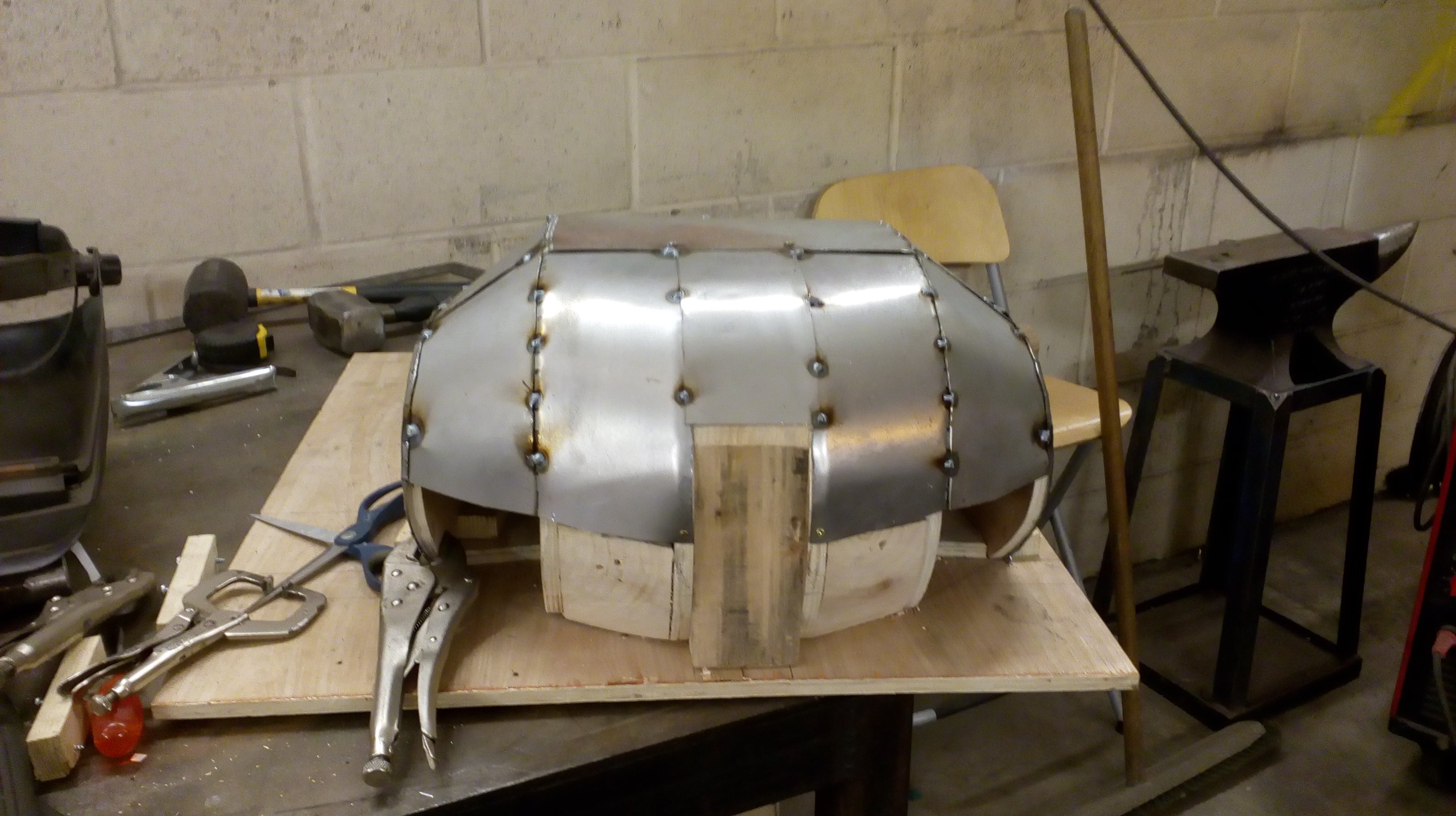

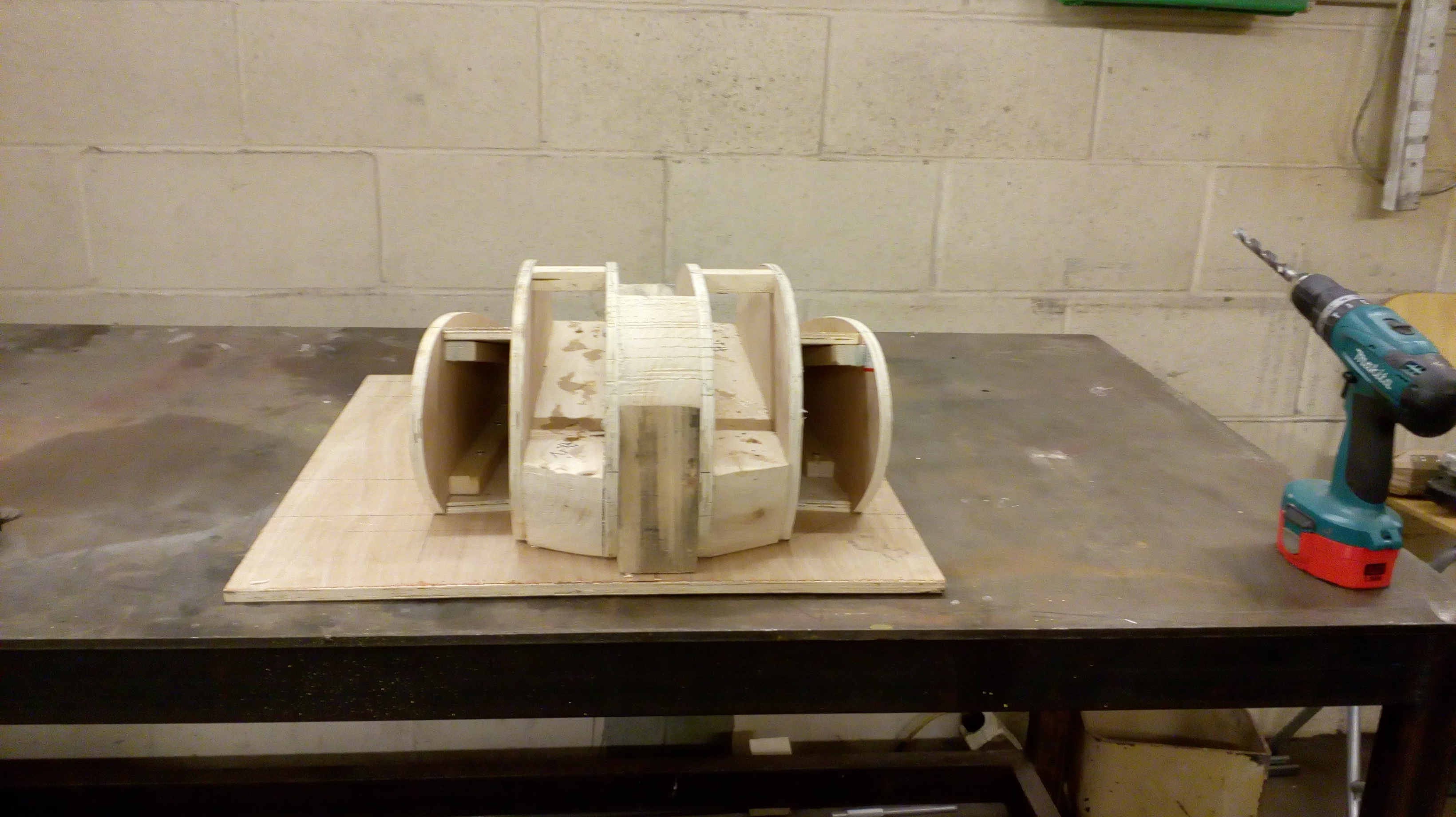

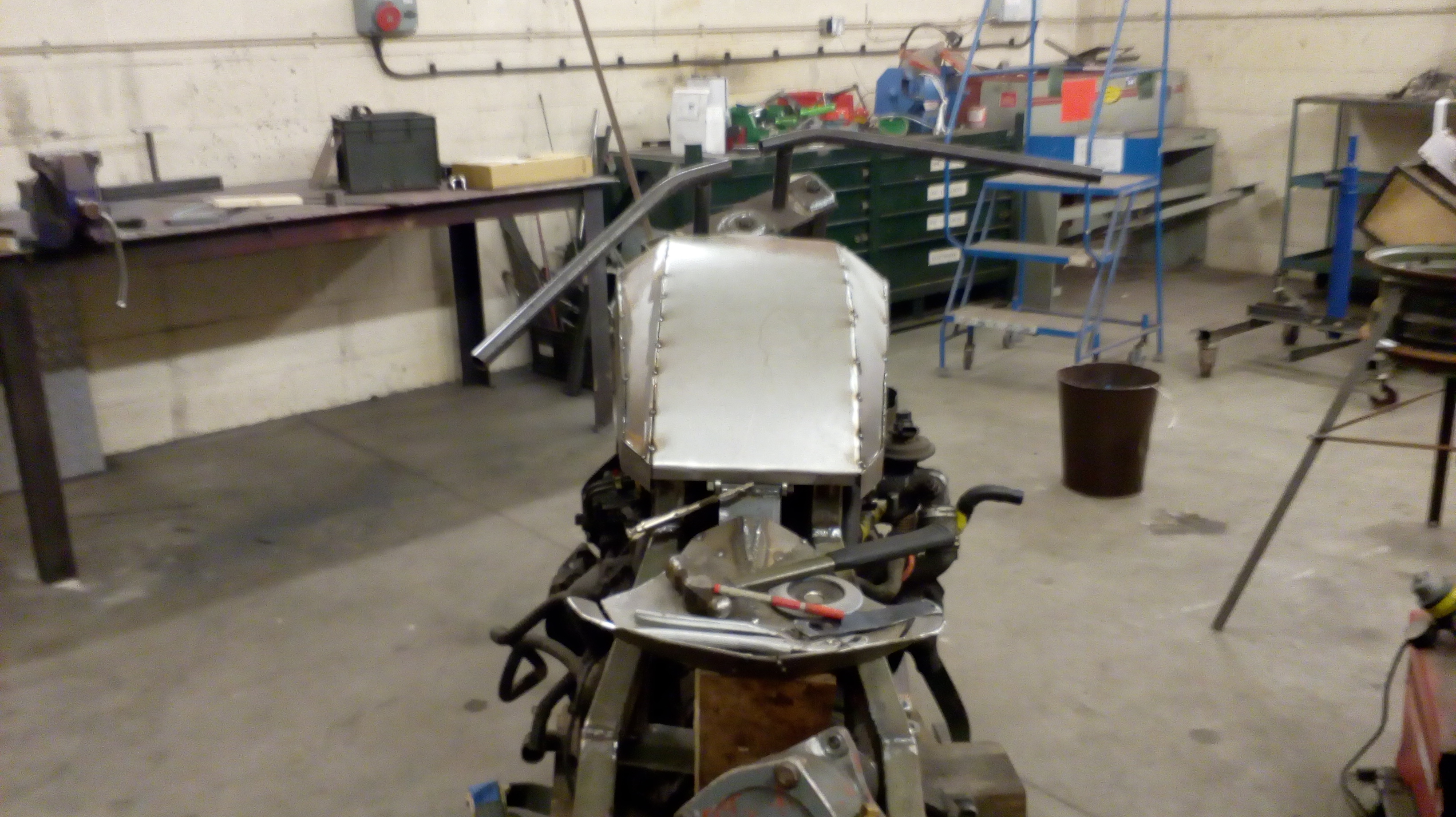

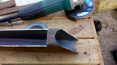

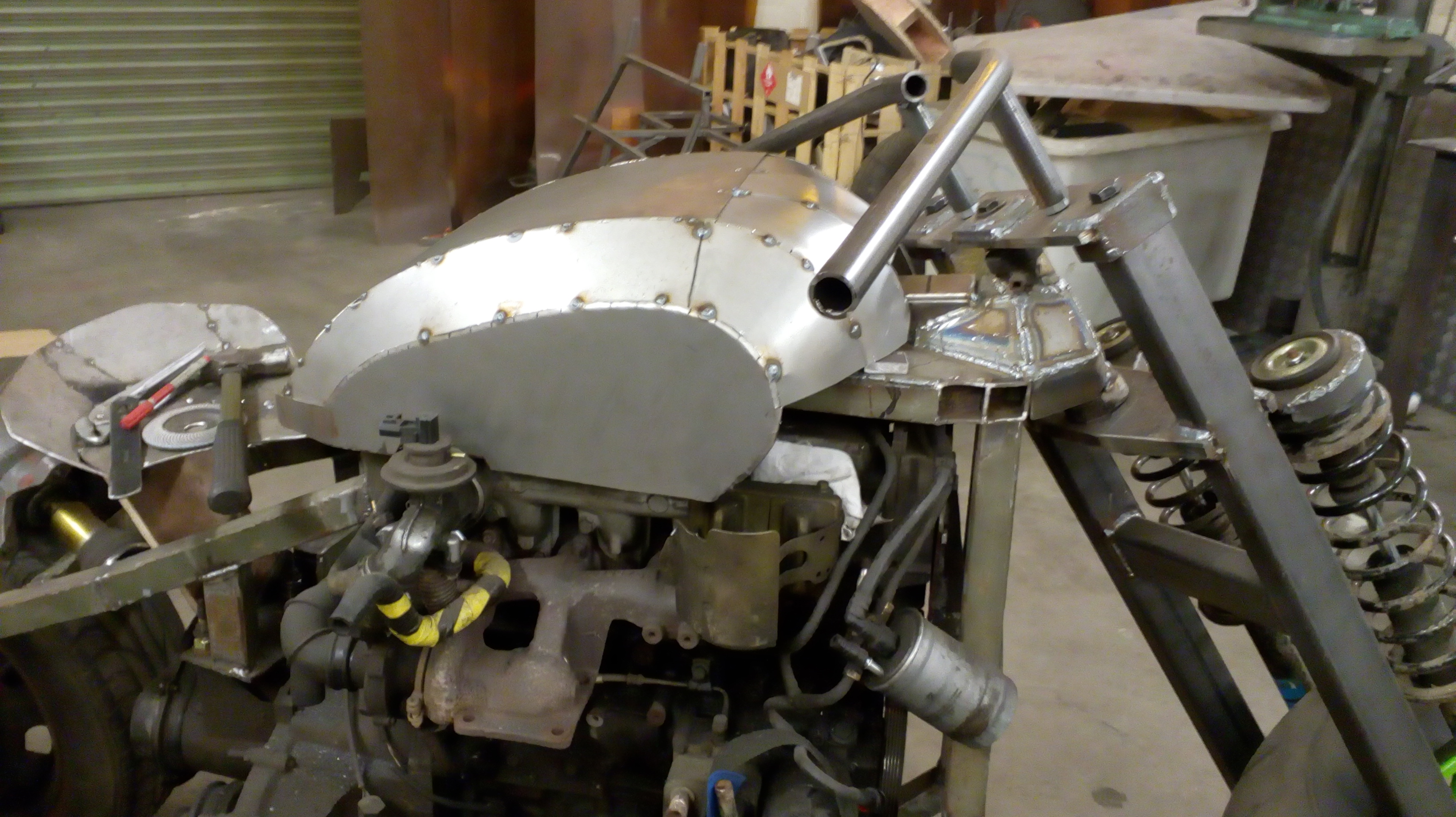

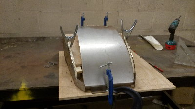

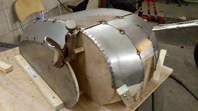

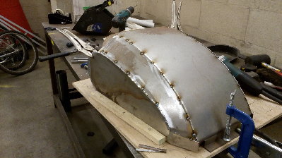

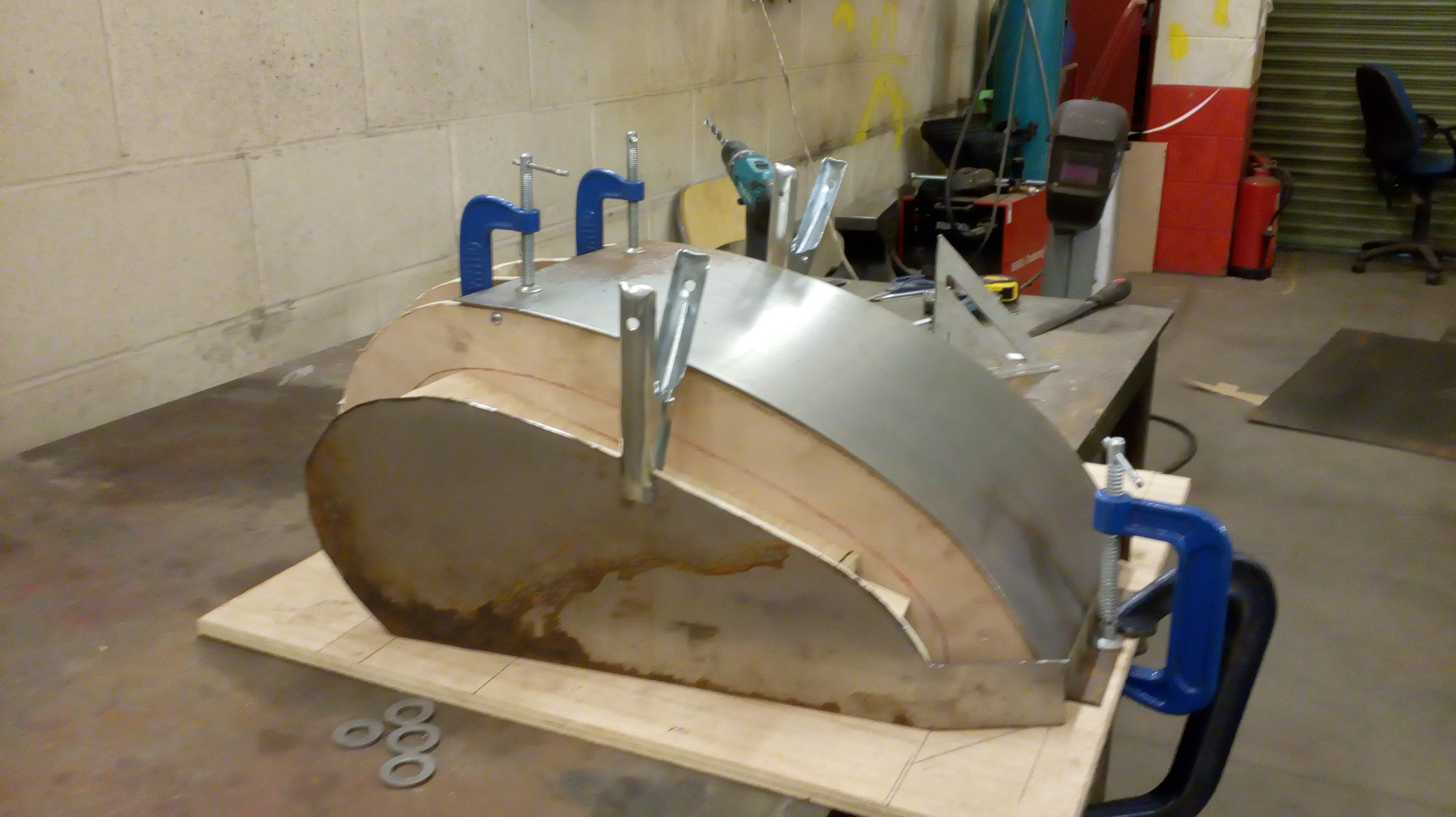

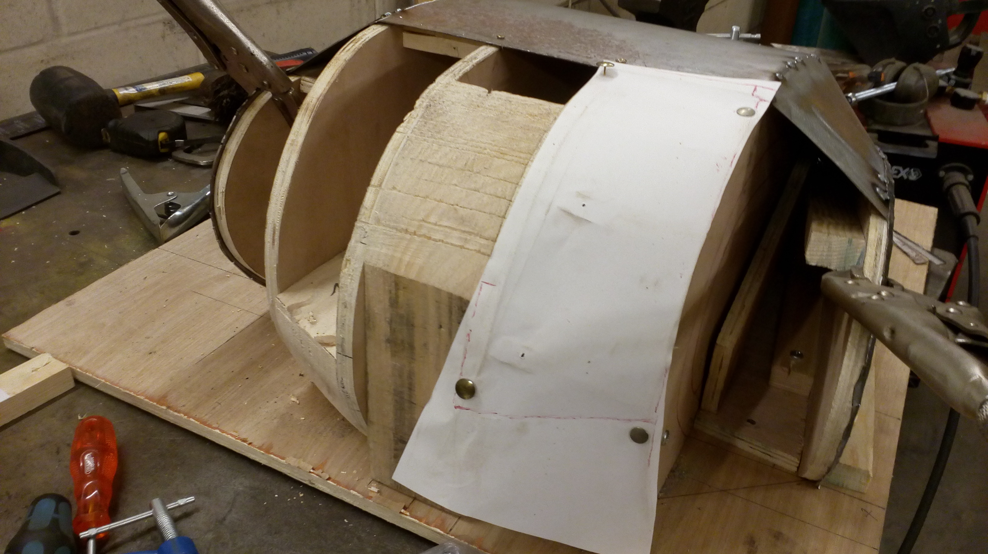

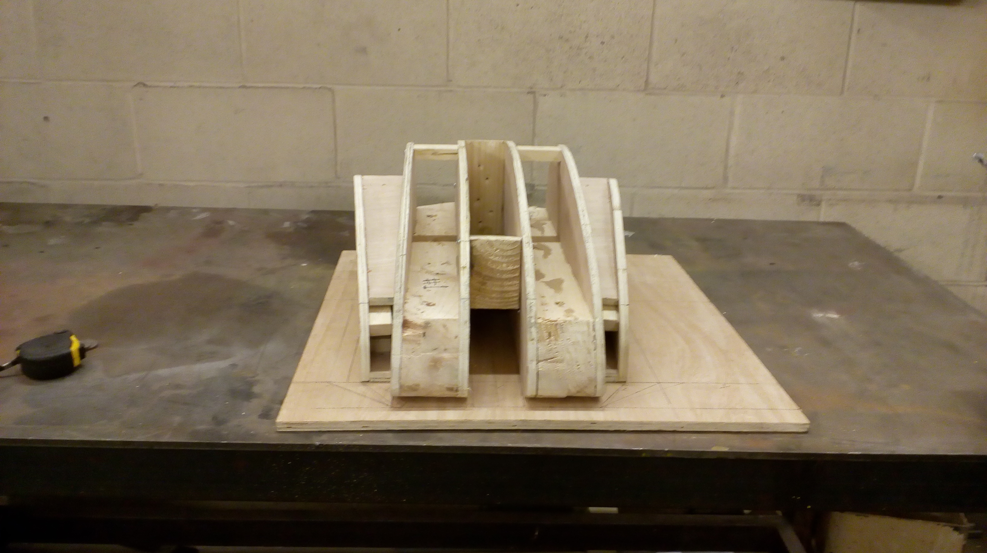

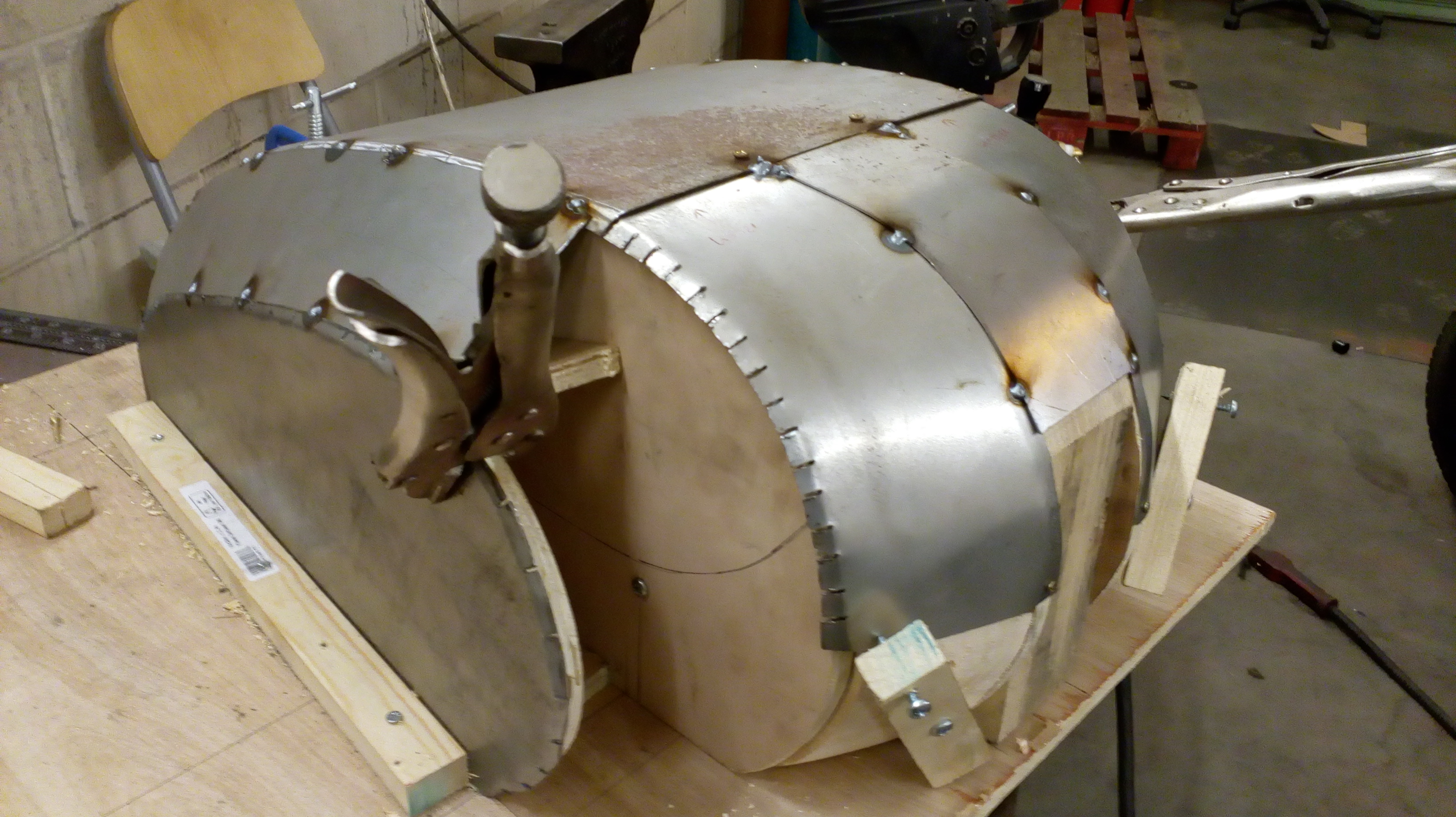

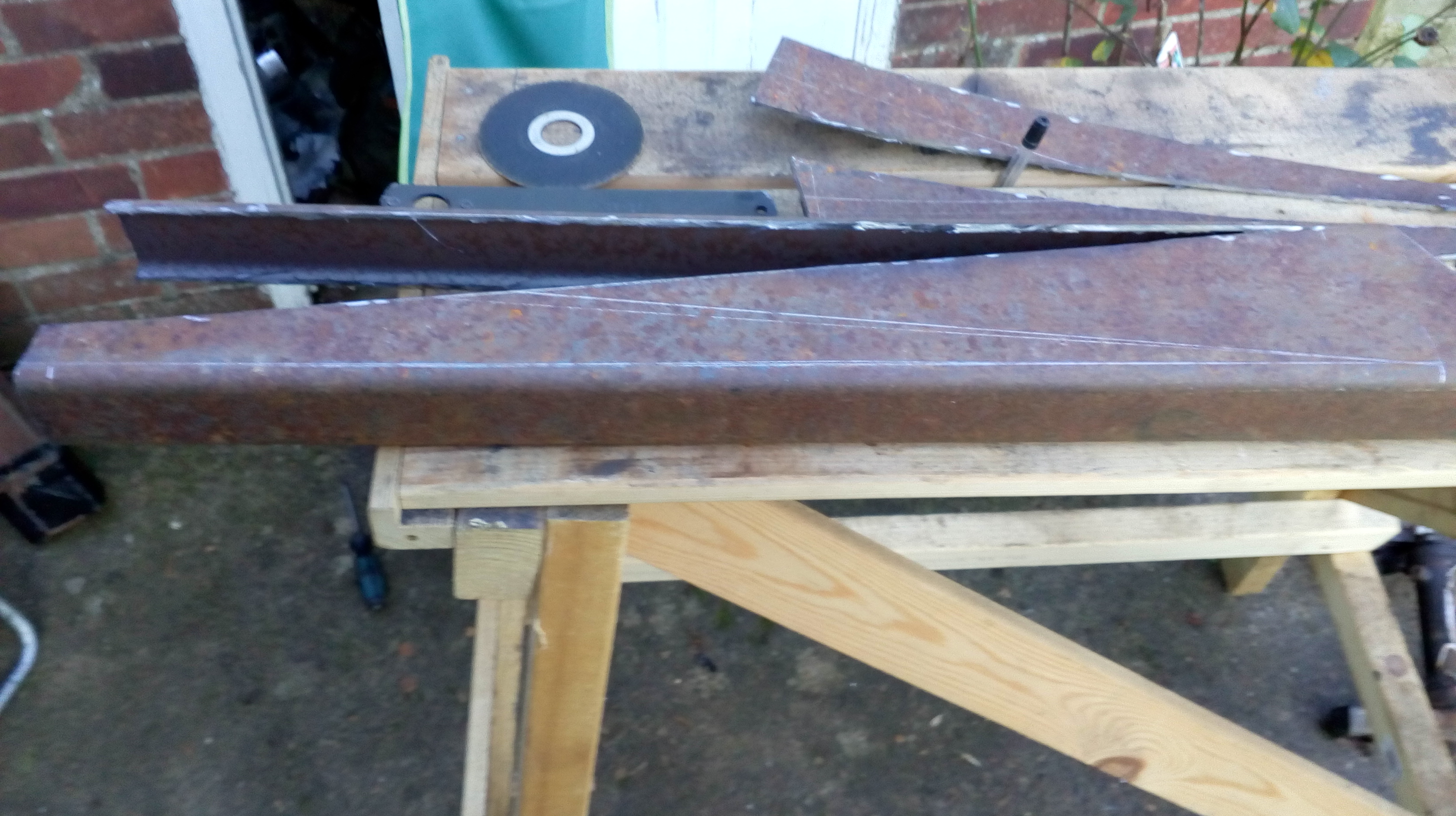

I managed to get a bit done. I have started work the tank I want to get all the tank fabrication work done over the next 2 weeks. I have made a plywood form to build it around took a bit of time but it is worth the effort to get the tank done. I have started to cut out some steel out hope to start welding it this week.

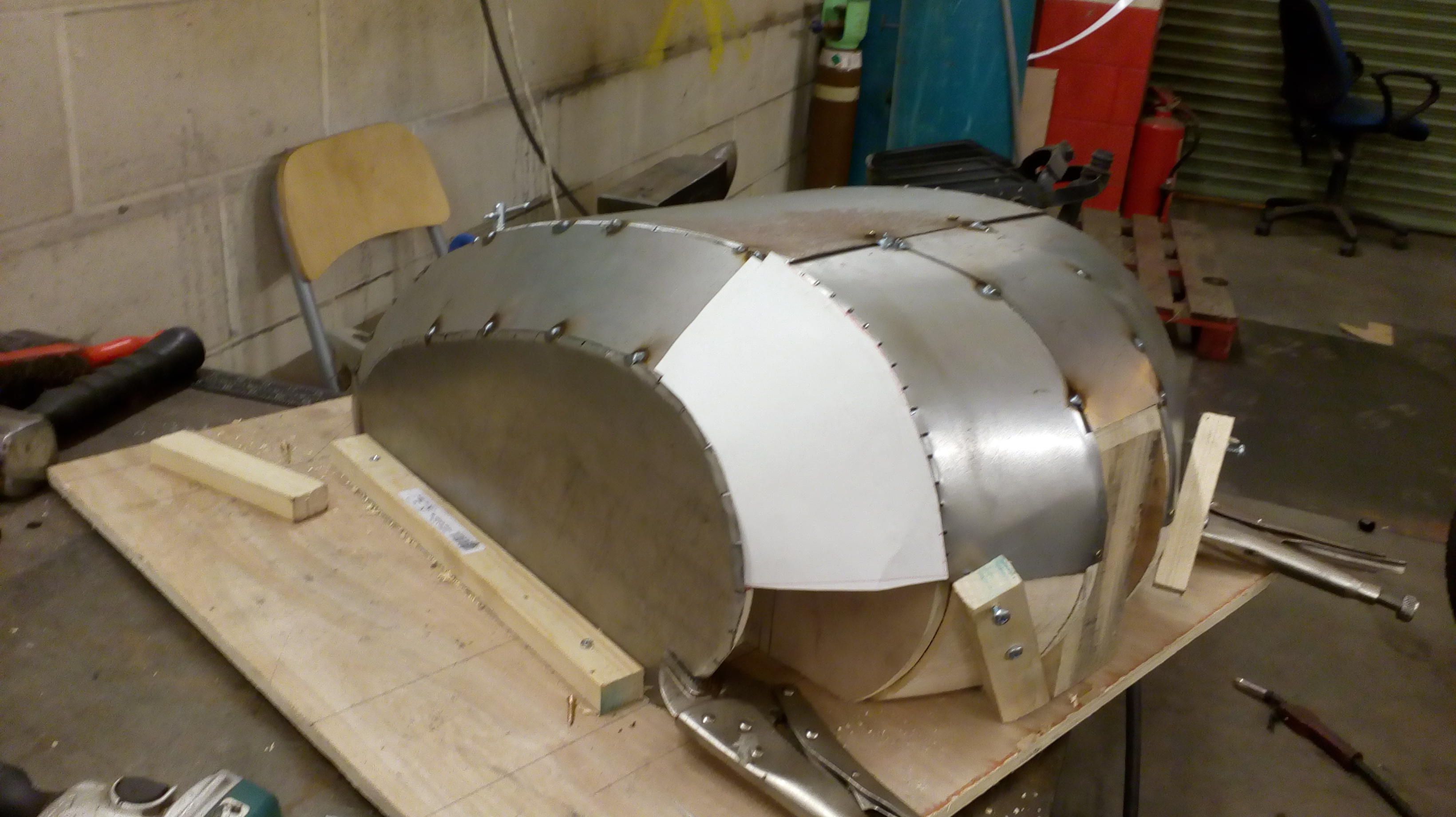

I have started filling up the gaps in the tank it is going well so far just need to make a paper template cut 2 pieces check fit get it as close as posible and thats it. This is the first time I have used the plywood form like this. The last time I made a tank for my son’s bike I just made a form for both sides and filled in the middle. But this is a far better approach so far. I hope to get it all done by the end of the month. I have to make the tunnel and work out the mountings. I have a sender unit and will be putting some fittings for banjo bolts for the fuel lines. I will be welding it up with MIG using 0.6mm wire as this seems to be better for tanks. I have an old Cebora 130 for this special occasion. I prefer this for tanks as it gets into all the tight spots.:D

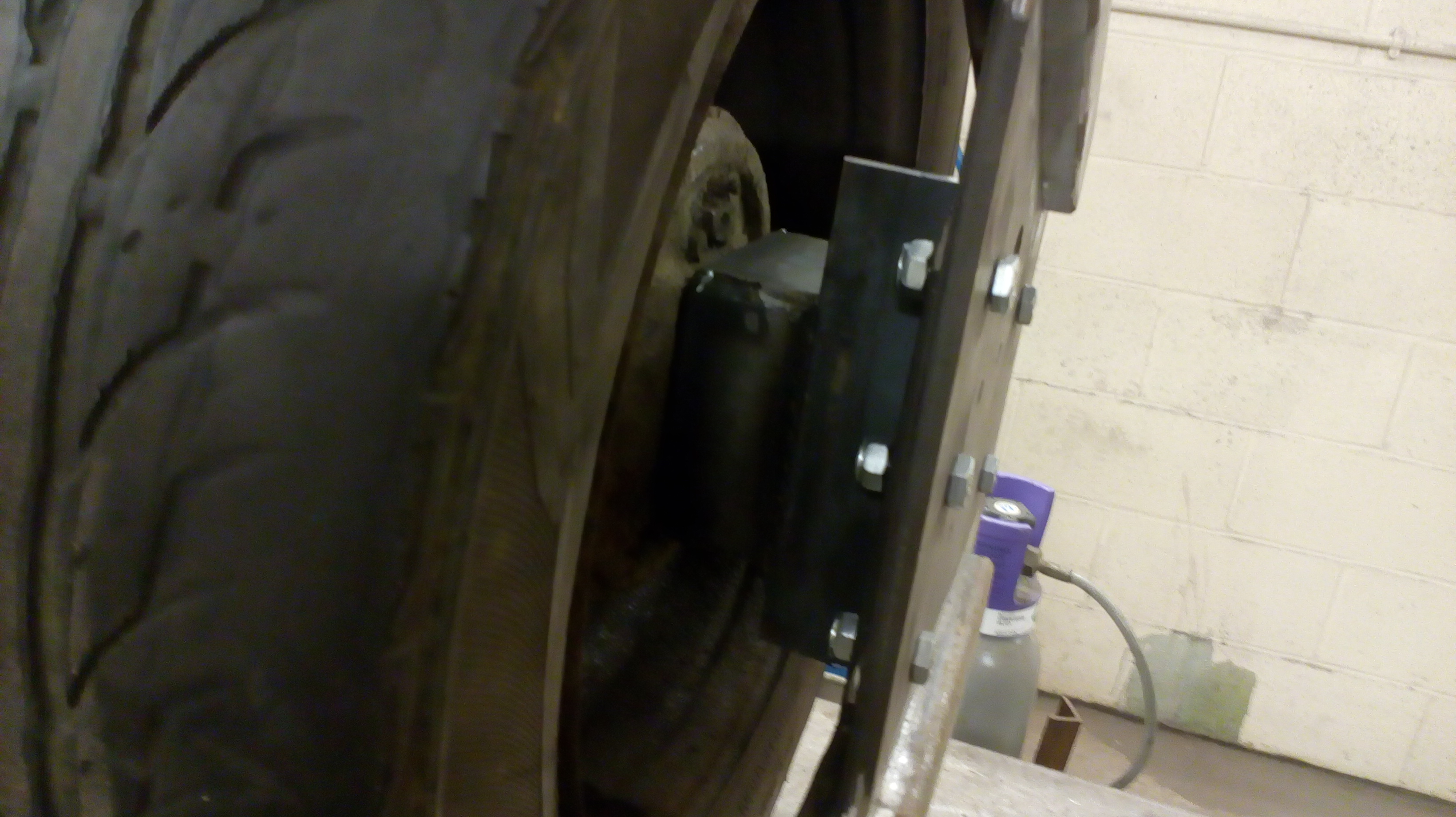

I want to run a car tyre on the back because I'm tight therfore I need to put a sidecar on it for the test and the sidecar will be bolted to the frame. I probably will run it without the sidecar at least 1 time :lol: wait to see my plan for getting it ballanced. but can't do that until everything else is done. :D :D
