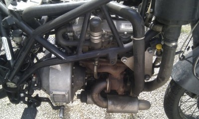

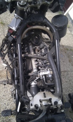

On my Track there is only a mass flow meter between the turbo and the inlet manifold, the rest is plain piping. The injectors are electronically controlled. No cable controls.

Thanks Bert. Any chance of a photo please so that I know what I am looking at?

I hope this will work for you. Let me know if you need a picture of something else.
