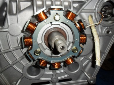

Did ypu take pictures of this coil? In my engine there is a Ring with several coils on it.

This is the rewind coil.

Thank you, I should do this also. My flyweel is very tight on the crank, I hope I can get it off again. When I remenber correct, on my coil not all legs have wires on.

I did not rewind mine yet, the picture is from Boutje. Boutje, maybr you can give us some more information.

I have rewinding it with 1 mm wire.(that is what i have in the workshop)
But original it was 0,8 mm.
What i did was the following:
I disconnect the regulator.
Started the engine with the original coil.
Measure the output ac voltage of the coil when the motor is running on idle.
I measured 10,2 volt ac
Then i took the coil apart and counted the windings.
That was 315 windings.
10,2 volt / 315 windings = 0,032 volt per winding
I wanted a minimum of 14,5 volt ac out of the coil on idle.
So 14,5 volt / 0,032 = 453,13 windings
I have 9 coils .
453,13 windings / 9 coils = 50,34 windings per coil
50,34 is an impossible number so i make it 51 windings per coil.
Thats roughly 45 % more windings per coil

Thank myou very much. The rewinding is not the bigigest problem, the Problem is getting the flyweel of. And with your information I have to do it only once.

Make sure you copy the winding direction on each bobbin.....
