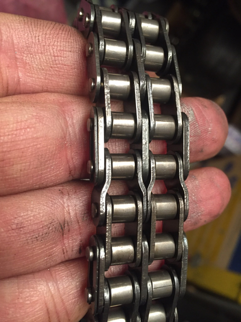

He said he had recently helped out a guy who had made a powerful V twin Enfield by supplying a better chain. His now much more torquey engine was eating through primary chains like nobody's business but the problem was solved after fitting a duplex Deutz chain.
He showed me the larger pins and centre links on an example he had & went on to say they will quite possibly outlast the engine. They are also able to be routed through much tighter curves that you would expect on the return route but can only be ordered with an even amount of links of course. Enfield chains are 06B2 (or 3/8).

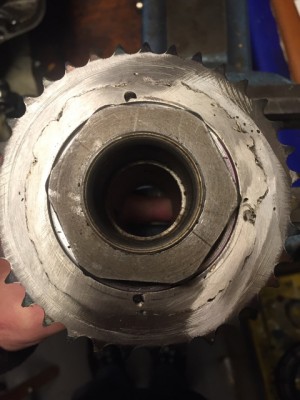

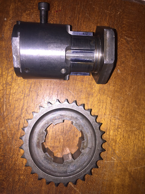

I asked him about increasing my primary sprocket size and he went on to tell me that any bearing supplier could supplier a 'platewheel', press fit & weld them over an existing cog after first machining the teeth from it. It's a common request as you might expect.
So I'm going to source at 06B2-35 duplex Platewheel.
My Enfield has the original engine sprocket 29T & clutch 56T. Ok if you've got the RPM supplied by a petrol engine but not by a diesel! Anyway, anything from about 34T or 35T primary will get me the cruising speed I require, 35 giving a longer pull away in first which some may not fancy. This through a four speed box of course.

Got our 35T sprocket back. Looks like they've pulled it off, just.
Luckily the new length primary chain won't need a half link like the old one. They don't do them for Duetz diesel chains. Waiting on the new chain now.

Chain arrived with specified 102 pins. It fitted fine, the sacrificial slipper taking up the small amount of slack. Chain make is JWIS from Germany. Everything was fitted inc 5 plate clutch upgrade (excellent) and 430ml of ATF added to chain case.
