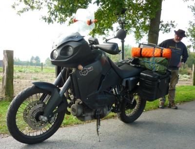

The "almost" Smart diesel engine in my 90.000 km old Track T800 CDI is standing straight up. Oil reservoir custom made for the bike by the manufacturer.
I think that using the Smart CDI in a K100 will work great IF you'll manage to get a ECU for the basic engine without all sensors that are in the car, for instance EGR, gearbox etc.
The ECU that's in use in the Track T800 is no longer in production as far as I know.

Bert in Weesp wrote:The "almost" Smart diesel engine in my 90.000 km old Track T800 CDI is standing straight up. Oil reservoir custom made for the bike by the manufacturer.
Thanks Bert.
That gives me another option which I think is lighter than the Daihatsu and more available
Do you know what flywheel is used as the Smart are all either auto or semi auto?

Standard Smart flywheel, but enlightened to make it more responsive ( I guess ) and/or also give more space to the CVT.
