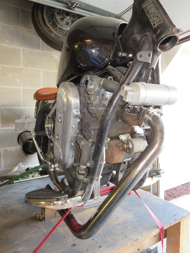

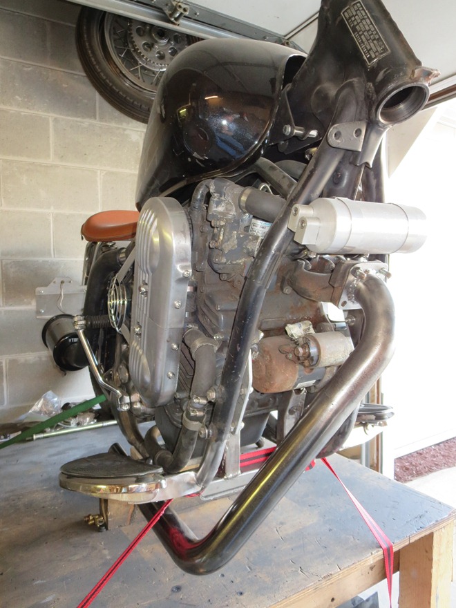

Having had the original Enfield mounts holding a Lombardini unit in place, and subsequently changed to Henry's system I'll guarantee it's a lot stronger.
As the sun is already setting photo's will be a tad difficult but if it's sunny tomorrow I'll see what I can do.
