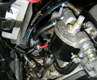

So I decided the easiest way was to replace the solenoid operation with a mechanical one, using an in line fuel tap adjacent to the solenoid, which is mounted on the fuel pump.
An 8mm diameter in line fuel tap was used, which allows the same fuel flow as the solenoid internally. A 10mm diameter fuel tap could also be employed.

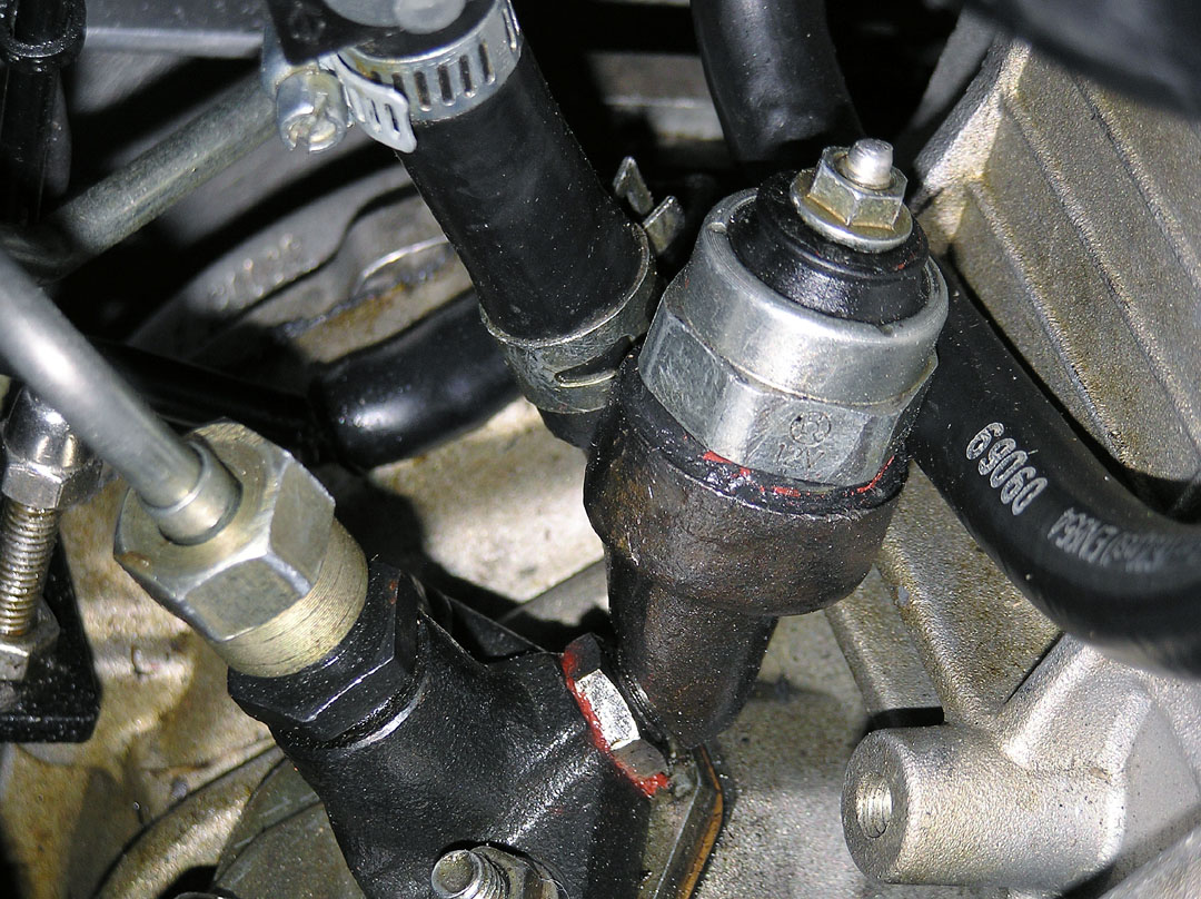

The solenoid was unscrewed and the internal valve and spring were removed, and the housing assembly could then be resealed and screwed back in place on the fuel pump, making sure that it's fluid tight. The electrical cable could be disconnected from the top of the solenoid connection stud, the connector then taped up and stowed away.

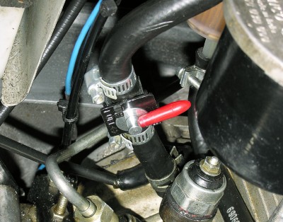

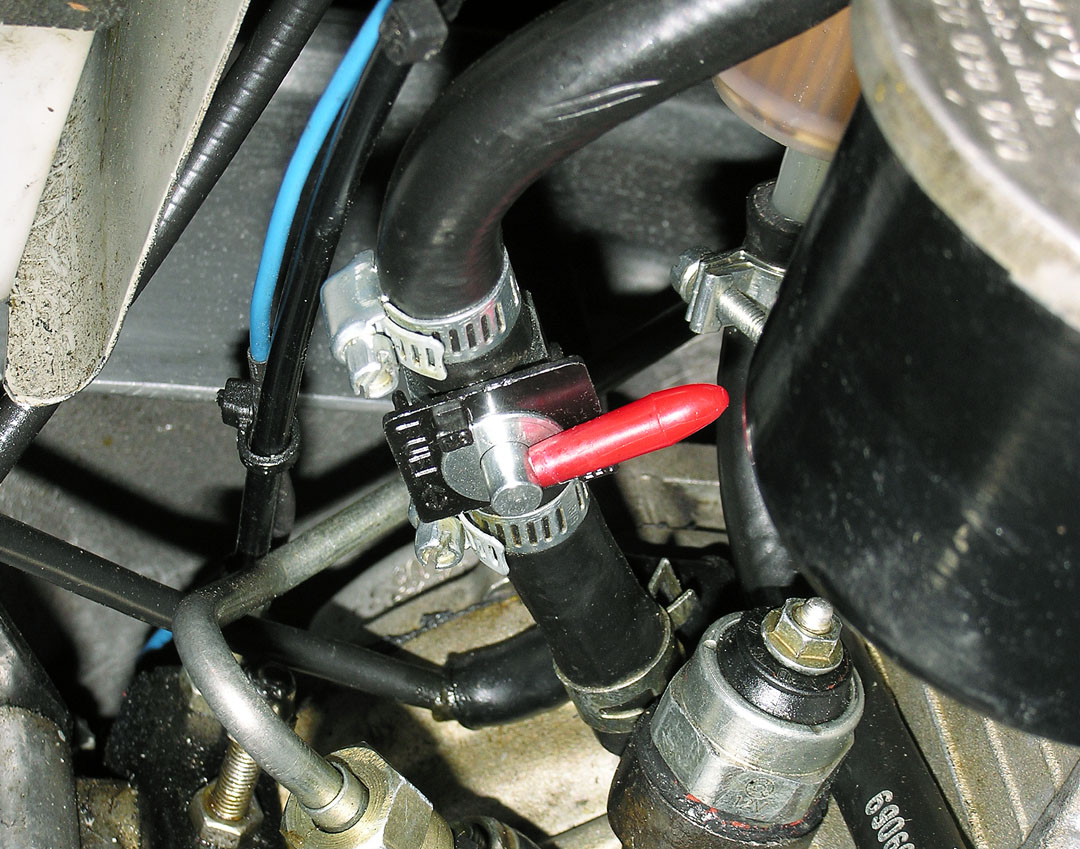

With the fuel tap lever placed 'in line', the engine can be started and run. When it is in this off position as shown in the picture, the engine stops running in about 5 seconds.
Just have to remember to place the fuel tap lever back in the 'in line' position, or the engine won't start again!
