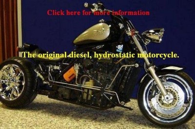

slightly different to a torque converter but perhaps something along these lines??
I see there are quite a few hydraulic motors on ebay but I don't know anything about them eg size power output suitability etc.
Anyone out there who knows if they would be suitable for bike use??
I was thinking mounted behind a fore and aft car engine with either chain drive to rear wheel or direct to rear wheel via hoses.
What components would be required??
Might be a good answer for limited space compared with a conventional gearbox or cvt??

another example of hydrostatic
Racoon 2wd mini bike. Similar in concept to Rokon (2wd work horse/tractor..ish minibike on steroids)
http://www.hydraulicinnovations.com/for ... f5c5c&t=18
Same company, Diesel hydrostatic chopper, This video gives a good bit of details (least the opening of the vid says it does)
http://www.youtube.com/watch?v=t6G_YrGugug
Others from Hydraulic Innovations
http://www.hydraulicinnovations.com/for ... ht=chopper

A torque converter essentially a pump and a turbine in one unit. The blades (vanes) in both the pump and turbine will have been designed to give the least losses at the intended operating speeds and loads. Running it in reverse may work to an extent, but it'll be inefficient, and the greater losses will be realised as heat which will cook the transmission fluid, and possibly your rear tyre.
Even if it's running at 85% efficient (unlikely), if you were putting 30hp though it (22.5KW) you'd be losing 3.35KW in heat. A normal internal combustion engine loses WAY more heat than that, but it gets pretty hot.
The hydrostatic transmission does a similar job, but using axial piston pump and motor it will tend to have better torque tranmission characteristics over its entire speed range, and because the units are separate to the wheel you can put a heat exchanger in etc.
