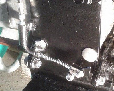

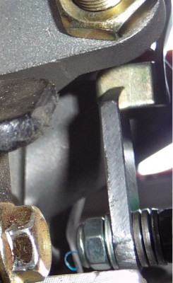

The mechanical solution could be to reuse the decompression lever at the left hand RE handle, and add an extra fuel close mechanics at the throttle lever. I did it this way: The stop lever forces the bottom engine fuel control lever to go from idle to fuel stop

Thanks. Do you have a picture that shows this mounted to the engine. I guess I would love to see how you connected this to the lever on the engine.

There is no mount on the engine. The fuel stop arm pushes the bottom engine fuel control back into stop position.
