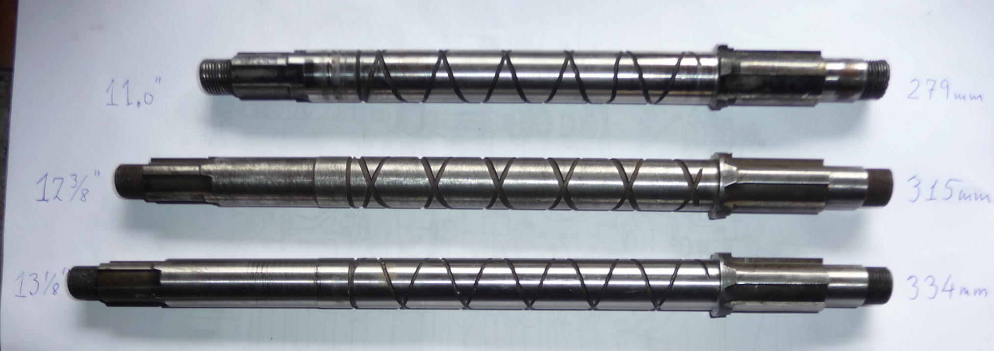

I prefer to have the diesel engine in balance ( "engine gravity vertical center line to align the bikes frame" ) and placed the engine center line approx. 12 mm left to the bikes frame. Thus the gearbox mainshaft must be swapped to a longer one. The clutch push rod inside the mainshaft needs an extension according to the longer mainshaft chosen.
The original mainshaft is 11 inch long, and diesel mainshaft are available in 2 lengths, 12 3/8 & 13 1/8 inch.
Original and diesel gearbox mainshafts

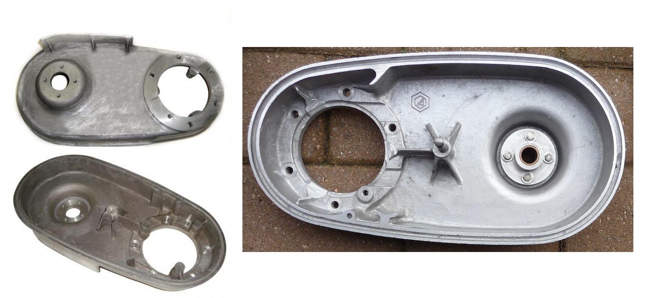

I got the 13 1/8 inch version but had to cut down to 12 3/4 inch. An Enfield Taurus inner primary chain case is needed as well, because it includes a bearing to support the longer mainshaft. I bought the mainshaft, primary case and bearing from priceparts.co.uk :
Original and modified inner primary chain case

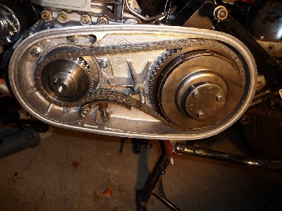

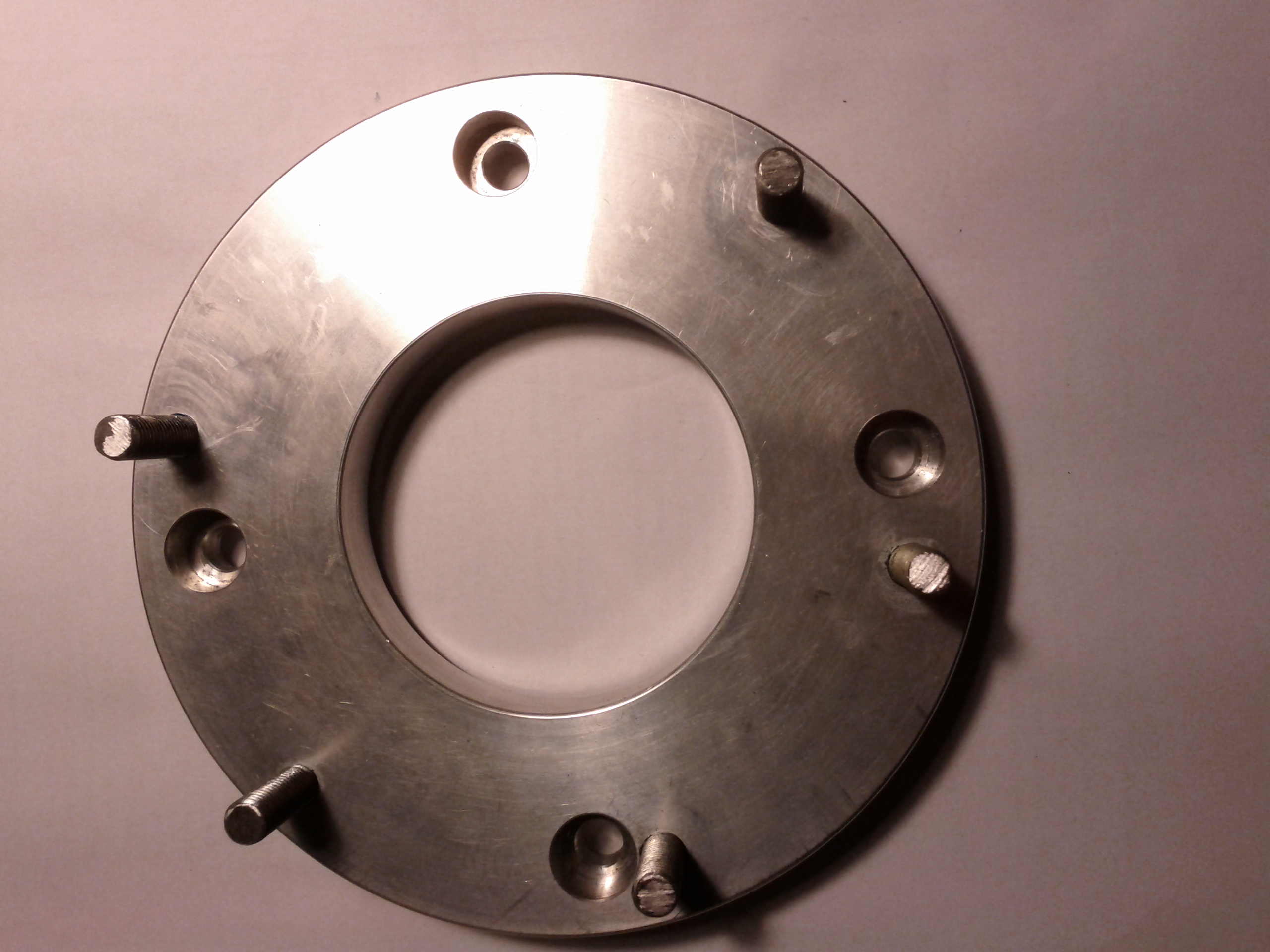

A spacer between the engine and the Taurus chain case is needed, approx. 8 mm thick with 12 1/2 inch mainshaft and approx. 24 mm with the 13 1/4 inch mainshaft.:
To have an adequate clearence between the secondary sprocket and the Yanmar throttle cabling, I kept the original 16 teeth 350 Bullet sprocket.

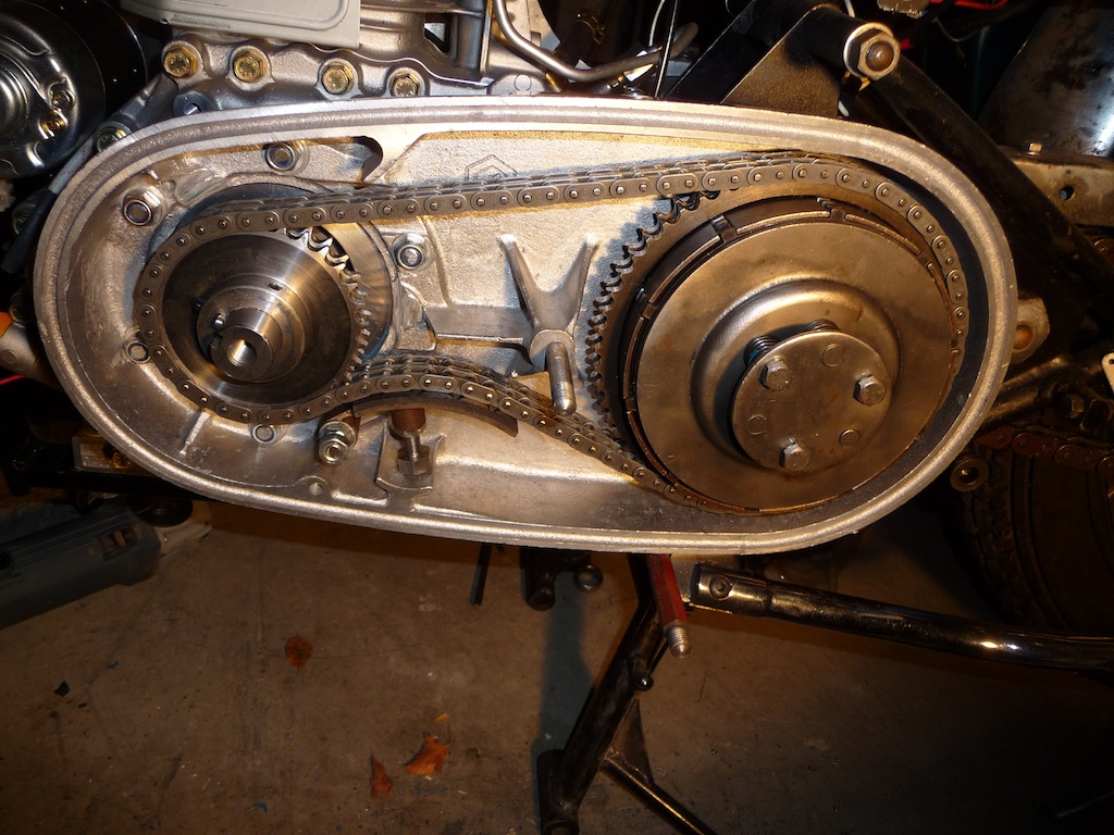

The Yanmar engine tops out at 3600 rpm, and with a primary engine sprocket of 30 teeth the bike should top at 97 kmh. The distance between the engine output shaft and the gearbox mainshaft adds 5 mm, compared to the original distance, in total a 94 pitch primary chain is required.

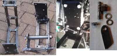

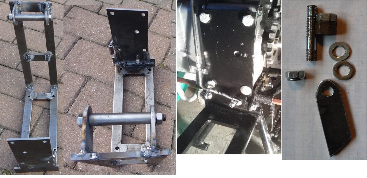

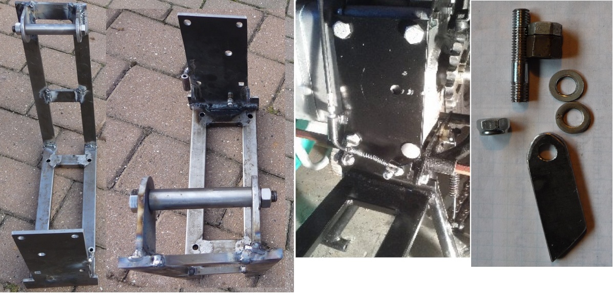

The process of making the engine support frame is a kind of stepwise designing and welding from the gearplate to the front. The gearplate is made of 6 mm steel plate, the bottom under engine frame are steel tubes of 30x15 mm with 2 mm walls. The gearbox plate includes a fuel stop arm arrangement. The frame front part is made of 30x8 mm steel.
Engine frame and fuel stop parts. The fuel stop lever pulls back the fuel control lever.

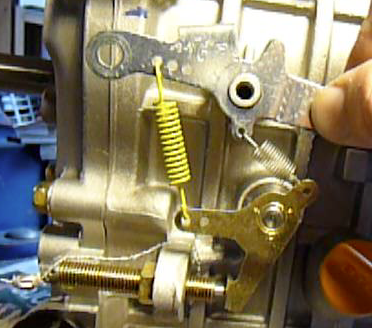

The original Yanmar throttle controlplate was changed:
The engine speed ( fuel amount ) is controlled by an internal centrifugal  fuel regulator. The centrifugal  fuel regulator uses an external counterforce in terms of an applied spring force. The larger, yellow spring sets the applied force on the fuel regulator, more spring force is higher rev. at max. load. From the engine manual, I used the 3-B setting, inner hole on the top lever ( picture shows outer hole setting ) and second hole on the bottom lever.
Yanmar fuel control plate mod.png (216.25 KiB) Viewed 29254 times

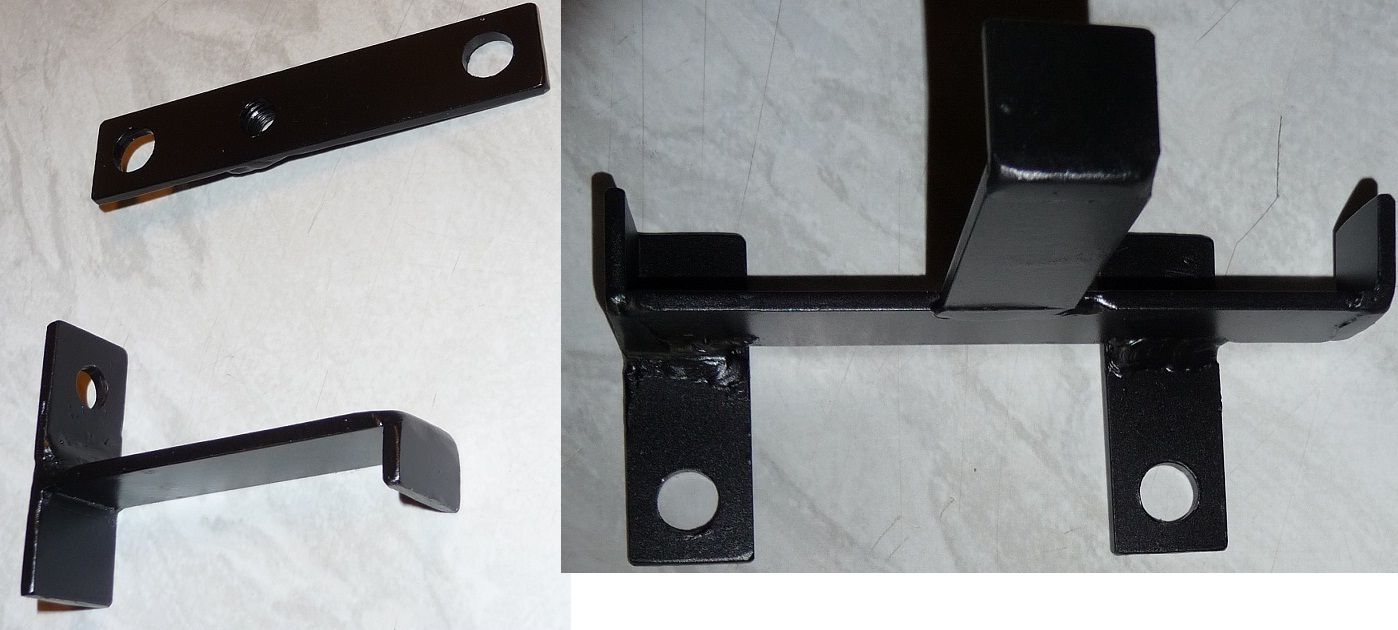

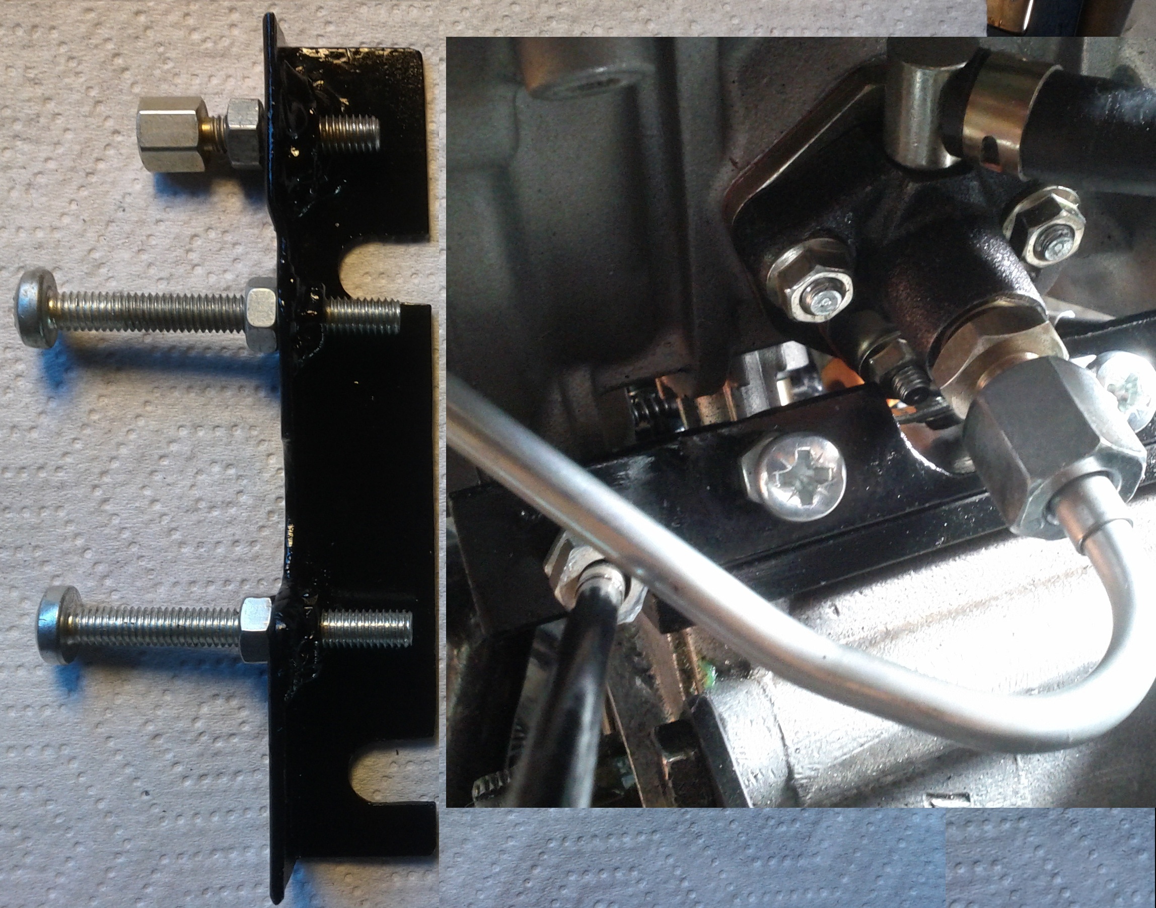

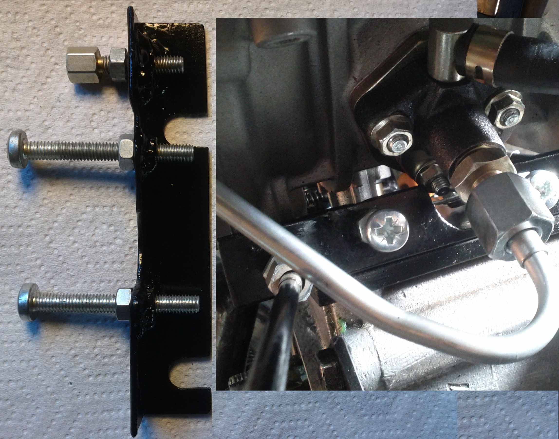

And a throttle cable and adjust plate was made:
Throtle cable , max. rev. screw ( at no load ) and idle speed screw

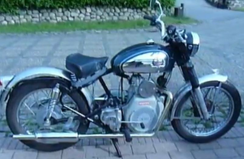

Engine in frame, ready for riding

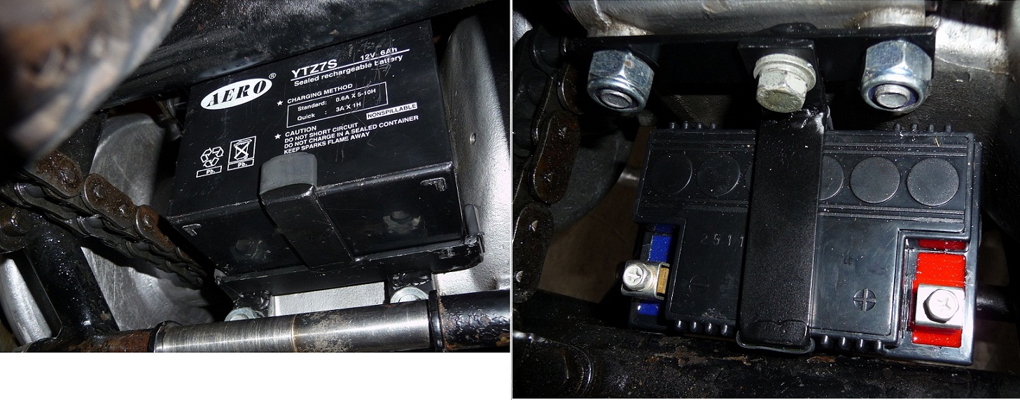

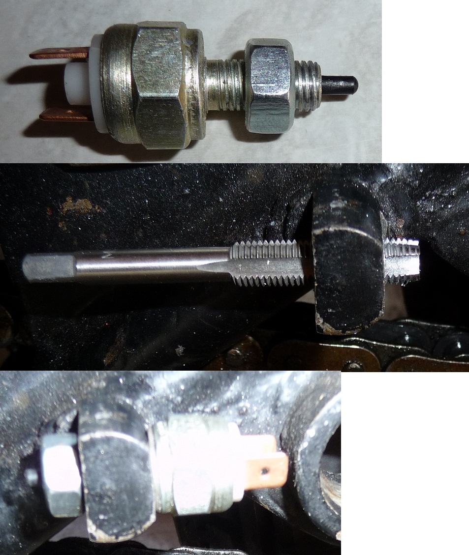

The battery is moved to the empty space behind the gearbox, the two side boxes are removed, and the brake light switch is now a Dnepr-Ural type :) :
Battery braces to hold the battery behind the gearbox
Top and bottom view of the battery in its new place
Ural brake light switch using M8x1.0 thread

Got the link form your last post, but do not understand why it adds 5mm more between primary sprocket and clutch..
Mine(original gearbox shaft-) did not.. it was not possible since this distance is dictated by the inner primary..?

Needed to use the longer gearbox main shaft to place the engine more to the left to get a better balance in the frame.
