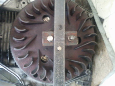

I took the time to make a device on which you can use the 4 threadholes.. it worked!

arnaud wrote:I took the time to make a device on which you can use the 4 threadholes.. it worked!
Pic is worth a thousand words? Video even more 8)

Finally, as promised, the self-made tool for china flywheel removal.
