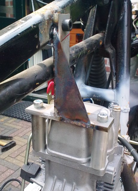

Cutting up an XT engine, that be lots more of a shame than any yamaha two-stroke..
I'd like to emphasize that its not just me, 'vincentyeager', Jeroen (boutje) is putting in alot of effort in it as well.

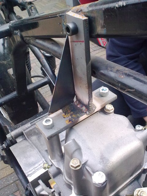

time for some more pics, since we've made some progress;
upper strut, this will add stiffness front left mount, its welded all down the back

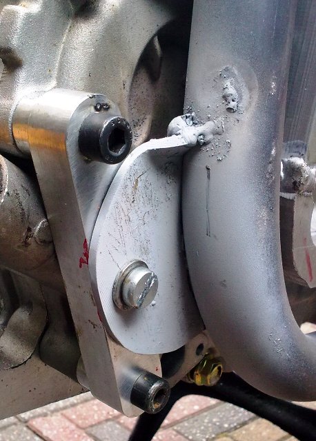

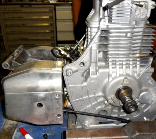

and here you can see how the aluminum part was machined;

Very creative method of attaching the cylinder head to frame, should stiffen the bike up a good amount....you're not going to flex a clone engine. What gearbox are you using?
Cris

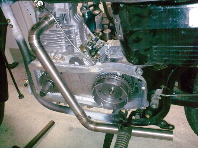

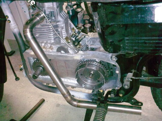

the flywheel will be around 50% lighter then the original one. This is not abnormal to do, it will make the bike more souple and reactive.
More important, the exhaust is nearing completion;

Your flying now mate, loving this build, the flywheel may be lighter but you've also added more flywheel weight in the transmission chain, clutch basket & plates ect so I think it should all balance out nicely, looks like a top quality job on that exhaust too !

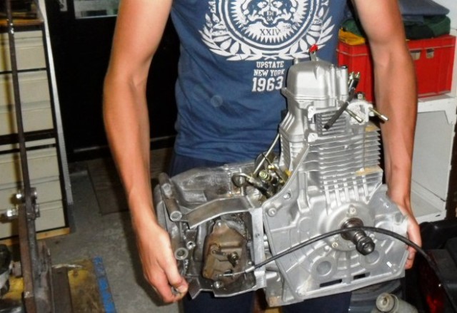

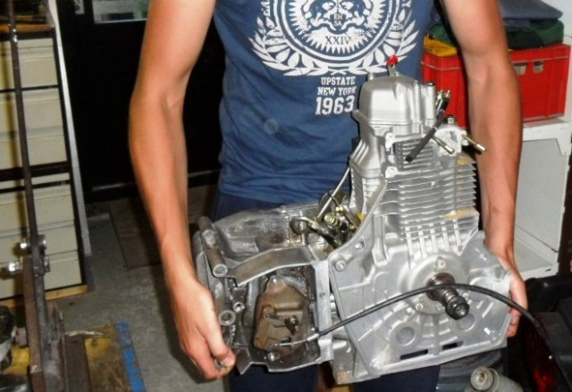

powerpack, quick 'jawa' shifting
its not as heavy as it looks. and with the cover; plan is to sandblast&''glasspearl'' (?) all the custom aluminium work

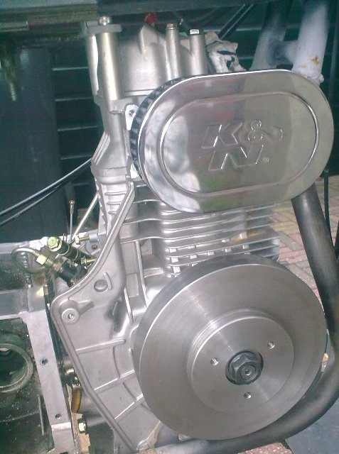

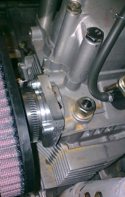

hi-flow filter and inlet manifold
along with the exhaust, its all part of vvm diesel stage one.
jiffy stand situated on the unconventional right side of the bike or should we say of the ''dikke brommer'' (dutch for big/fat moped).

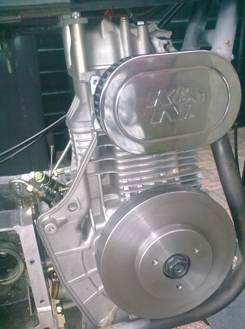

Flywheel (with v-groove situated at the front) is ready,
Jeroen busted his behind on this piece! and took the first step towards improved aerodynamics

Re: Jawa / yanmar clone
Looks like your nearly ready for the maiden voyage mate
your right about the flywheel to, it looks like a lot of hours have gone into it.

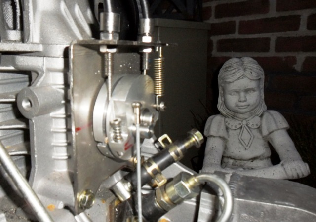

look what Jeroen's itching hands produced this time
it will include a 'kill' position as well

Bloody hell mate it just gets better an better, when your finished with him send Jeroen over here will ya, does he eat much
If they had a build of the year prize I'd vote for your Jawa no contest !

Cant wait to see this one going.
PS does anyone else find that statue spooky?

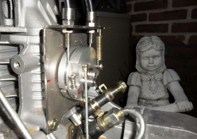

- vincentyeager
- Posts: 52
- Joined: Thu May 05, 2011 9:47 am
- Location: Holland
going....around europe next year and maybe even to the jawa factories?
Yes, the statue thing IS a bit spooky

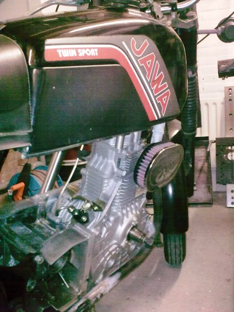

You will probably have major issues from lightening the flywheel, the weight is needed to keep it going at lower rpm and also for kickstarting (on the Enfield), without it it will not have the momentum to keep going past the decompressed cycle.
Nice engineering btw on the regulator

The weight hasnt really changed, only the diameter.
I've read somewhere on this board i believe, that these yanclones need an idle rpm of ~1200 to keep it from hurting itself.
We'll see how it goes.
In the meanwhile the welds on the gearbox are grinded flat, and afterwards having it in my kitchens oven at 300degC for 6 hours.
We have a nice overal hardness of the aluminium now; http://www.youtube.com/watch?v=Oq_Zc288gT4
and please, dont use household oven gloves like i did *ouch*
rather use a big set of plyers like the real mcCoy!
