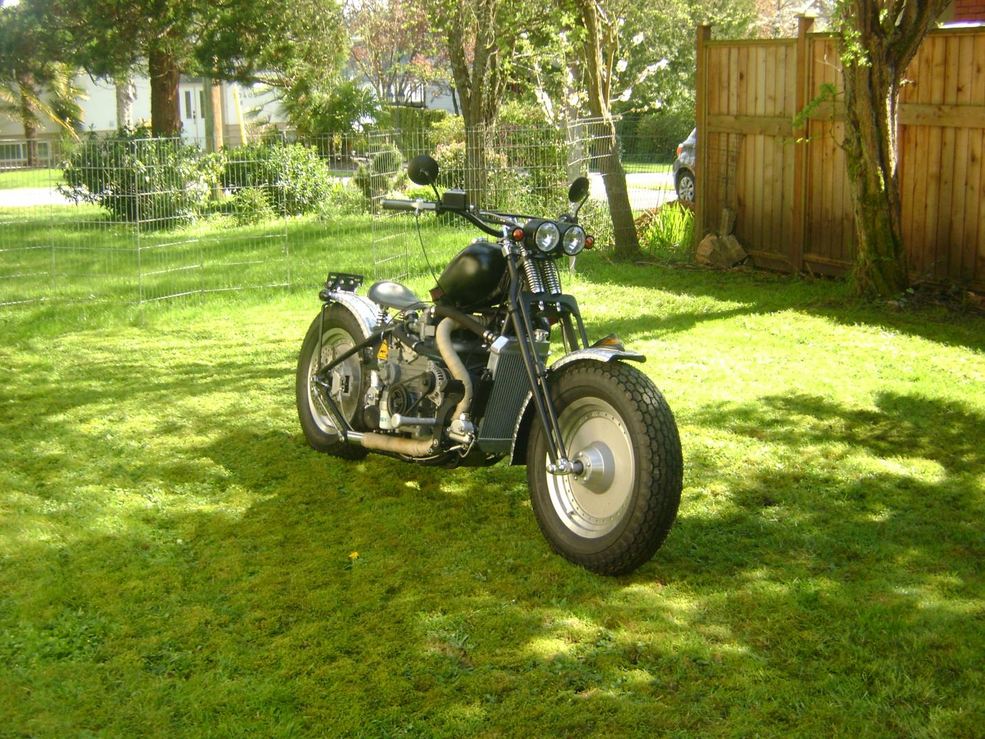

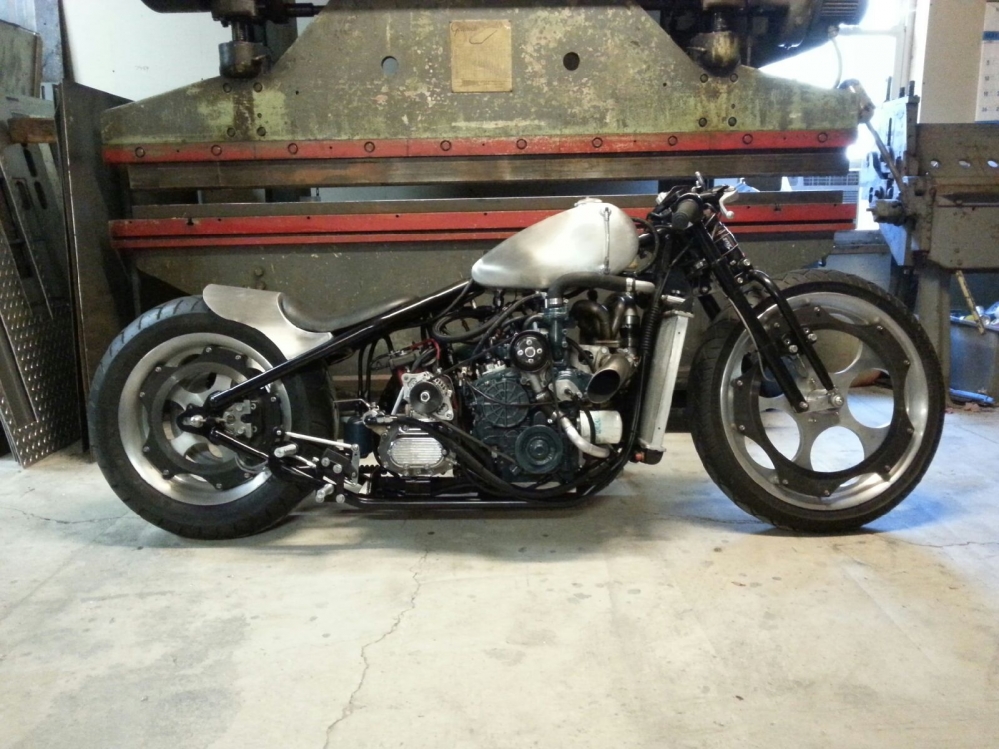

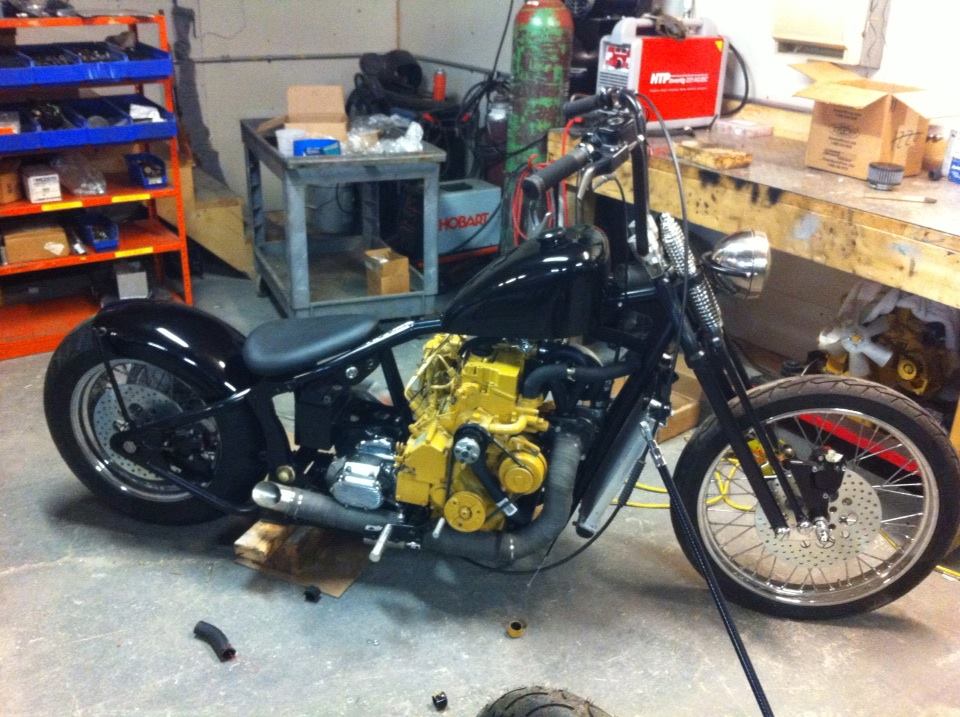

I'm going to try running the bike with the radiator I have now, it's bigger than the rad on my Suzuki GT750 triple, and my Suzuki has never gotten hot even in slow heavy traffic in the summer. I threw a couple pics of dethmachinefab's bikes for comparison, and lord knows my bike is wimpy stock compared to his screamers.
