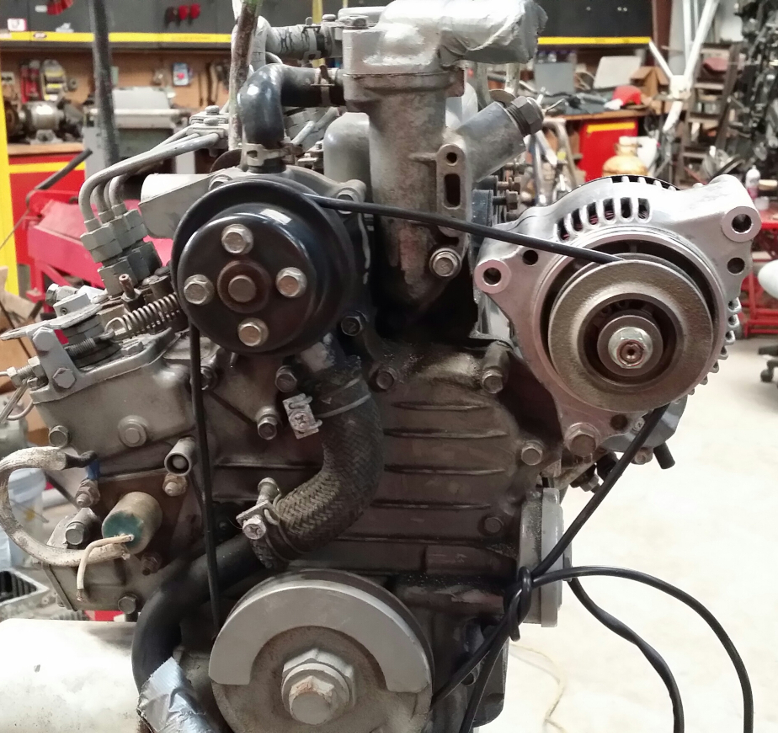

Got a solution figured out George. Going to take the Triumph Alternator and removed the gear drive Then I took the little idler pulley off the Kubota engine and pressed out it''s bearing.
With me so far?
Tomorrow I'm going to take the tapered drive hub, the one on the left,
and turn it down on my lathe to where it will be the same size or slightly larger than the outer dimensions of the idler pulley bearing I pressed out.
Then I'm going to sweat fit the cut down tapered drive hub into the pulley where the bearing was.
As in Heat up the pulley and freeze the hub. Press them together and presto, instant drive pulley.
Then replace the keeper clip.
(Starter ring gears are put on flywheels the same way!)
If it looks like it will work itself loose sometime later, I'll weld it in with my MIG!
Then all I have to do is make a bracket to mount the alternator onto the engine and maybe I can figure out how to get that spring loaded idler tensioner to work keeping the belt tight. If not I'll just use a slotted bracket and bolt to maintain the adjustment.
I took some pictures of parts of it, but my lathe needs some new sharper cutting bits, and I'm tired, so I'm going to bed now. Probably won't sleep much... I expect to have Kubota Motors dancing in my head all night.
Not sure what the Triumph Alt puts out, but we can figure it should be enough since we've eliminated the ignition system from the bikes task, and made it all simple 4 wire diesel. One hot wire to the starter from the battery, one from the starter button to start, and one to the fuel shut off switch. Lighting circuits should remain the main.
Oh and the 4th is the chassis ground!

Re: Kubota Charging system from scratch
Curtis in Texas wrote:Got a solution figured out George. Going to take the Triumph Alternator and removed the gear drive Then I took the little idler pulley off the Kubota engine and pressed out it''s bearing. ....
Curtis,
I think the Suzuki one has higher amp output than the Tiger's alternator. Tiger is said to have a rather anaemic charging system. Also it has an integral rectifier and regulator which think the Tiger does not. Though Im not sure that is of any advantage except think I read that the Tiger one is u prone to over heat if I recall right.
Ok just rechecked...... the Suzuki one I sent you is suppose to be 35amp while the Tiger's is only 25amp. If The Zuki alt. checks out might be best to use that one in case add heated grips, suit etc. in the future. That way too I can sell Tiger engine parts which are harder to find and might bring more cash than reselling the Zuki alternator.
Talked to him today. Were going with the Suzuki one.
Curtis in Texas
Posts: 101
Joined: Sat Aug 11, 2007 10:23 pm
Location: Rhome, Texas
Post by Curtis in Texas »
Well we're rolling now.
Figured out a way to use the Suzuki Alternator on the Kubota. Here's the little monster.
I took the Hub out of the middle of the Suzuki Generator
and turned it down on my lathe to where it is the same size as the bearing hole inside of the idler pulley on the right.
Almost there! Another 7 MM and it will be ready!
It will be an interference fit much like a starter ring gear on a flywheel. That should eliminate the alternator issue.
Best part is it will look like it came from the Factory this way!
I will make a bracket to fit to the underside of the Suzuki Alternator so I can bolt it up to the engine block where the idler pulley was. I want to examine the Idler Belt Pulley Tensioner and see if I can get that spring loaded contraption to work on the alternator without getting in the way. Would be cool to never have to adjust the belt tension until it breaks!!!
If not I'll use the standard slotted bracket for adjusting!
More in a few days!
It only cost a little more to go first class,
You just can't stay as long...
Curtis in Texas
A little lathe time and it's ready.
I cut down the hub to the exact same outer dimensions of the bearing.
You're going to love this. I was in the shop last night until Midnight working on this build and got up early this morning to fix a Mates Bike Issue. So after he bought lunch, he left and I got back on the Alternator mod. Since I was tired from last night I threw the hub into the freezer in my Motorhome and took a nap on it's couch. Then about an hour later I got up, hung the pulley on a coat hanger, dangled it in front of the blower furnace and heated it up. Got it nice and toasty. Just before the paint burned off the pulley I retrieved the Hub from the freezer and dropped it inside the pulley bearing hole and BINGO!
Let the parts reach room temperature and it is in there to stay. Nothing short of a 40,000 lb press will get it out now.
Front View. (I reinstalled the "C" clip just to see if it would go. So don't worry it's not holding anything together.)
Rear view.
Then bolted it back on the Alternator.
The pulley is as close as I can get it to the Alternator Housing without hitting. Going to need it close because the exhaust port is almost too close to the back of the Alternator. Since I'm putting the Alternator in where the Idler pulley was it needs to be compact.
Got a cool idea on the mounting system that I'll share with the Group once I'm sure it's going to work. It will be slick if it works.

I'm cutting a mounting notch in the alternator for mounting the Alt low and close. And initial mock up shows the Alternator caps it to be a good swap.
One More Thing!
Oh and I wired the Suzuki Alt so it will plug into the Triumph wiring harness when we get to that point.
I'll be running the alternator to my Sub Contractor and get them to test the Katana Alternator to make sure it works. (Same Shop that rebuilt your Rabbit Starter George.)

Almost have the alternator ready to mount. Will post pictures when I get it done. Broke my special little sander I need to finish it. Looks like I'll be buying another little belt sander. No surprise, because I've abused this one for years.
Curtis in Texas wrote:Almost have the alternator ready to mount. Will post pictures when I get it done. Broke my special little sander I need to finish it. Looks like I'll be buying another little belt sander. No surprise, because I've abused this one for years.
few more pics from curtus
Alternator housing slotted to create a tightly tucked close into the engine alternator. This is pivot point for adjustment. Mounted to OEM tab on block (tab end modified slightly for clearance). Pic is shot from above with alternator swung out wide on pivot point created with this slot
Front View. Note the Alternator housing's mount tab sitting closest to block. This will be the one utilized for belt adjustment setup. Will at some point cut off 3rd mounting point on the Alternator housing to keep nice clean lines and unnessisary width
Just enough room for Headers. Note how using the Triumph Alternator end cap puts the breather holes toward the bottom where the Suzuki were more exposed to the elements. But then again. Ground muck kicks UP off the tires while clean rain kicks down... hmmmm. so maybe Suzki would be better after all??

Curtis in Texas
Posts: 101
Alternator almost done. I want to build a brass insert in the engine tab for the bolt to ride on since the tab is aluminum. Here's the Alternator with the new belt on.
It will work like this but for a longer trouble free life I think the bronze bushing will be just the ticket.
Here is the adjuster I made out of aluminum.
Doesn't look like much in the picture, but I milled it out of solid 1/2 inch aluminum plate. Might anodize it before we ride the bike! Then it would look a lot better.
AND, I might still cut that extra mounting hole off of the alternator. But I think I'll wait to see if it causes a problem once we start mounting the engine in the cradle. FYI the alternator sticks out just a little more than the starter motor, measured off the face of the block. And I"m only talking about 1/2 (26 MM), so I don't see it as being a mojor obstacle.
So George, we can pretty much call this problem fixed. Well, we do have to test this alternator to see if it's going to work, but, even if it doesn't it will just be a matter of getting it rebuilt.
Curtis in Texas wrote:Alternator almost done. I want to build a brass insert in the engine tab for the bolt to ride on since the tab is aluminum. Here's the Alternator with the new belt on......It will work like this but for a longer trouble free life I think the bronze bushing will be just the ticket.
Here is the adjuster I made out of aluminum....Doesn't look like much in the picture, but I milled it out of solid 1/2 inch aluminum plate. Might anodize it before we ride the bike! Then it would look a lot better.
AND, I might still cut that extra mounting hole off of the alternator. But I think I'll wait...
Sounds and looks GREAT. One thing off the check list and moving forward. LOVE IT
