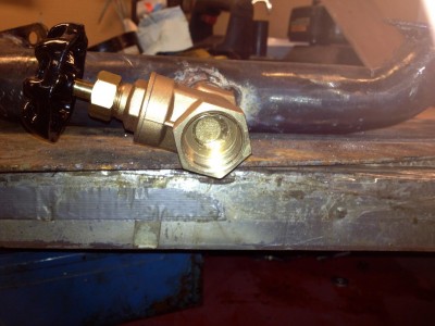

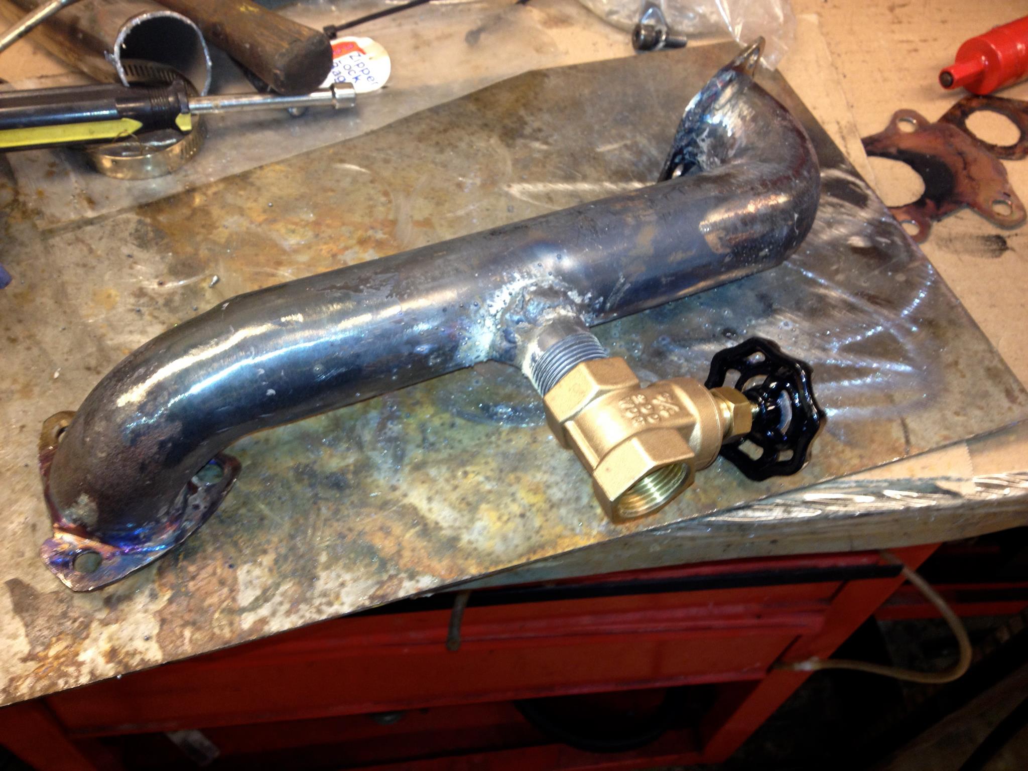

Rather than let this thread or especially this project go dark, I've decided to come up with some solutions that if it doesn't improve performance, at least it will give me positive information as to which way to go. I would greatly appreciate all of your thoughts.
I have decided to take things incrementally. First, I need to find out what the exhaust pressure is and if there is a huge differential between boost. I've included a picture of a valve that I have welded into the header pipe. Obviously this is for test purposes, if it works I'll use a more elegant solution. I haven't tapped the header for a nipple to check the pressure yet but that is next. One thing I hope to do with the valve is as I am doing my road test I will gradually open the valve. Any improvement in performance should give me an answer. Consequently, no improvement or a dramatic decrease in boost should give me an answer also.

The addition of a manual exhaust relief valve yielded no increase in performance. Pretty much what happens when you open it is that boost drops. Normal, relaxed throttle settings (30-40mph in 3rd or 4th gears) produce in between 2 to 4psi of boost. Full throttle and maxing out the rpm until the governor kicks in varies depending on road conditions between 6 and 10psi of boost.
The bike's entire performance envelope appears to have changed. When it was normally aspirated and the injection timing was retarded it pulled well from the lower rpm range but lacked serious strength on top. Now it appears that it the opposite and is a very "peaky" engine. So much so that it almost seems as if I was to gear it down so it will rev high in 5th gear I might be able to reach my target of 70mph. I base this on the notion that at 50mph in 5th gear it could very well simply NOT be on it's power band. Revving it out in 4th gear can get me up to 50mph with about 6psi of boost and then shifting into 5th is like opening a parachute. It starts to sit and dog until it can only pull 45mph with maybe 2psi of boost at best.
So......let me me ask all of you a series of questions: These Yanmar 10 horse engines are designed to run at 3600rpm all day, day in day out. Since it looks like my only hope of seeing power gains through turbocharging is going to come at high rpm's, 1) Anybody have a good means of installing a rev counter/tachometer on these things? And 2) what is a safe red line? 3) Anybody ever tried beefier lower end bearings or tighter valve springs to keep it from exploding?
