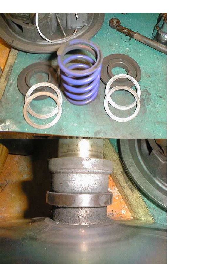

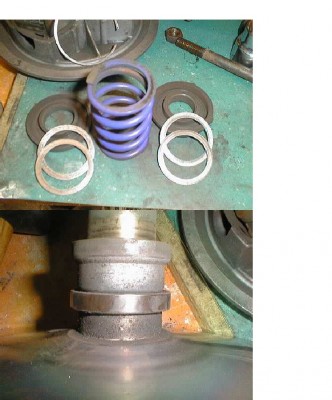

Can you get a 1mm sleeve? Not sure how to lock the sleeve on shaft, though though?
Re: CVT Bronze bush's, Help needed !
if the bush seems to work in principal and helps your belt problems I would suggest getting the 28mm bush. The outside dia is 36mm so plenty of room to enlarge it. 29mm is a funny size maybe an imperial bush might be better?? Anyway you don't want it too tight as friction will make it swell so you might find 30mm works well?
The slack will actually be 0.5mm ie 1/2 a mm so it might be just right. The belt stretch will be 3mm.
Bearingboys do actually list 29mm needle roller bearings but the outside dia is 38mm?? :D ie 4.5mm belt stretch.
The aixam microcar cvt has a very thin width roller bearing which is roughly 1/4" wide(I'm old so I don't do metric lol) which sits centrally under the belt. The belt is quite wide so it doesn't fall off.
I'm not familiar with the comet but will bush width interfere with the pulley movement as it moves in??

gilburton wrote:if the bush seems to work in principal and helps your belt problems I would suggest getting the 28mm bush. The outside dia is 36mm so plenty of room to enlarge it. 29mm is a funny size maybe an imperial bush might be better?? Anyway you don't want it too tight as friction will make it swell so you might find 30mm works well?
Hi mate, you've been a big help with this one, THANKS ! After looking at your pic I went low tech and got on the lathe, I quickly realised that the bearing I bought was to big (thick, by 1.5mm !) and this would restrict the front pully advance, I then turned my 20mm long bearing to 15mm, put it on and took it up the road...30 MPH max speed (on another note I, on my build thread for this bike I was trying to restrict my top speed to 30 MPH incase speed / or overheating was a factor in my drive belts breaking, and I just could'nt do it.....untill now, you simply have to stop the front pully from engaging fully ! :) , then I got it back on the lathe and reduced it to 10mm which equaled a top speed of 35 MPH, then back on the lathe till 7mm which gave me 41.5 MPH, I've still got my throttle screw right in so I can get a bit more speed out of it by opening my throttle a bit further but for now I'm confident that the front pully is opening to the full and I'm getting the best performance possable out of it. When its ticking over now the belt simply rests on the bearing and does'nt wear out ! I'm very happy about this and feel confident enough to go the 20 mile drive to work on it tomororow :) , in the style of Arnie....I'LL REPORT BACK.
