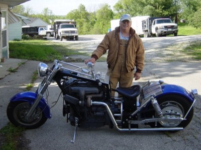

I think it's safe to assume you're not going to shoehorn the V-dub into that FJ frame - even with a liberal dose of vaseline. The 1.6/1.9 is no small engine by bike standards. Stephan Sanderse's 1.6 is a favorite of mine. Viewed below if you haven't seen them before.

As much as I love the VW, I'm with Coachgeo on this one - go with a 3 cylinder. The Daihatsu/Briggs is not real plentiful here in the states and typically comes at a rather dear price. Don't rule out the range of lowly Kubota's. Numerous current production 3 cylinders from which to choose with parts available just down the street at your local Kubota dealer.
Here's an example of the kind of used engines that can be found on Craigslist (although I might be inclined to go with the 905/1005 or 1105 for more power.
http://wyoming.craigslist.org/pts/3054467927.html (edit: link no longer available)
You might even find an example that would fit the FJ frame. They're pretty small. For example the 722 is 17" long, 16" wide and 22" tall. And those are the manufacturers dimensions which can often be reduced with a bit of repositioning. The one thing the FJ frame can tolerate is heigth.
