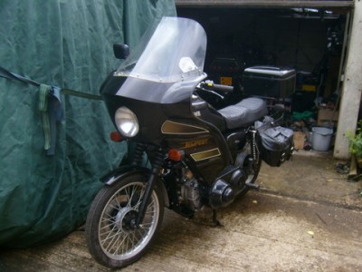

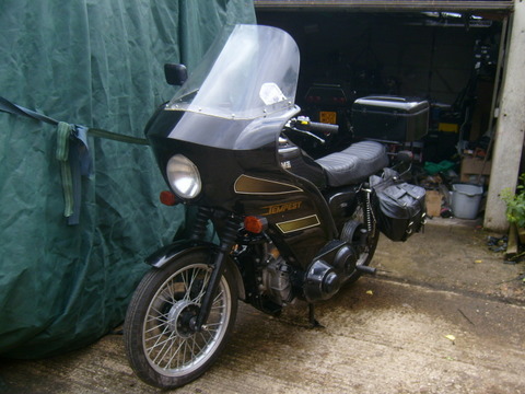

Here is the latest pic. Due to the amount of rain we've been having I bought a fairing from ebay. If it keeps raining the next step will be flotation devices

Very nice. Does this fairing help with the topend at all, or does it just keep you dry?
Re: mz diesel
I don't think it helps top end but it certainly keeps me dry
A new cvt belt will probably help more
As a bonus I now get warm air over my legs from the cooling fan.
I actually bought 2. I have a white one as well. It's a Rickman fairing and it came with the main fitting for an ETZ250 although I had to make some minor fittings and modify the main support which runs under the MZ beam frame as I've added a down tube which the MZ doesn't have.
It also helps disguise the cvt on the left side.
