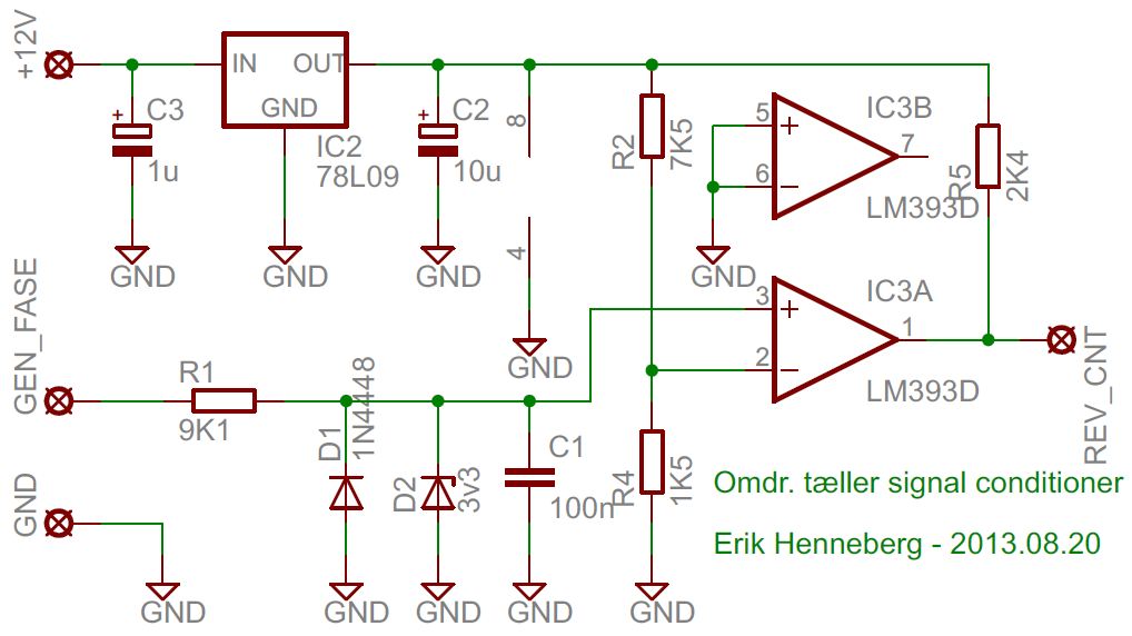

The ABS sensor is an option and might give a better defined electrical signal, compared to the generator AC signal.
I have used one of these rev. counters: http://www.ebay.de/itm/271664328045
I made a small road trip video with the rev. counter: http://www.youtube.com/watch?v=b4UsIn5QLxk
The rev.counter can easily be programmed to fit the actual sensor/generator frequency.
For the sensor signal, I used Ruggerini MD151 generator output, but a small signal shape / conditioner electronics was needed to be designed:

For the particular rev.counter, I made a precise test (magnet, hall sensor + oscilloscope ) rpm on the engine, and the rev. counter fits within +/- 50 rpm.
Perhaps I was lucky with the manufactures calibration ;)
