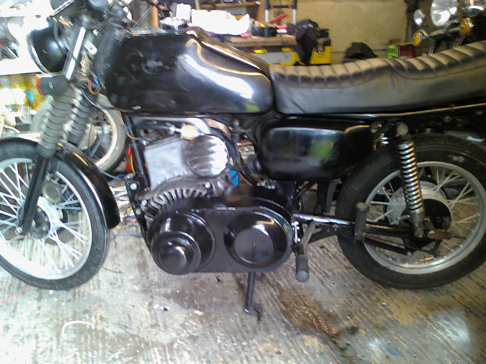

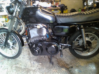

After a long delay I've made an effort this year and the bike is nearing completion MOT test.
Can you see anything unusual about the belt/cvt cover??
I made the main part from the rear panel of an old cooker. The front "bulge" is a stainless dog/pet bowl topped with the lid from a coffee tin. The rear bulge is just a plastic plate. It doesn't do anything but it makes the cover look less bulky :D
Recycling at it's best? Not really I hate spending money,well, I am Scottish :lol:

Looking very neat! What engine is that?
Re: mz robin
It's a Fuji Robin Dy41D I couldn't get the "more powerful" lol DY42D :D

This engine used to be widely available and was fitted to quite a few MZ's, Enfields etc.
The transmission is from a French Microcar which came up on ebay and is indeed cvt. It is very similar to the CVTECH system as sold by gemini karts in the uk hence the bulky look.
I'm not quite happy with the looks on the r/h side. It would be ok in a velocette though :D I'll work on that,maybe some sort of trail bike skid plate?? I'll have to protect the starter anyway as it's a bit vulnerable.

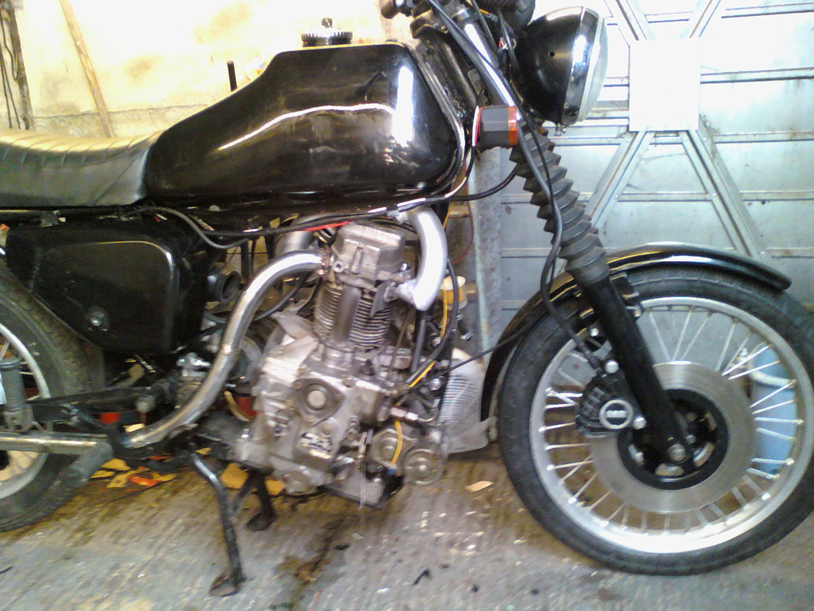

Just a few more odd jobs to do and integrate the excellent MZ chain guards into a cover for the rear sprocket/jackshaft. Spent a ridiculous few hours yesterday on modifying(big hammer etc.) the rear brake pedal as it was fouling the footrest/exhaust.
It's always the small things that take the time.
I've also now fabricated a cover for the starter. I didn't have enough left from the cooker so I scratched my head a bit and "eureka" An old bread bin that was lying around. It made an excellent cover.
H'mm the other half of the breadbin might do for the sprocket cover!! :wink:

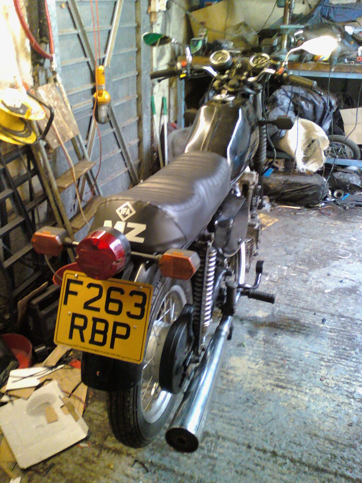

I had my first run on the road today. Just a quick run around the block as the bike is not yet legal.
IT WORKS :D
The engine feels a bit weak and the idle is a bit high. This may be due to the non standard filter fitted as the revs were higher after fitting.
I'll also have a look at the fuel delivery as the universal fuel filter is on its side and doesn't appear to have much fuel in it. I may try mounting it lower down and vertical.
Overall I'm pleased with the result and it works well enough to get it tested and legally on the road so that I can tinker before using it further. :D
