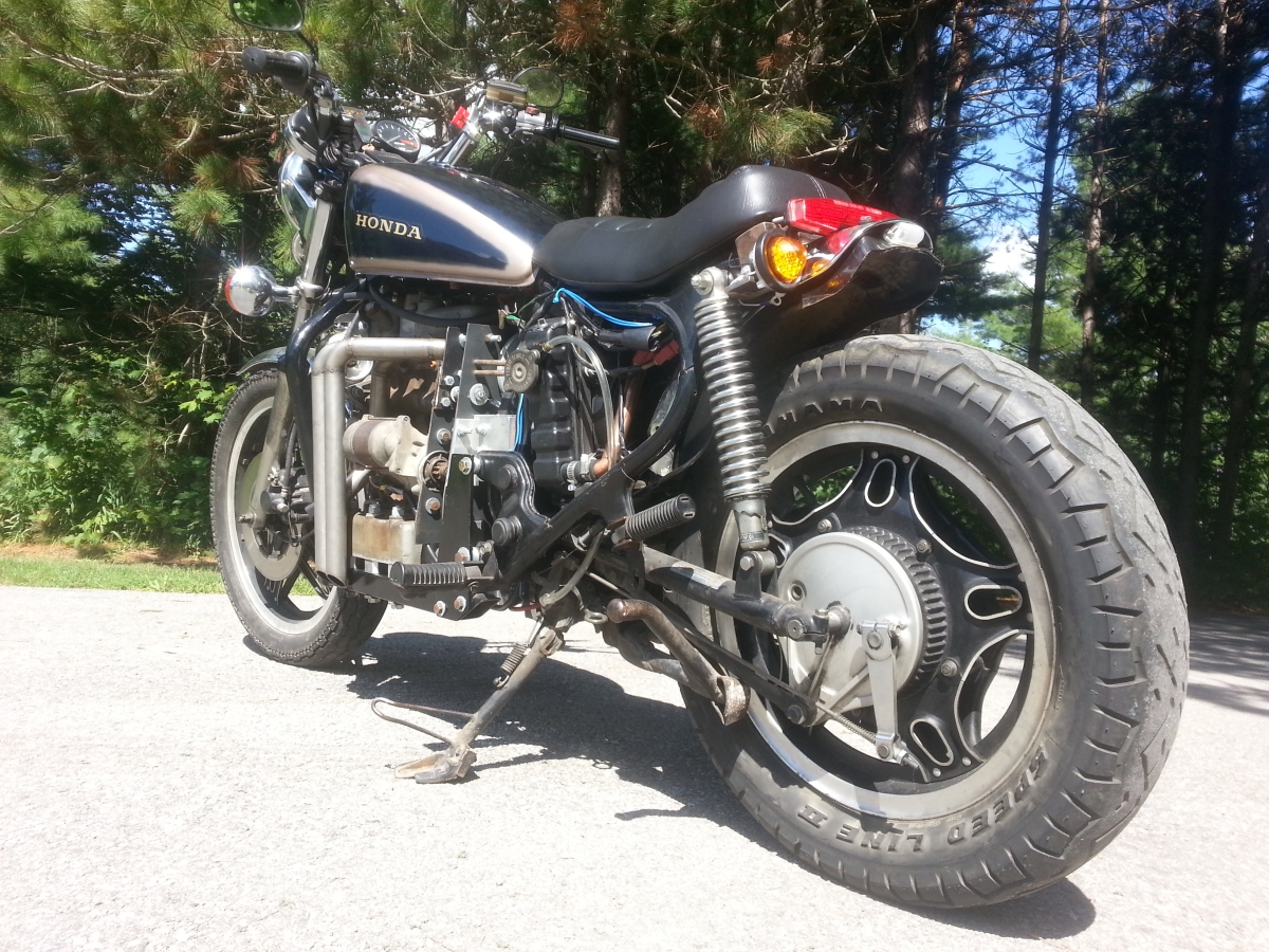

Hi there, I have finally got around to making a build thread. The bike is already complete, but i figured I's show the process/progress pics to provide info/help to future builders and possibly get some advice for future modifications form the knowledgeable people on the forum. Thanks goes out to pietenpol2002 and coachgeo for offering help during the build. Please see the thread titled "Reefer Unit Kubota D722 into Honda CX500" for my previous posts. The bike was completed at the end of last summer too close to the end of the riding season to be worth putting on the road. Unfortunately I was too busy this summer to put it on the road. Plans are to build a second bike of simpler design (chain drive instead of shaft), and put this one on the backburner until that is done. The reason for building a second bike before putting this one on the road is because I intend to replace the D722 with a Z482 which I have aquired, and then to use the the D722 in the second bike. The reason for this is that the D722 was a shoehorn fit into this frame and caused the drive system to be mounted within the rear subframe mounts, which create a u shaped cavity if viewed from above (please see pictures) . This means that although it works fine, it is a lot of work to service and adjust (complete engine removal). My thinking is that the Z482 is short enough that the drive system will be mounted just in front of these mounts, therefore I should be able to unbolt and remove it out the side.
I will be uploading pictures very soon. Please check out the video I took of the first shakedown run. Please read the description.

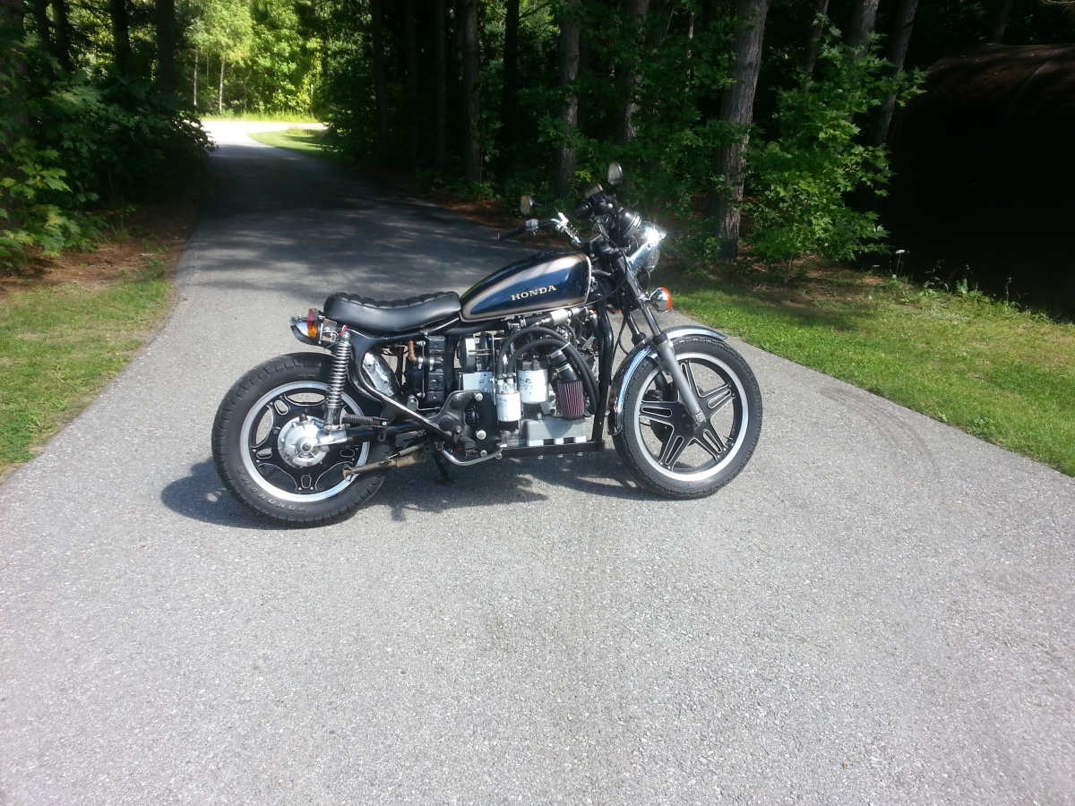

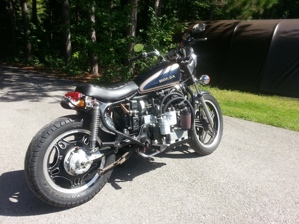

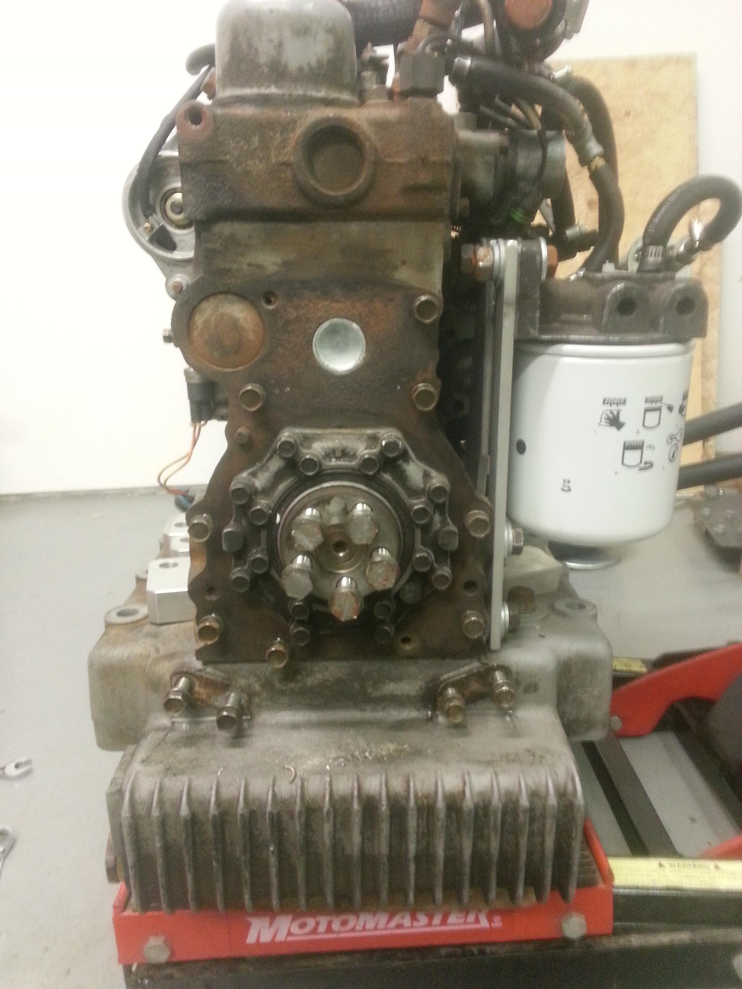

Re: CX500 Kubota
How are you connecting to the shaft drive? Chain and sprocket or Honda tranny grafted on orr?
Is the second filter for an oil cooler or big fuel filter orr?

The drive system is fairly complicated.
An 80 tooth htd pulley mated to flywheel drives up to a 40 tooth htd pulley. On the 40 tooth pulley shaft is a comet 40 series primary which drives down to the secondary. On this secondary's shaft is a 10 tooth sprocket which drives over to a 16 tooth sprocket on a shaft which is mated to the shaft drive through the stock u joint. I didnt drive the cvt right off the crank because I didnt have enough room to fit a cvt large enough to handle the torque of the engine. This is the reasoning behind the 2:1 ratio of the htd pulleys, the torque is reduced by 50% allowing me to use the smallish 40 series comet. The sprockets after the cvt are used to get the correct final ratio as the ratio in the shaft drive rear end is fixed.
One filter is for the fuel, the bigger one towards the front. The other is the oil filter which I had to remote mount due to the stock location being right behind the front frame tube. You can see this best in the third picture I posted. The lines from from the oil filter connect into the block behind the tube there through an adapter. I did discover later on that the D722 has an alternate mount on the other side, however my exhaust is in the way.

Re: CX500 Kubota
Im sure the two smaller filters could would work. Good idea. A belt could have been used in place of the chain for this general design, however not in my case as I didnt have enough room. The initial belt is at the limits of its torque capacity and is 30mm wide. If a belt were used in place of the chain it would also have to be around 30mm to handle the torque due to speed reduction (and torque multiplication) through the cvt. Like I said this could be made to work no problem, it just wouldn't have worked for me as I did not have the room for an inch wide belt vs a half inch wide chain. Every single piece of my drive system was machined/mounted in a way to compact the drive system depth wise.
-using belt just wide enough to handle the engines torque
-using comet 40 series clutches which were both machined to reduce depth
-portion of secondary clutch sits within centre of hollowed out flywheel/80 tooth htd pulley assembly
-thin but adequate bearings were used
-chain instead of belt for final drive to shaft
-mounting brackets mounted within very tight tolerances to moving parts
This brings me to your question. I did all of the above to fit the drive system within the space I had between the engine block and main frame tube with the engine as far forward as I thought reasonable. The whole drive system from block to the back end which is practically touching the frame tube is 7". It was very frustrating trying to make it fit in this space but i am happy with the end result. I could have used a chain instead of the initial belt but at he time felt a chain spinning at engine speeds would need good lubrication (messy), and be loud. The belt solved these issues. If I could go back and do it again I would probably use a chain and put up with the mess from keeping it well lubricated (drip feed?) because the HTD pulleys I used were very expensive and took a good chunk out of my available room. If you had the room and the money factor wasn't too much of a concern I could see a double belted system such as you suggested being very nice. I am not sure if 7" is shorter or longer then say a BMW tranny such as mouse used but I am also curious to know.

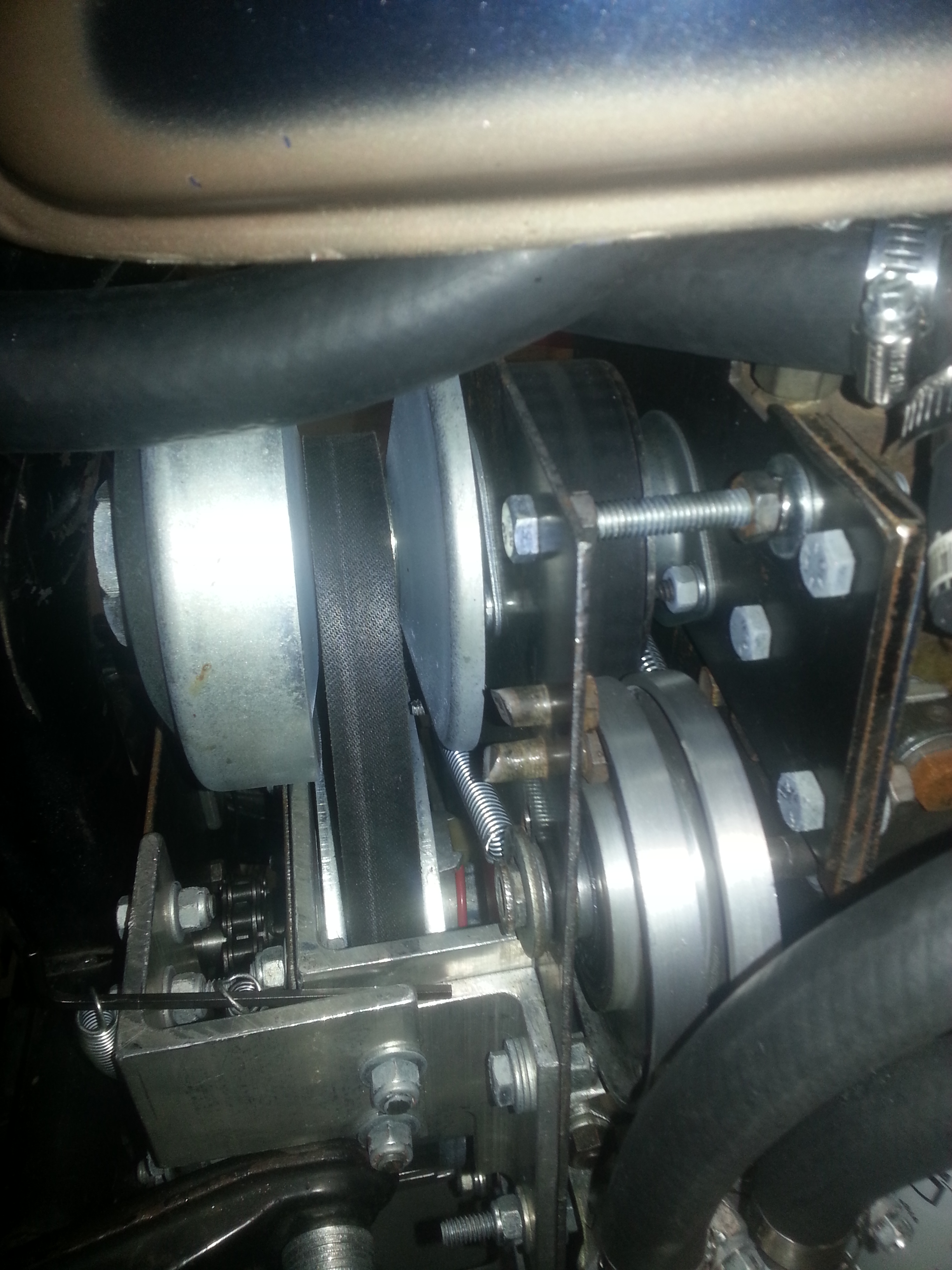

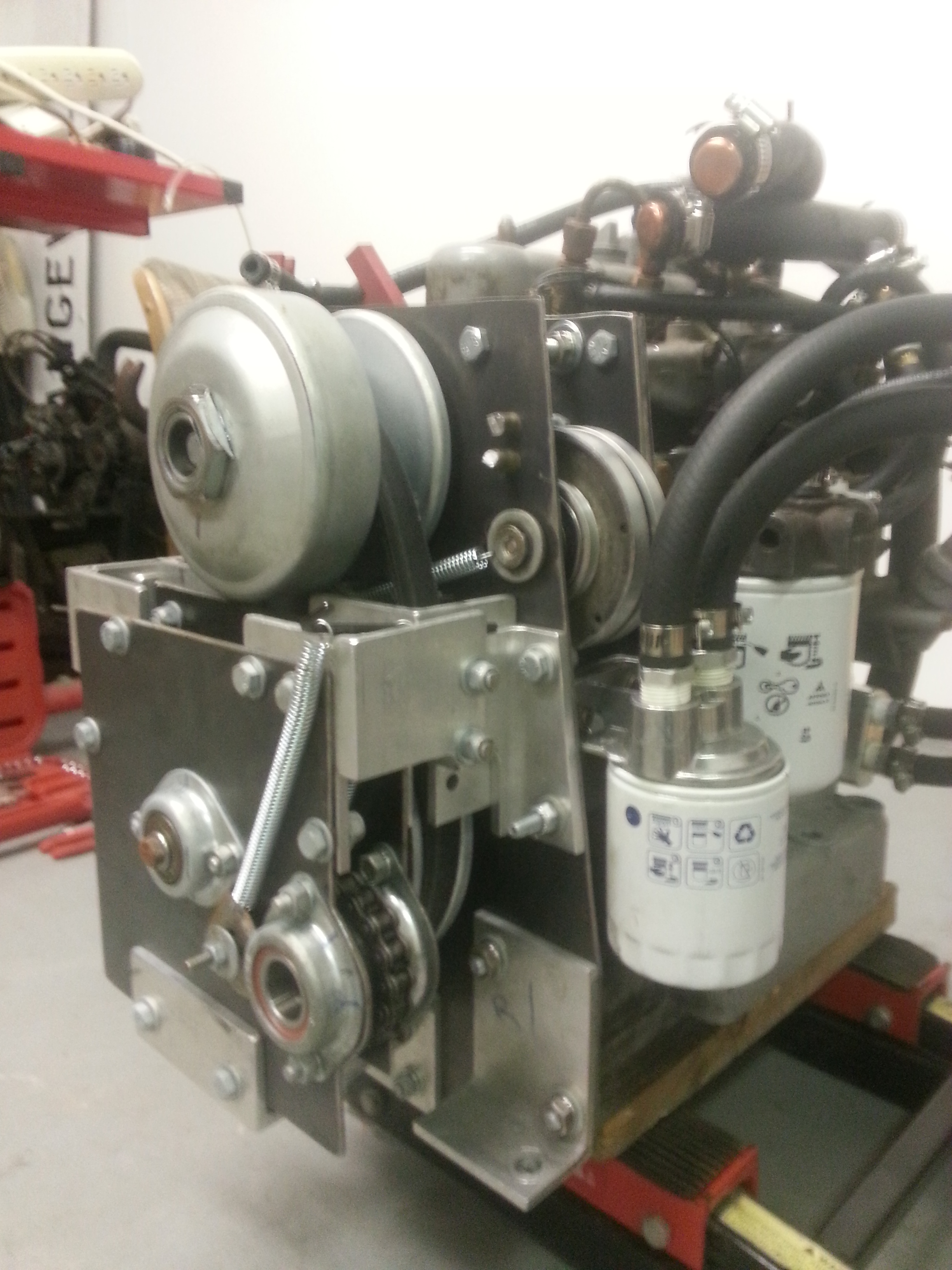

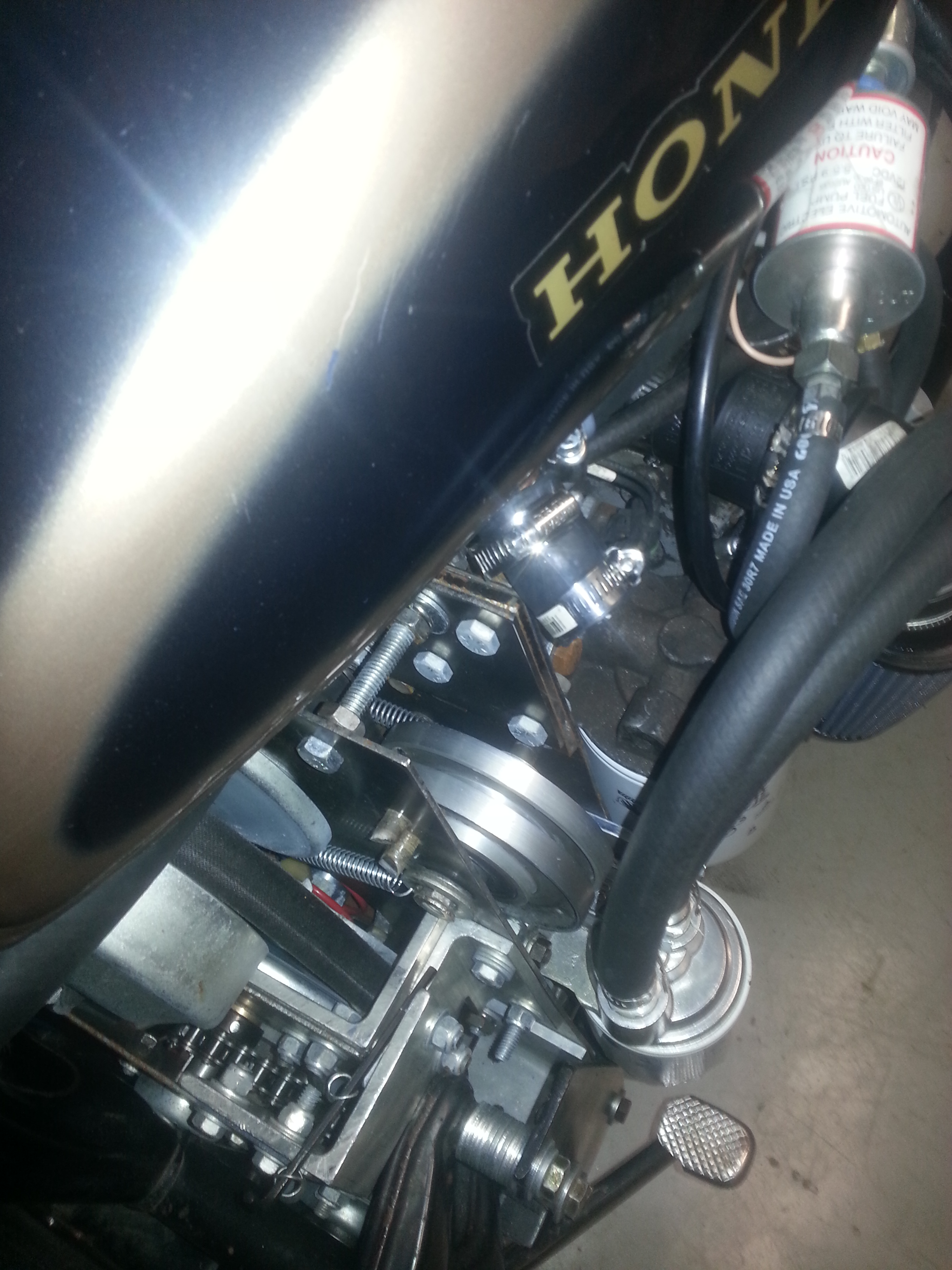

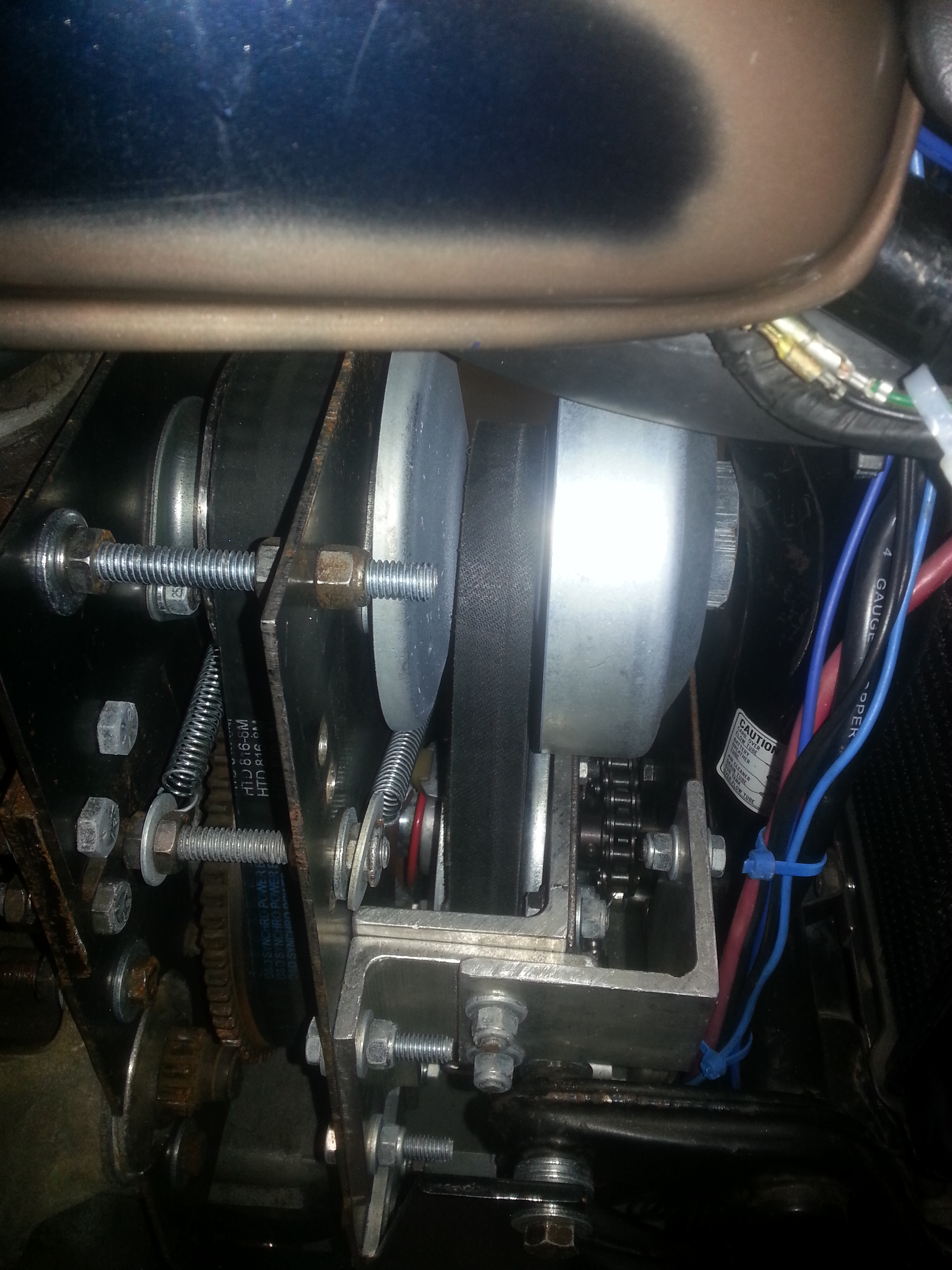

Re: CX500 Kubota
when you get the opportunity would you please take a pic(s) of what can be seen of your belt/cvt/chain arrangement along with descriptions. Sounds like a work of art.
- Posts: 93
- Joined: Tue Jul 02, 2013 4:38 am
- Location: Mansfield, Ontario
Re: CX500 Kubota
For sure. I will get some up later today.
- Posts: 93
Re: CX500 Kubota
Right side:
Ignore the cut bolts, they were for a reinforcement bracket which I determined wasn't needed and the idler pulley needs to be removed to take them out. For the sake of the pictures I just cut them. The right side bracket was used to anchor the chain tensioning springs and is no longer there, hence the allen key slid through them to hold them out of the way for now. Left Side
- Tetronator
- Posts: 502
- Joined: Mon Apr 07, 2014 11:50 am
- Location: Amsterdam
Re: CX500 Kubota
That there be some sturdy engineering!
- Posts: 93
Re: CX500 Kubota
Thanks it took a lot of machining and repeated assembly/disassembly to get it to work.

Thanks for the compliments. Sorry for the slow reply. I do not have any knowledge of that bike. Looks very interesting. My money would be on a z482 and cvt like you suggested.

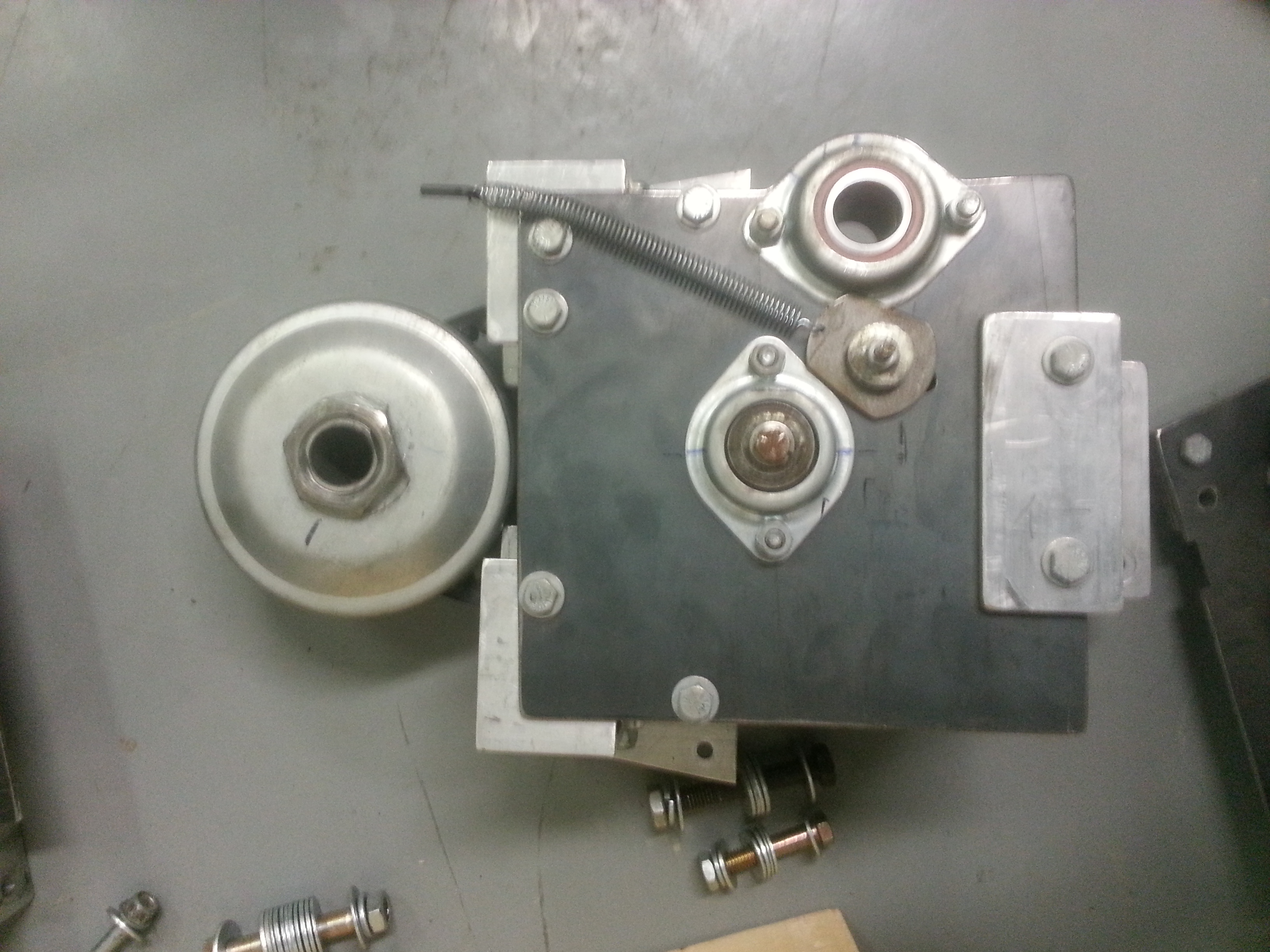

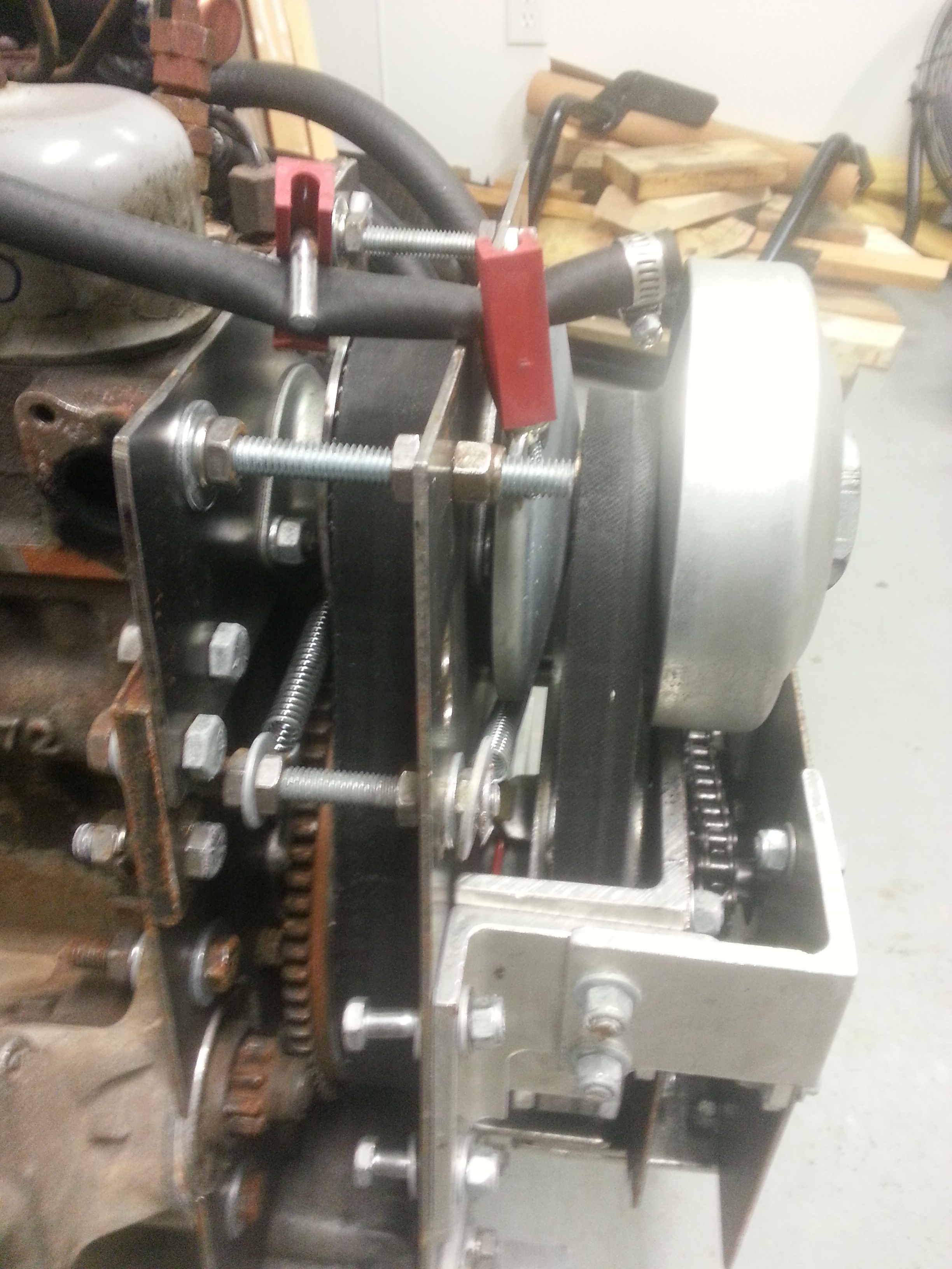

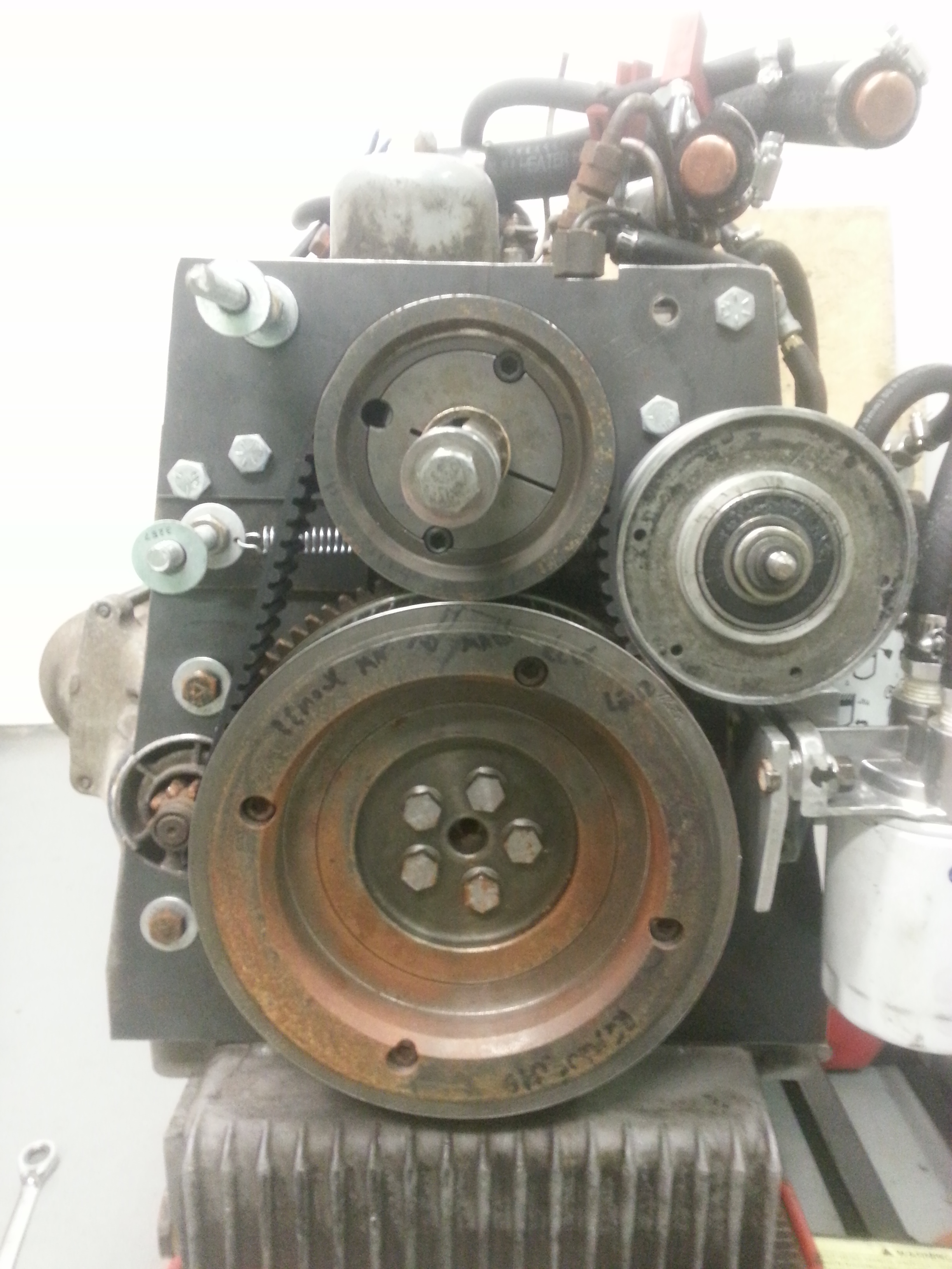

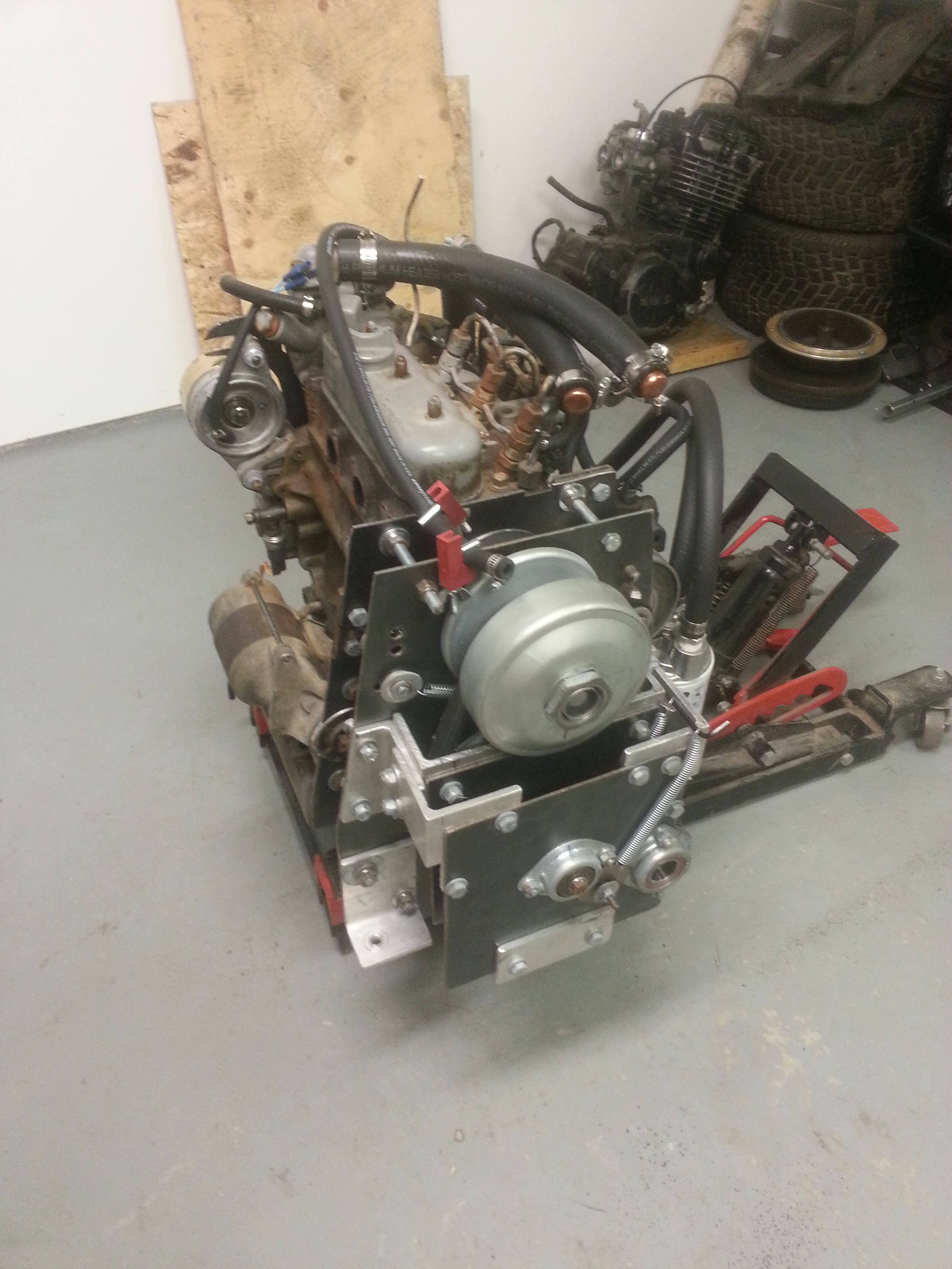

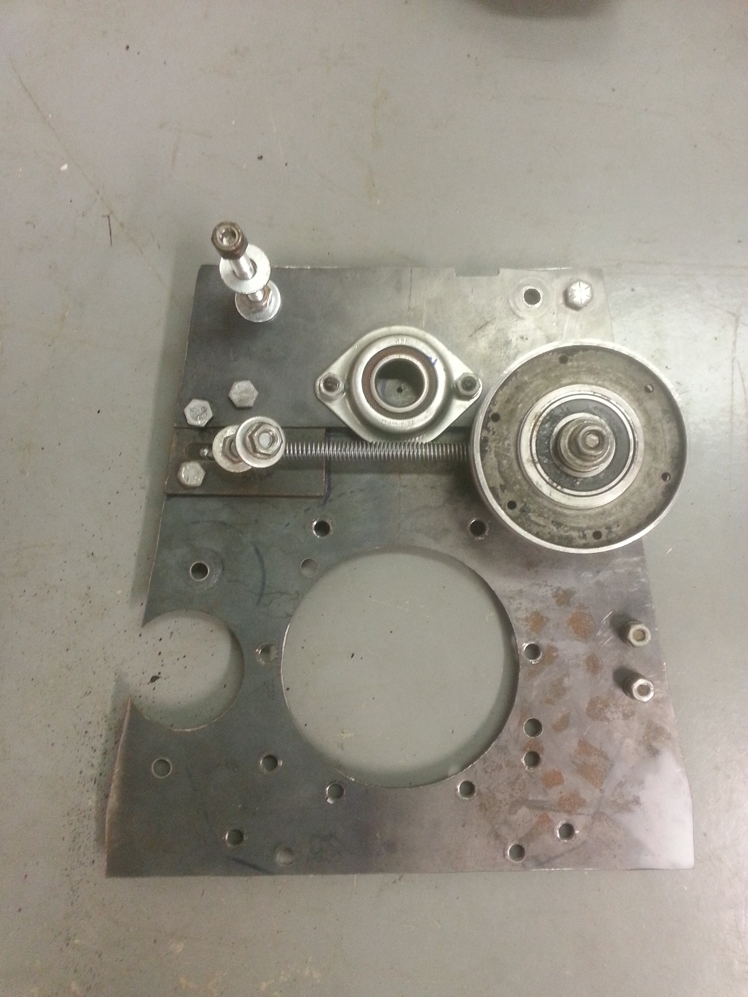

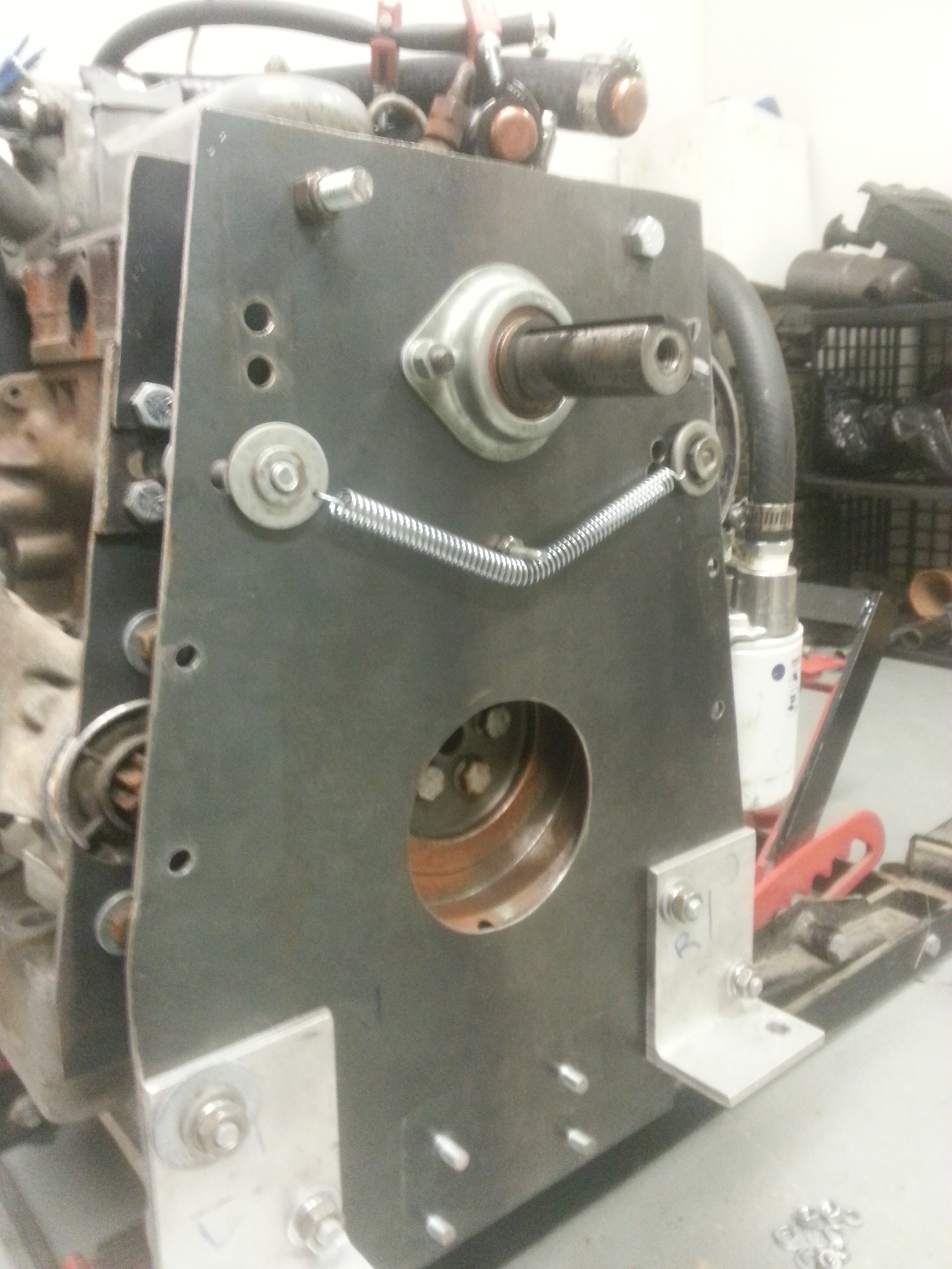

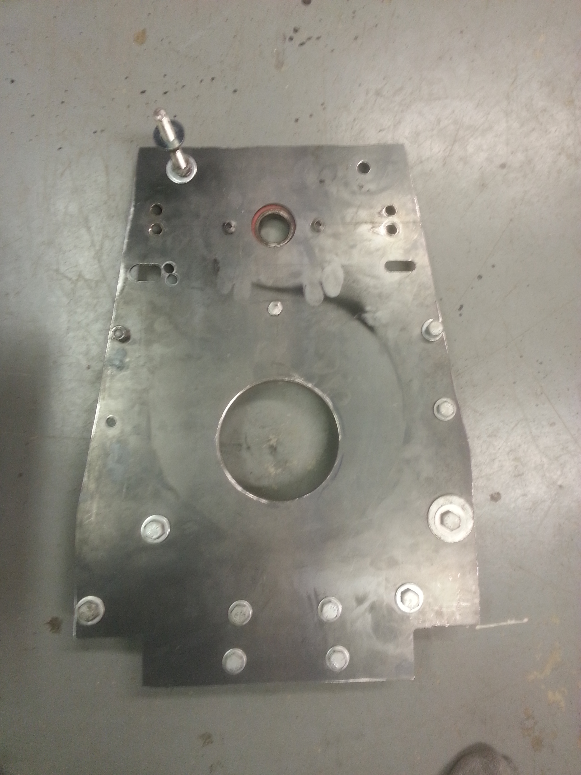

Dissassembled the bike today in preperations for building the second bike. As mentioned before, this d722 will be the powerplant for the second bike and the first bike will be rebuilt/refined with a z482.
Took some pics as I removed the drive system piece by piece.
Re: CX500 Kubota
Thanks for those detailed pics. Always helpful to study how someone else puzzles through the design process. Again, an excellent piece of engineering. Which then leads to the question - and what form will your chain drive take? Do you plan to use a CVT? A gearbox? And the engine - transverse? North/south orientation?
