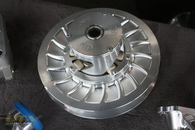

The video i was going to make has to wait. I put a new belt on my track and didn't have to take my secondary apart.
But where a normal cvt Just goes to it's highest ratio based only on rpm.
The torque feedback type (through the secondary) actually increases the secondary spring force and cause it to shift back without loosing rpm.
The two sheaves of the secondary can rotate on the radius. One side is directly connected to the output shaft and the other to a helix which increases or decreases the spring force of the secondary.
When the pull on the sheaves increases the spring will tighten up and push the belt up. Causing the ratio to rise. And the rpm of the engine to increase with the same rpm on the output shaft.

BertTrack wrote:...Shall i make a vid of that explain the function? (CVtech)
Well guess Im not understanding how CVT works as well as I thought, In particular the Driven/Secondary pulley.
http://www.umaine.edu/MechEng/Peterson/ ... report.pdf
So the Torque ramps are the slope's /Ramps that are cut into a cylinder that is part of one of the sheaves of the Driven/Secondary pulley. They play a part that push the sheves apart by RPM's centrifical forces causing (in this case) rollers to move up the ramp (against spirng forces) which spreads the sheaves? Did I get it?
BertTrack wrote:...The two sheaves of the secondary can rotate on the radius. One side is directly connected to the output shaft and the other to a helix which increases or decreases the spring force of the secondary.When the pull (of the belt?) on the sheaves increases the spring will tighten up and push the belt up. Causing the ratio to rise. And the rpm of the engine to increase with the same rpm on the output shaft.
helix is the rising circular path of the ramps around the cylinder cut into it of one of the movable sheave's. Like threads in a bolt.
Think Im getting closer to understanding this.
http://en.wikipedia.org/wiki/Helix
Note: scooter CVT's secondary/driven pulley seem to work a little different. Have not gotten this tied down yet either
Posts: 328
Location: Netherlands
Re: Some CVT ideas
Post by BertTrack » Wed Nov 07, 2012 6:18 pm
Ah! If you look at your picture.
The rolls are connected to one of the plates. And the helix material to the other.
The power take off will be directly connected to one of the plates.
The two plates can rotate independently from one another until of course the rolls hit the end of the helix part.
As they rotate it will cause the spring on the secondary cvt to tighten or loosen.
A scooter cvt will not vary the secondary spring force. Which will allow the ratio to shift only based upon the rpm of the primary.
Where as with this secondary system the increase in torque needed (headwind) will allow the cvt to downshift and the rpm of the engine to increase while the output rpm doesn't change much.
