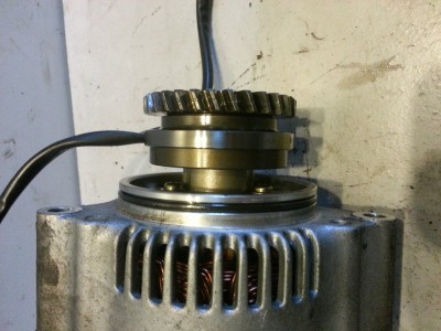

I use a Suzuki charger with a pulley brazed / welded to the output flange.
35A which is almost 500W.
Approx. £25 so cheap and plentiful on the 2nd hand market.
They need two wires one to the battery and one to the ignition supply.

Looks like found a Suzkie alternator as well. This Kubota had no alternator on it. Was not sure if a thread here in electronics was referring to a Suzuki car or motorcycle Alt. A PM from Petenpole seemed to say it was motorcycle. It was he that pointed me to one on EBAY. Money on the way to that seller for that now too.

Mouse..... I assume from another's comments that is a Suzukie motorcycle alt. and not a Suzukie car alt. Took gamble and bought Motorcycle one off ebay, pointed out to me by Petenpol. It's unknown condition.....Mouse wrote:I use a Suzuki charger with a pulley brazed / welded to the output flange.
The one on ebay has a gear attached. Does it pull off or did you cut it off orr?
Also the Katana 600 it comes from runs at a much higher RPM. Did you calculate the size of your pulley to keep the RPM's of the alternator similar?
Looks like an O-Ring on Alt. Does the Alt need a cap made to snap over the end to keep junk and water out?
Is it a Generator or Alternator thus needing something else to wire it up? Dc to Ac converter?

Yea, its from the larger GSX bikes. All the same as far as I can tell. I should have said but was a bit hung over when I wrote that.coachgeo wrote:Mouse..... I assume from another's comments that is a Suzukie motorcycle alt. and not a Suzukie car alt. Took gamble and bought Motorcycle one off ebay, pointed out to me by Petenpol. It's unknown condition.....
There is a cush-drive under the sprocket and that is held onto the alternator with a nut and taper shaft. See the photos....coachgeo wrote:The one on ebay has a gear attached. Does it pull off or did you cut it off orr?
.coachgeo wrote:Is it a Generator or Alternator thus needing something else to wire it up? Dc to Ac converter?
It is an alternator with integral rectifier and regulator. It is also easy to wire up as the thicker wire goes to the battery and the thinner goes to switched ignition.
I geared mine to somewhere between 2-3:1 because I had pulleys for that. I didn't aim to get it to be spinning as fast it would be in the bike and it worked with no problems. Also note that most petrol bikes don't spend much time at the top of their RPM range so I don't think there is much need to get the extra speed.coachgeo wrote:Also the Katana 600 it comes from runs at a much higher RPM. Did you calculate the size of your pulley to keep the RPM's of the alternatorimilar?
Yea, the oil ring is because the gear end of the alternator is inside the bike engine and needs the seal. I never bothered to waterproof any of it because the alternator is external to the engine and is generally exposed to water / salt and grit as standard. It is however behind the engine which would shield it a bit. The shaft bearing has double lip seals so they will keep the water out.coachgeo wrote:Looks like an O-Ring on Alt. Does the Alt need a cap made to snap over the end to keep junk and water out?
This is the back of the cushdrive and a small pully ( I think from a car alternator) with the centre hole enlarged to fit over the centre.
Then simply braze or weld it on.
Make your own mind up how to tension the belt. This is how I did it on the V twin but on the current Kubota Z482 I use a sliding idler wheel. (Note that the minimum radius a belt will work with is larger for a back side tensioner.)
Just be sure that the pullies are in alignment and there is sufficient adjustment for the belt to wear a bit. I found my local industrial bearing and pulley supplier helped me to select the right belt. I then bought spares from ebay

I'm cutting a mounting notch in the alternator for mounting the Alt low and close. And initial mock up shows the Alternator caps it to be a good swap.
One More Thing!
Oh and I wired the Suzuki Alt so it will plug into the Triumph wiring harness when we get to that point.
I'll be running the alternator to my Sub Contractor and get them to test the Katana Alternator to make sure it works. (Same Shop that rebuilt your Rabbit Starter George.)
Re: Kubota Charging system from scratch
Figured it was a long shot but one should never assume LOL. Think it's Texas LOL. Had problems accessing the board at various times in TX too. After moved; no issue. Must be the server's in the south have an issue with the server's that it pipes thru to get to TX?Curtis in Texas wrote:....Got no clue why it's like this. That last post stuck after 2 shots.....We'll see how many this one takes. Don't loose any sleep over it George. ...
Interesting about the covers. Thanx for aiming your keen eye on the little things as this progresses!!!
