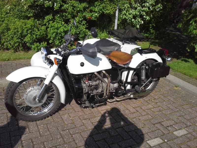

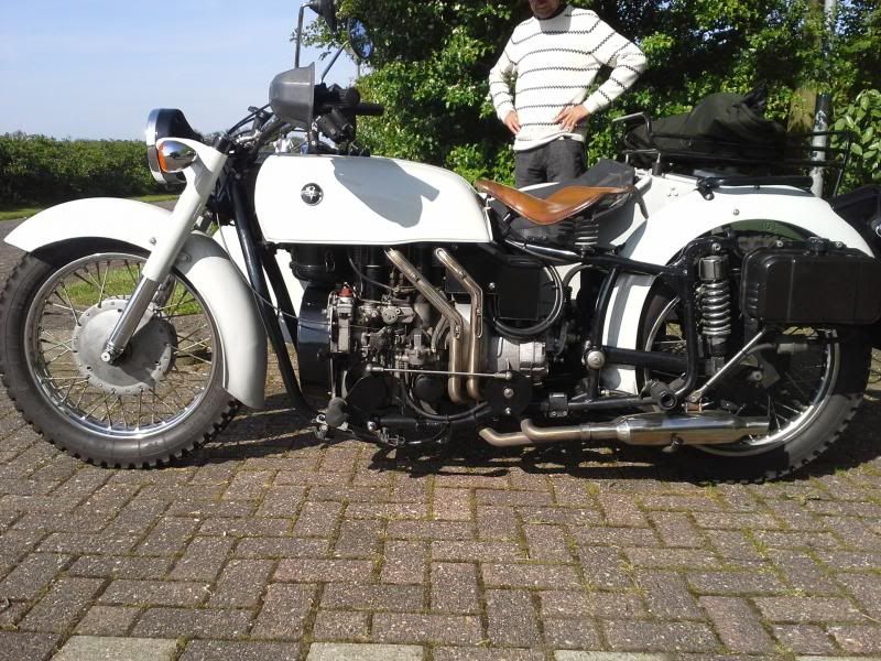

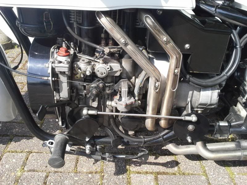

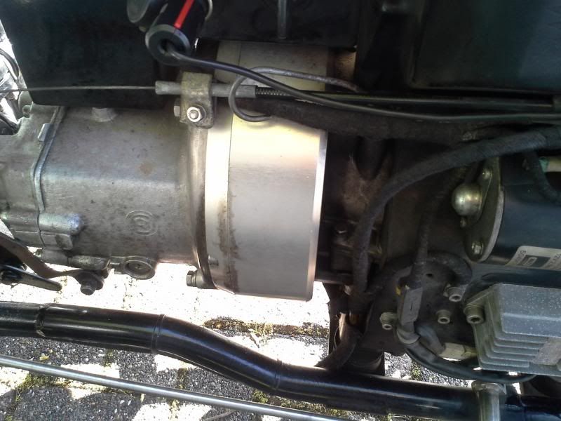

So I'm thinking you want something like this;
Tetronator wrote:I went to the rally and took some pictures!
I got there first so I got to see all the arrivals, the first to arrive was this gentleman and his daugther from Germany, (I forgot to ask his/her name sadly enough), on his Hatz 2G40 powered Dnepr MT10-36 from 1979 with an BMW r1050 Clutch. :shock: And also a really cool fuel tank. (He wore a big knock 2012 T-shirt!) He also gave permission to upload these photo's on to the site. (If an admin would be so nice as to do this).
I know it looks a lot like the LOËW build but the man build this himself, he told me he didn't like the fact that LOËW did not put the engine on rubber dampeners. :)
https://www.dieselbikeforum.com/view ... f=4&t=2787
Trow me some questions, I might be able to answer them.

No problem, guess you ran into the same problem I have... I live in the Netherlands... :(
The Ruggerini looks like a good choice although I think you will get into problems with the length of the thing.
Dutch laws prevent me from stretching my bike too much. Don't know what Irish laws have to say about it but I think you will also have problems reaching the handle bars.
The Dnepr clutchpack/Flywheel is going to use up a lot of space but it will work, has been done on numerous bikes and different engines.

I kept the Ural clutch / flywheel (same as Dnepr) and machined it to fit my engine - a Daihatsu. It runs in fresh air and makes a hell of a noise when disengaged, but works fine! Apparently a single-plate diaphragm clutch from a 60s BMW has the right splines for us, can be made to fit and would run quietly - but I was too tight to go this way when I have a pile of Russian parts in the shed.
