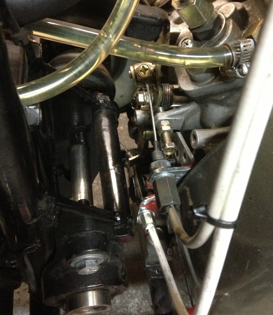

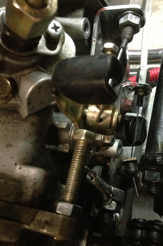

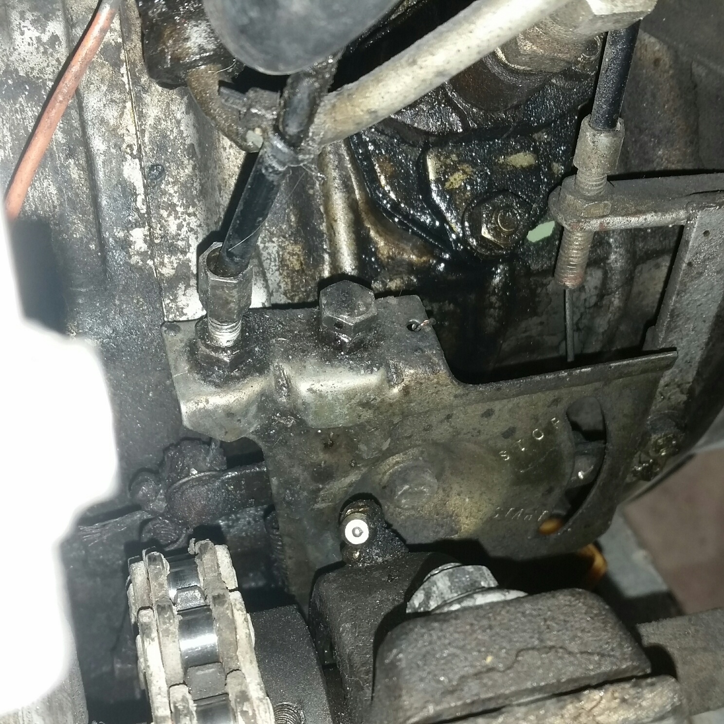

Well, rode the KLR a bit. The hand throttle allows the fuel to go all the way down to shut off. Made it a high learning curve to not accidentally shut her down. Hard lesson to learn fast when the battery was low from sitting and bike could not be restarted. (rope pull presently broken recoil spring). Knew I had to do something about that.
Many iterations of trying to re-incorporate what Sparky had once done. I finally gave up on trying to make a spring loaded lock that would pop into place when hand throttle got turned just enough to keep her at idle. This had rattled off long ago. When got done ended up that some Changes AFTER Sparky made the original Spring Pin it ended up holding things at FULL THROTTLE. .... Good 10 hours wasted.
This morning I created a new location for just holding it at idle. Now I have a screw in post with a spring. Hoping the spring keeps it from rattling loose while driving. So at start up you move the throttle and screw in this throttle stop. Hold the Compression Release open (nice thumb choke cable Curtis installed) and hit start. She fires right up and idles nicely. When at destination, unscrew the stop so hand throttle can go all the way home .... whala, bike shuts off.
Yeah.... I can just shut down with the compression release but... have read that is not good for the engine. Am I correct that throttle all the way home on Yanmar Clones is something like a fuel shut off which is why she shuts down?
Photo. Black bolt with black fuel line (spring mentioned above is under that) is one installed to hold idle. Empty hole below that is where Sparky had installed a pop in pin to hold at wide open.
. PS- She barely gets to 50mph. Already picked my routes to work that are neighborhood-ish / back-way that makes those speeds doable. 15min drive or so.
Today Curtis and I load everything in a Uhual for my trip starting around 5 am tomorrow. Starting early to avoid Dallas Traffic. It will be a two day drive.

You should have 2 threaded stops on the regulator (there are several different types so the location can change from top to side), one will be the max rev and the other the idle setting.
The max fuel is usually from the bottom or LH side (when viewed from the rear of the motor) so easily identified, on the proper Yammer's this is a sophisticated bit of kit with a thermal wax element for cold starting enrichment - on the clones you just get a bolt.
I'll see if I can get a picture or 2.

Diesel Dave wrote:You should have 2 threaded stops on the regulator (there are several different types so the location can change from top to side), one will be the max rev and the other the idle setting.
Question still remains..... is shut off typically done by getting her to drop below Idle to shut her down. Im going to feel stupid if your suppose to use the compression release. My Kubota contacts have always said compression release shut down was bad for engine. Maybe that is just a Kubota or multi cylinder thing?
I did see that where where adjustments on the lever at the back of the engine. Curtis said he had already set them as best as possible.
Look forward to your info. Will be interesting to compare them to help see what Sparky did to install the twin cable (push pull) hand throttle vs OEM. Do recall someone posted in the past how to redo some things with the linkage to make it more of a throttle and less of a rev. maintainer (is that right description?) of these industrial use engines.

Is that a single cable throttle control? One on this bike is dual cable. Curtis said that was a safety feature so if throttle cable breaks one can still throttle down and not be stuck at wide open.
Mine also changes speed a smidgen when turning
Anyway.... got some pics and even a video of what I have. Will see about uploading. I'm on realllllll slow internet.
Pic is from flywheel side

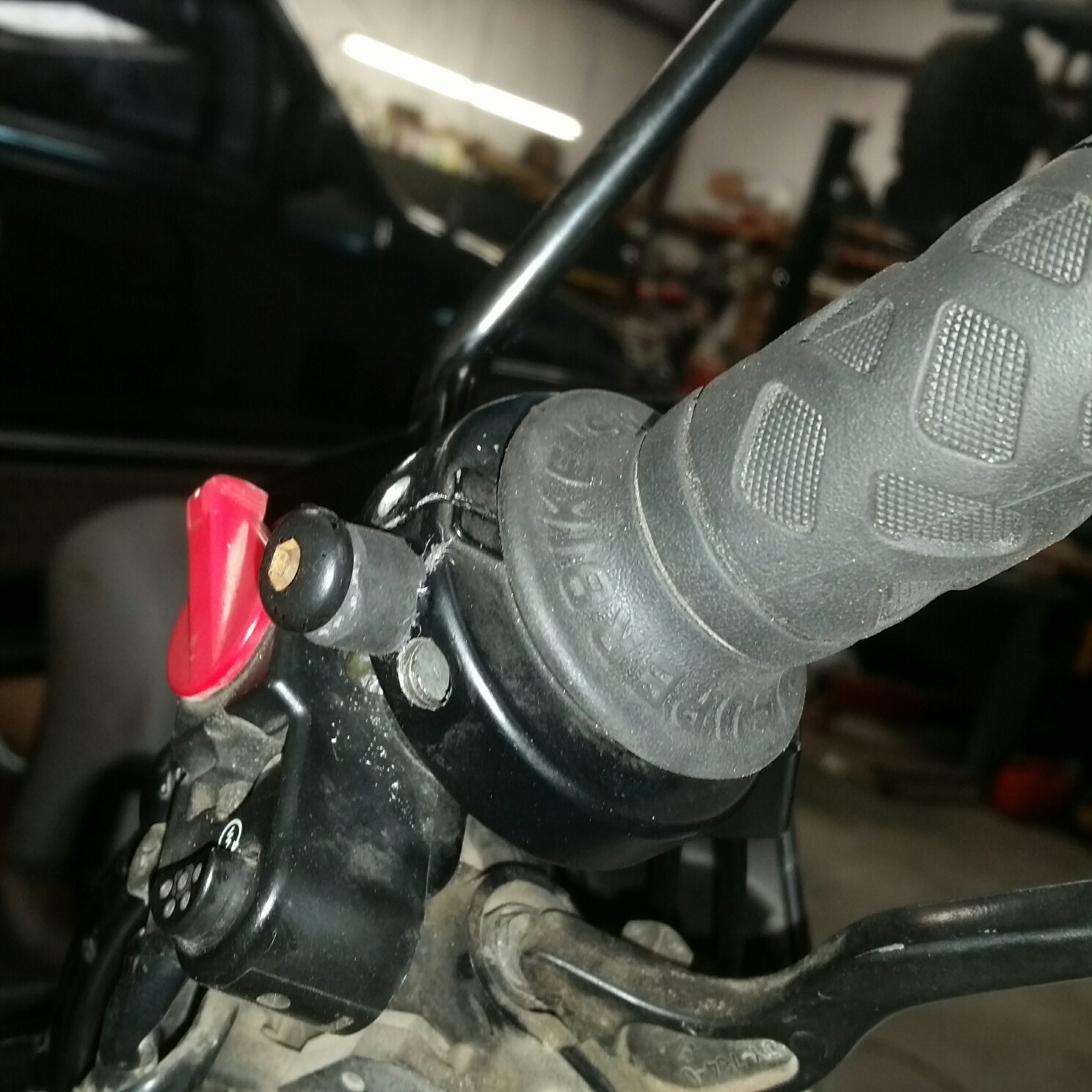

Post by UAofE » Thu Jul 06, 2017 5:55 pm
I use the choke lever on my bike's handlebar to pull on the main governor arm.

Post by coachgeo » Sun Aug 20, 2017 4:51 am
Installed tank and put fuel in. STUPID ME lol. Discovered should have done this later.
Went to prime the system.... ooops.. the Fuel Shut off solenoid needs power to let fuel by. grrrr... so it is an always closed solenoid.
Dug thru wiring diagrams and conversed with folk on a KLR board and deciphered where to get a switched hot. Got lazy and used a new version of the clamp over wire thingamabobber.
(Dorman T-Tap https://www.youtube.com/watch?v=ikZZBmvFEho ) Will seal it well with electrical silicone and tie it off to adjacent items so it does not wiggle and cause breaks/shorts. These clamp on things are known to create weak points so I want to keep it more affixed. Wanted to get an adapter (one female spade to two male spades) to jump off a nearby in-use male spade.... but of course no one had any. Put a wire loom around the Injector overflow line and ran the wire thru loom as well, back to the to the Solenoid which sits on the Injection Pump (Jack Pump) just prior to the Injector line. Planned this idea to keep the wire from flopping around near exhaust and hot engine.
Was a bit of a PITA with the tank on but think I managed. About this point ... working in front yard and Night was falling as well as mosquito varmints attacking decided to save test and hopefully bleed air for another day.
Covered bike again... supposed to rain off and on all week. SO TIRED OF RAIN. A tree fell in back yard other day. Ground too wet to support the old rotten (partially cut down) tree. Just missed the Spare Tiger.
Posts: 2002
Re: Diesel KLR 650 running video
Post by coachgeo » Mon Sep 04, 2017 7:30 pm
grrrr...... looks like the fuel solenoid in the IP is bad. NO FUEL. Solenoid is powered.
